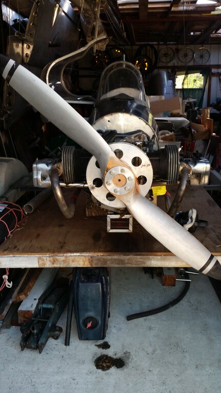

I know of it being used on a nitro aircooled speed attempt and steam was used.  It's a pretty rare situation where that would  need to be used. High specific horsepower / Litre. The Jabiru is well inside the power density aircooled engine practical ceiling of around 50 HP/litre. The Jab lacks the controlled airflow around the cylinder fins that most other similar aero engines almost universally use (Baffles and ducting shields). They are not hard to fit and don't run it for long with the cowl off. Nev

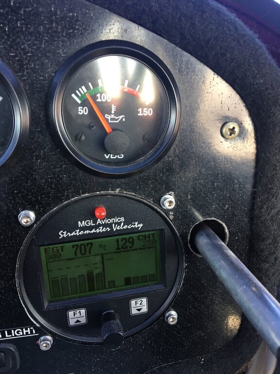

Looking back at post No 1 Is see the max temp was 161 degrees.
My Jab manual recommends a max of 170 deg or 150 continuous, so there is no real problem.
This above statement is the best advice you can get. All air-cooled engines should have tight-fitting, effective baffling and ducting, to ensure the airflow is getting to the fins, where it's most needed.

But as a tinkerer, trying to get those CHT's all the same is quite a challenge, and the LHS ones do run hotter than I like. On a warm day, 34C for example, with 2 people on board, the climb is a lot slower than I would like it to be, on account of the need to keep the max temp below 170C.

To keep things in perspective, a Lancair I know well has a max temp of 190C, and it often runs over 170. But the Jabiru heads on the old engines like mine  were made from quite soft alloy and I reckon I've seen one which distorted without the pilots being aware that they were overheating it.
Part of the blame for this lies with the original CHT gauge which was a thermocouple with its cold junction under the cowl. It under-read on hot days for sure.

Spacey, if you fitted cowlings that wrapped around the rear of the cylinder and heads and which directed cooling air to the rear of the cylinders and heads, you'd find your engine cooling would improve.
This has worked for me.  Move the oil cooler to the rear of the engine and duct air to it via a side naca duct (like carby inlet), reduce the size of the lower air intake that was previously there for the engine mounted oil cooler, built a close fitting duct from this reduced inlet to the sump. Max CHT less than 140 on the ground which quickly reduces to 110 for climb at 80 knots (700-1000 fpm), cruise CHT at 100 knots 105 degrees C.  I had a similar setup on my Corby Starlet and replicated it on the Jabiru. No need for cowl skirt or big mods to inlets.  I did add a bit to the cooling ducts to prevent air from going under the front cylinders.
