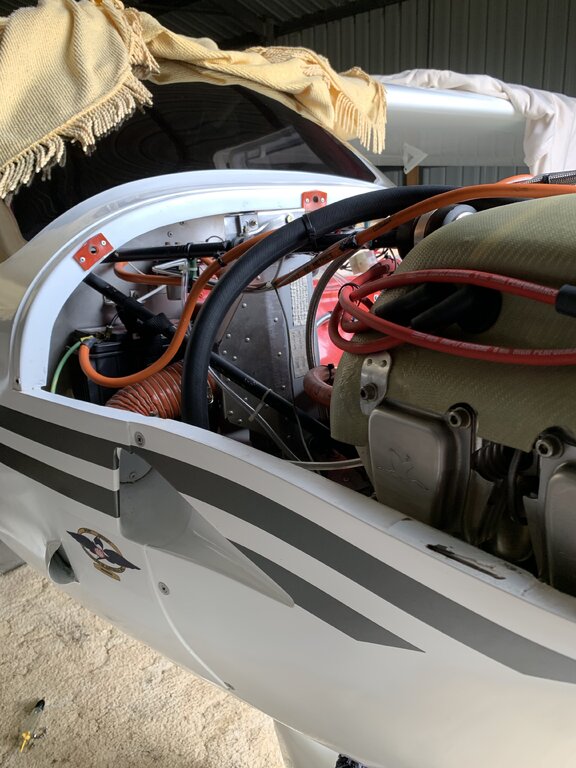

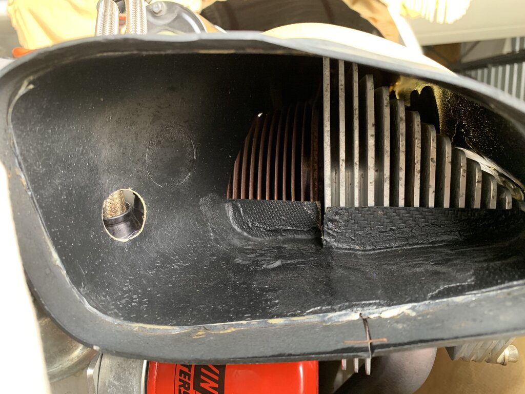

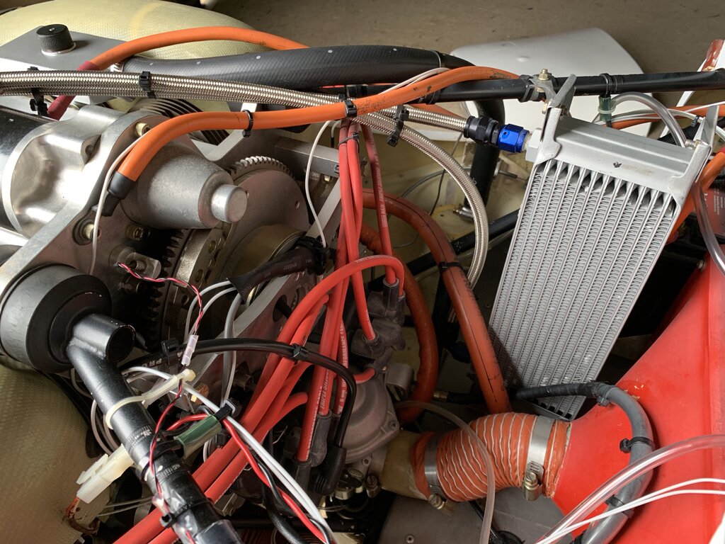

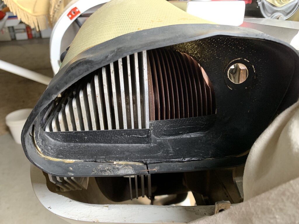

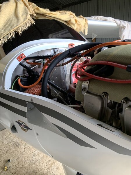

Keenaviator Posted December 14, 2019 Share Posted December 14, 2019 Here are a few photos of my under cowls set up. I'll get photos of the sump cooling duct later... 1 Link to comment Share on other sites More sharing options...

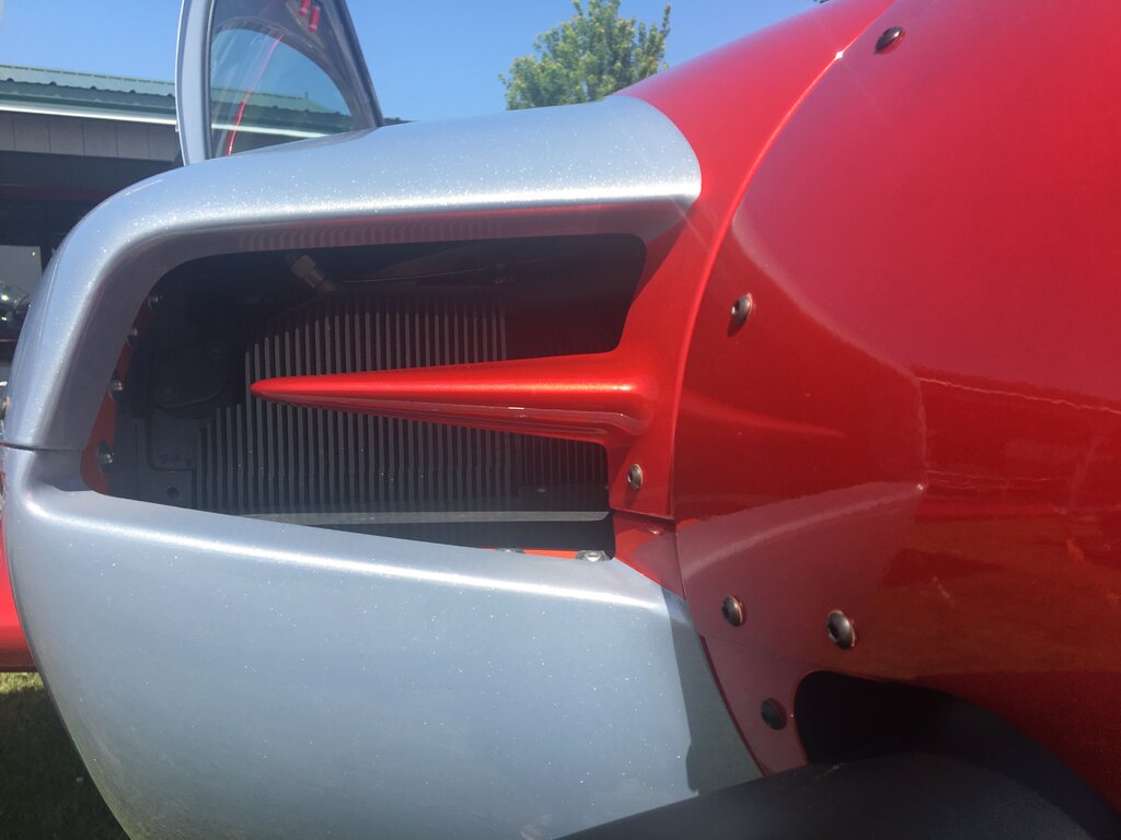

Paul davenport Posted December 15, 2019 Share Posted December 15, 2019 Spotted this unusual cooling mod done to a (I think) Extra aerobatic aircraft, at Oshkosh had something todo with cooling but couldn’t find someone to explain it Link to comment Share on other sites More sharing options...
