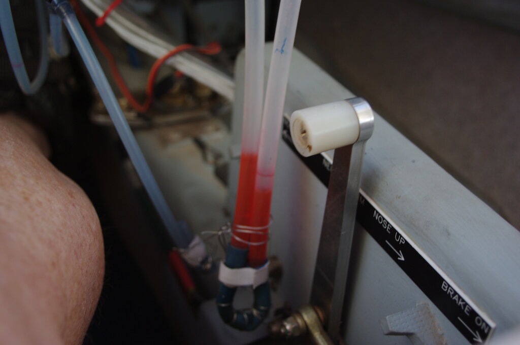

Bruce Tuncks Posted December 16, 2019 Author Share Posted December 16, 2019 Flying down to the farm, with the manometer between the 2 ducts still in place, along with the vacuum-hose joiner, there was a difference of 20mm pressure between the cooler RHS and the warmer LHS. Here's what is next in line.... 1. Improve the baffles on the hot side as Yenn suggested. It already has a smallish "A" baffle between the cylinders, pulled up against the underside of the fins with a spring setup. I can use this on the top and put a larger thing on the bottom. 2. Sharpen the fins as Nev suggested. This idea was new to me but I like it. 3. Enlarge the diameter of the connecting hose and make it smoother . There must be a big reason why the RHS has more pressure than the left, but I'm at a loss to know why after the failure of the deflector which was going to improve things but instead made things worse. Ducting air to the oil-cooler as keenaviator suggests is also a good idea but it has already been done, in that the lower-cowl inlet has been blocked and the smaller amount of air admitted there goes only through the oil-cooler. Cowl-flaps are another idea, they could consist of skirt sections which could be retracted. But quite complex to construct and then live with. The temperature difference with the LHS hotter than the right does seem to be caused by the pressure difference, but I'm starting to doubt that common-sense prevails here. The term "dark art" comes to mind. Thanks guys for the comments and ideas. I'll do those 3 things and tell you what happens. Link to comment Share on other sites More sharing options...

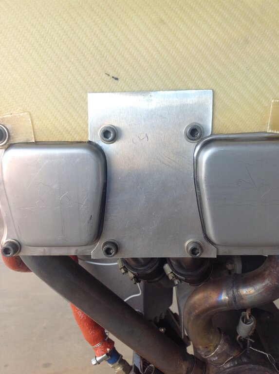

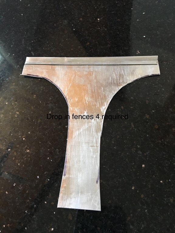

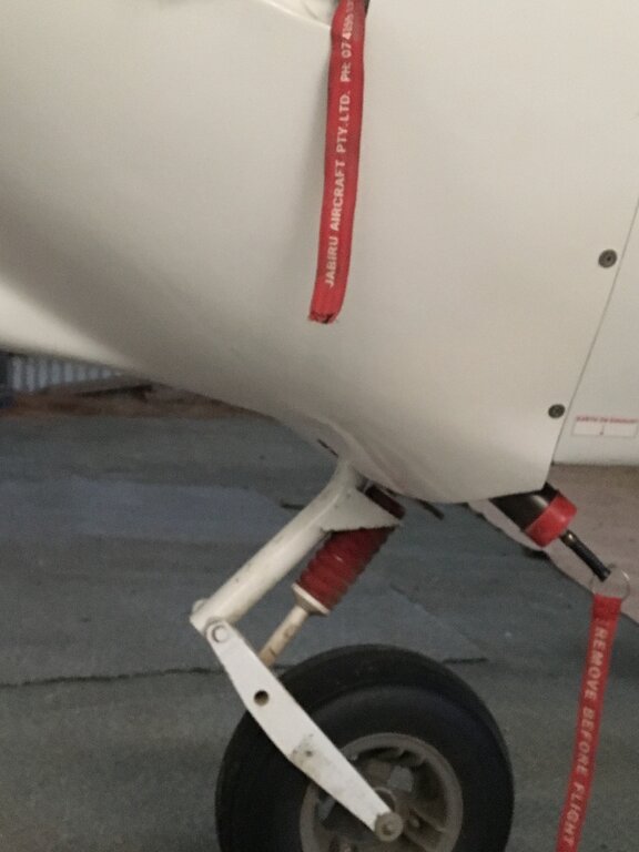

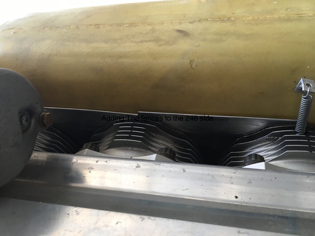

Paul davenport Posted December 17, 2019 Share Posted December 17, 2019 Pictures of my drop in cylinder baffles. Last picture is of my cowl lip 4 Link to comment Share on other sites More sharing options...

Paul davenport Posted December 17, 2019 Share Posted December 17, 2019 I have done the same to the heads but cannot find pictures. Link to comment Share on other sites More sharing options...

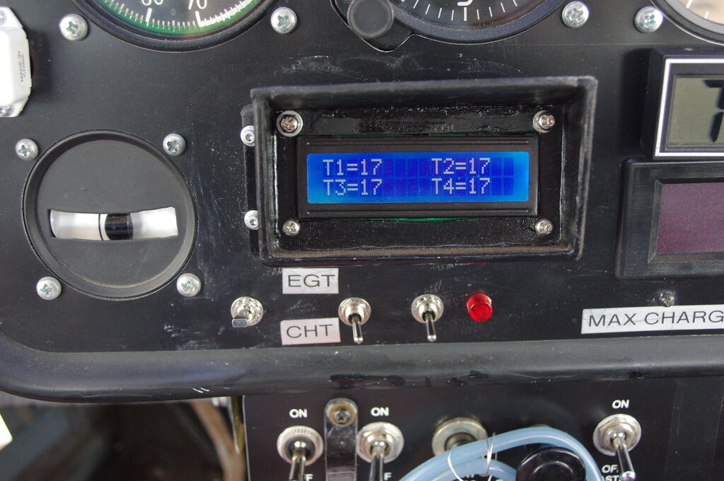

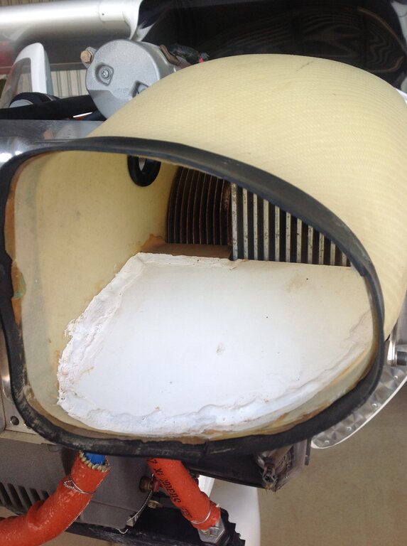

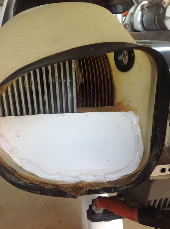

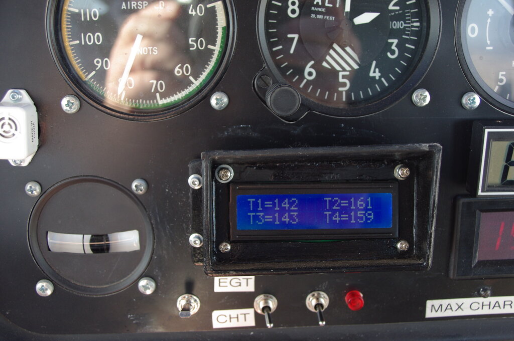

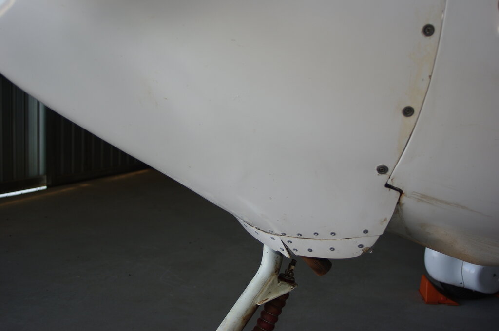

Bruce Tuncks Posted December 24, 2019 Author Share Posted December 24, 2019 We had some terrible weather here lately, with 46 degrees a few days ago, just short of the record. So not much flying and I tried to do 3 things: Firstly, add a skirt to the lower cowl exit lip ; secondly, make and fit some bigger " gull wing " deflectors to the LHS duct ; thirdly, to sharpen the fins on the no 4 cylinder. Sharpening the fins was harder than I thought it would be, and it will need to wait till I get the right bit for the Dremel to finish the job properly. Not very scientific to do more than one thing at a time I know. This morning ( ambient 19 C ) it was test-flown, and there was a definite improvement. Pic 1 is before starting up, the engine was still cool from the night. I reckon this tests the senders, well at least at ambient. Pic 2 is the manometer between the ducts, taken on climb. The RHS is still higher pressure and the joining duct is obviously at work. That's about 1 cm pressure difference, which is less than before and I think the gull wing baffles must be the reason. Pic 3 is the climb temps. They are more even than before, and I reckon it was easier to cool down 2 and 4 with step climbing. Mind you, this needs checking out on a 30 degree day. Pic 4 is the skirt. Unfinished at the moment, but I think it helped a lot. It must slow the plane down a bit, but I couldn't notice the difference. Thanks guys for the good advice. As you can see, I have implemented quite a few of your ideas. 1 Link to comment Share on other sites More sharing options...
Jabiru7252 Posted December 24, 2019 Share Posted December 24, 2019 wow - that's a fine looking digital temperature meter. ? Don't slice yourself open on the sharp fins....? Link to comment Share on other sites More sharing options...
Paul davenport Posted December 24, 2019 Share Posted December 24, 2019 Thanks for the update. I had ordered my dremel grinding burs some days ago and will use them with the routing attachment to achieve the taper I want . Do you think we could have some pictures of under the cowl and of the fin mod. Do you think the fin mod was responsible for very much of your cooling success ? Link to comment Share on other sites More sharing options...
Bruce Tuncks Posted December 24, 2019 Author Share Posted December 24, 2019 Yep, all this stuff was only possible with that digital temperature meter... Thanks Jab 7252. For years, my plane operated with just one CHT operating from a ring terminal under no4 spark plug, with a moving-coil VDO display, and the cold thermocouple junction in front of the firewall. Wish I knew what temperatures it really got to then. Link to comment Share on other sites More sharing options...
jetjr Posted December 24, 2019 Share Posted December 24, 2019 Jabiru sell lower cowl pieces to modify cowl theres an old sb about it Link to comment Share on other sites More sharing options...

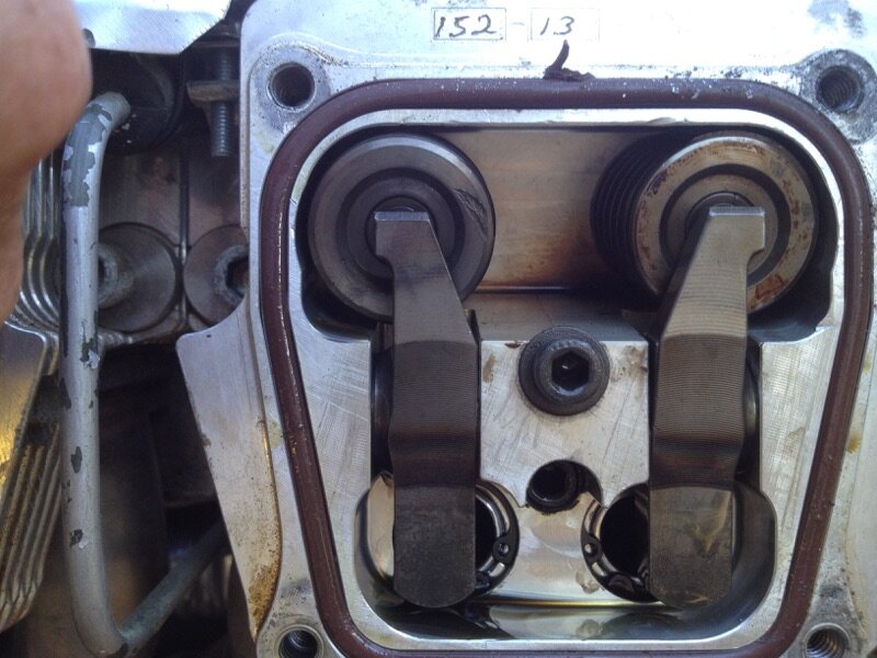

Old Koreelah Posted December 25, 2019 Share Posted December 25, 2019 ...Wish I knew what temperatures it really got to then. Remove your tappet covers and the colour of the head metal will give you a fair idea; someone on here posted the temperature required to "cook" the oil, so I guess the colour of oil baked onto the metal might be a rough guide. 1 Link to comment Share on other sites More sharing options...

Bruce Tuncks Posted December 25, 2019 Author Share Posted December 25, 2019 Thanks jetjr, yes I did that sb years ago. They supplied a moulding which replaced part of the front lower cowl leaving more room for the oil cooler and actually lowering the drag. And for the fin-shaping job, I agree that mounted stone type dremel tools would be no good, and it will need a side-cutting carbide burr of some sort. A small file will do the job, but gosh its slow and hard work. It is intuitively obvious that airflow down the bottom of the fins will be improved, and I hope to be able to report at least 2 degrees more cooling. Link to comment Share on other sites More sharing options...
