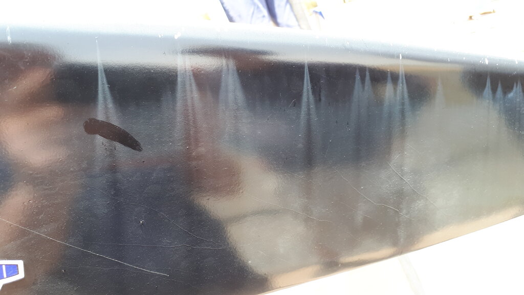

Thruster88 Posted January 10, 2020 Share Posted January 10, 2020 We flew to a job today in the bosses beautiful cessna 180, about two hours in light smoke. Picture shows the prop blade out near the tip, even a tiny nick in the paint caused these trails to form. It is interesting to me how the turbulence or whatever is happening fanned out so much. Anyone got an explanation? 3 Link to comment Share on other sites More sharing options...
facthunter Posted January 10, 2020 Share Posted January 10, 2020 The "nicks" affect the boundary layer airflow. The separation gets greater as the flow gets further from the leading edge. Probably tar in the smoke leaves the trails. It will come off with a bit of eucalyptus oil. Nev 2 Link to comment Share on other sites More sharing options...

Bruce Tuncks Posted January 13, 2020 Share Posted January 13, 2020 The boundary layer at the leading edge is very thin and a tiny protrusion can trip the laminar flow into turbulent flow. The turbulent flow spreads and it makes those tracks. There is quite an effect on performance, since turbulent flow is about ten times the drag of laminar flow. 1 Link to comment Share on other sites More sharing options...
Old Koreelah Posted January 13, 2020 Share Posted January 13, 2020 The boundary layer at the leading edge is very thin and a tiny protrusion can trip the laminar flow into turbulent flow. The turbulent flow spreads and it makes those tracks. There is quite an effect on performance, since turbulent flow is about ten times the drag of laminar flow. So I guess we should try to keep our props glassy smooth like sailplane wings. 1 Link to comment Share on other sites More sharing options...

Bruce Tuncks Posted January 14, 2020 Share Posted January 14, 2020 All wings ( and a propeller is a rotating wing) are laminar flow at the start. The so-called laminar flow airfoils are designed to have more laminar flow than the others. As Facthunter alludes to, laminar flow has the bad characteristic of separating from the surface and making the drag worse than ever. So some airfoils work with turbulators which deliberately trip the laminar flow into turbulent flow. If you put on the turbulator too far forward, you give away a bit of low-drag area and if you put it too far back, into the separated flow part, then it does nothing. You can refer to experts and get conflicting opinions, or you can do a lot of expensive testing. Once, when I was young and silly, I tried to find if turbulators could improve a Mosquito flapped glider. The test-rig consisted of an under-wing set of pitots sited at the trailing edge and connected to an ASI via a plenum chamber. The theory is that the lower the airspeed measured by this "wake rake" then the higher the drag. Then each flight, you can try a new turbulator stuck on in front of the wake rake. I never found any worthwhile improvement and most of the time the turbulator made things worse. Now that I'm old and silly, I am wondering about turbulating a Libelle. Link to comment Share on other sites More sharing options...
