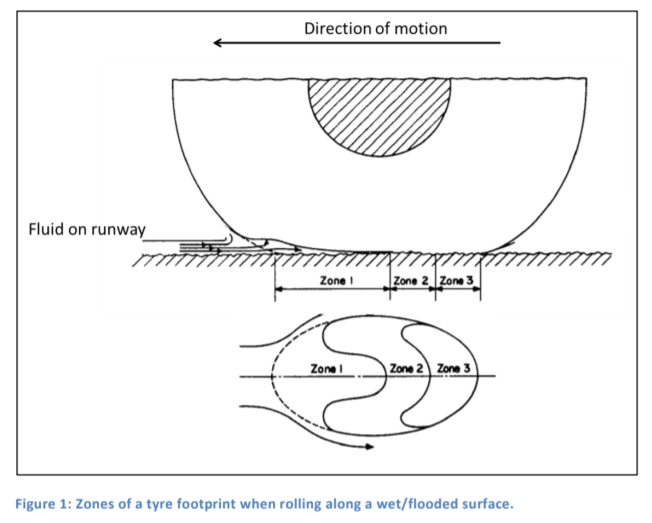

facthunter Posted January 11, 2020 Share Posted January 11, 2020 Tyre pressure and speed are the main factors. You also avoid "squeeker" landings and aim to plant it a bit firmer to prevent rubber reversion by superheated steam that just shaves off rubber very quickly even though you have no brakes on. You also need things like chined tyres on the nosewheel to keep water out of the engines .Nev 1 Link to comment Share on other sites More sharing options...

saccani Posted January 11, 2020 Share Posted January 11, 2020 Tyre pressure and speed are the main factors. You also avoid "squeeker" landings and aim to plant it a bit firmer to prevent rubber reversion by superheated steam that just shaves off rubber very quickly even though you have no brakes on. You also need things like chined tyres on the nosewheel to keep water out of the engines .Nev I don’t think you can get rubber reversion with dynamic hydroplaning, you need to lock the wheels to get rubber reversion hydroplaning - otherwise the necessary friction simply rotates the wheel. This is most commonly encountered when an aircraft is in dynamic hydroplane, ABS braking is ineffective and the parking/emergency brake is applied to manage a perceived service brake failure. You can see that it has happened by the steam cleaned wheel tracks on the runway as well as the chewed up tyres. Usually a secondary effect of locking the brakes is retraction of lift dumpers, after some type specific delay. So the sequence may be of heating the tyres first, retracting the lift dumpers and then continuing with locked wheels and less water displacement. Link to comment Share on other sites More sharing options...
facthunter Posted January 12, 2020 Share Posted January 12, 2020 Sorry Sacc That is definitely NOT so. While it seems unlikely, the wheels often rotate slowly backwards while the superheated steam is being produced, but most times it just removes heaps of rubber with a characteristic appearance so it's easy to identify. Without ABS you are going get tires blowing pretty often. It's a must have but without wheel spin up it's not working. Nev 1 Link to comment Share on other sites More sharing options...

saccani Posted January 12, 2020 Share Posted January 12, 2020 Sorry Sacc That is definitely NOT so. While it seems unlikely, the wheels often rotate slowly backwards while the superheated steam is being produced, but most times it just removes heaps of rubber with a characteristic appearance so it's easy to identify. Without ABS you are going get tires blowing pretty often. It's a must have but without wheel spin up it's not working. Nev I'll let someone else say it; "Reverted-rubber aquaplaning. This occurs when a wheel 'locks up' (or stops rotating) [emphasis added] and is dragged across a wet surface, generating steam. The steam pressure lifts the tyre off the runway surface. Heat from the steam causes the rubber to revert to its unvulcanised state, leaving a black, gummy deposit of reverted rubber on the tyre. Reverted-rubber aquaplaning will also typically leave distinctive marks on the runway, with black marks on the edge of the contact patch and a clean section in the middle where the runway has effectively been steam cleaned. This type of aquaplaning can occur at any speed above about 20 knots and results in friction levels equivalent to an icy runway." - ATSB So I guess I'm not alone in my wacky ideas. Also take a look at page 16 on in this study; ntrs.nasa.gov/archive/nasa/casi.ntrs.nasa.gov/19680010151.pdf . I'm willing to be convinced of your thesis - do you have data to support your thesis? I'm not sure I understand your comments about ABS, discussion of the F100 system may shed light. In the Fokker 100, there are three modes of anti-skid operation; Touch down protection: All six pressure valves remain in the dump position until seven seconds after the ground/flight mode changes to ground mode, or any wheel reaches 20/40 mph (20 or 40 mph depends on mod status). You could apply full brake when landing and the wheels would have no braking applied. Lift dumpers (if available) should normally be manually deployed on wet runway, but ground mode is needed. Approx. 80 knots wheel rotation is also needed for auto deploy. Typically 7 seconds after touch down on a contaminated runway, 3 to 5 seconds after mode change before the brake pressure dump valves are released. Skid detector: Kicks in at 12 mph wheel rotation speed. Each wheel has deceleration monitored and excessive deceleration causes pressure release on that wheel to keep it from exceeding the skid threshold. Locked wheel prevention: Above 20 mph wheel speed, locked wheel circuits are in stand-by. If an outboard (inboard) wheel speed is 30% below the opposite outboard (inboard) wheel speed, a full pressure dump is applied to the wheel. This system is inhibited below 20 mph. In the F100, dependant on the ground/flight controller fitted, a guarded anti-skid off switch is on the pedestal next to the FO pitch trim wheel, allowing anti-skid disablement. The parking brake is not an emergency brake in the F100, it serves to retain applied brake pressure. Instead an alternate brake system will operate without pilot intervention if the primary brake system on that side fails. This isn't obvious except by the annunciator, almost full capability is retained, but each side is treated as one unit for anti-skid, instead of each wheel. I can see no reason to have tyres blowing fairly often with anti-skid inoperative. In this system, the anti-skid system allows brake application without wheel rotation. Locked wheel protection doesn't operate if both outboard (inboard) wheels are turning or not turning within 30% of each other - as may be the case with extreme hydroplaning. Application of brakes on touch down with aquaplaning can result in locked wheels from seven seconds after ground/flight enters ground mode until the aircraft stops. As in, it is possible, particularly if auto deploy is selected on lift dumpers, as they may fail to reach the 80 knot deploy threshold, before the brakes are applied, preventing it from happening. One reason why lift dumpers should be at manual for a wet runway. With regard to the "characteristic appearance", all my knowledge and experience says that is of an area of reverted-rubber corresponding to the contact patch of a locked wheel. I've never seen any data to support rotation of the wheel in reverted-rubber hydroplaning (let alone backward) and it is contrary to my experience in investigating such matters. What may sometimes occur is a patchy series of contaminations, causing multiple areas of reverted rubber, as the wheel spins and then locks again - this may perhaps give some the impression of rotation, but these are separate cases. But, as I say, I'm open to being convinced otherwise - though my previous experience and training says it is not so. Here is Michelin aircraft tyres take on hydroplaning; "10.3.4. Dynamic Hydroplaning is a high speed phenomenon which occurs on any surface and requires a minimum fluid thickness. 10.3.4.1. Considering the various fluids reasonably encountered by aircraft tires, slush is the most likely to cause dynamic hydroplaning. It is less dense than water, but is deeper due to its viscosity. Slush, along with snow or ice, deserves particular attention. 10.3.5. Viscous Hydroplaning results when a thin film of fluid (water) on the runway becomes a lubricant. It may mix with the contaminants present or the water alone may be sufficient if the surface texture of the runway is smooth as on a painted portion of the runway markings. Generally the irregular condition of the runway surface is sufficient to break up this film. 10.3.6. An aircraft tire experiencing hydroplaning may form an area of tread rubber reversion or skid burn in the tread due to lack of wheel rotation [emphasis added]. This area will be oval in shape similar to a flat spot. If the reinforcing ply (bias) or protector ply (radial) is not exposed the tire can be left in service. If any vibration resulting from the flat spot is acceptable, the tire can be left in service. NOTE: The most effective method to minimize the effects of water on traction is to reduce the water depth. Many airport runways are cross-grooved to improve water drainage." Kind regards, Paul 3 Link to comment Share on other sites More sharing options...
facthunter Posted January 12, 2020 Share Posted January 12, 2020 Re re slow turning in a rearwards direction, I've personally seen imagery of it in training material Part of my training with one of Australia's biggest airlines at the time, and when these things were done comprehensively. The wheel is certainly NOT locked as it CLEARLY rotates slowly backwards .Grip on the runway...... obviously has none due to the lack of adhesion. due steam and water. The hot steam acts at the front of the wheel where the water is coming from. Blown tyres without antiskid working.? Almost UN preventable on heavy aircraft unless you hardly brake at all and can happen in dry and normal conditions. It's a known accepted and recommended technique to land "positively" to prevent flat spotting on "wet " runways (achieve wheel spin up) in low adhesion situations. You don't try for a "greasy" landing . The grooving of the runways that eventually happened after a lot of pressure was applied to the government were along the runway not across it at Sydney on rwy 16. where I had personal experience of "severe" aqua planing for at least 1/2 km before any wheel achieved ANY grip at all and could not use reverse thrust as it would have cancelled out the rudder effect which was all I had to keep the aircraft in the centre of the runway.. AS far as the wheels were concerned It might as well have been "black Ice". Absolutely NO grip at all. Better adhesion is obtained as you slow down in an aquaplaning situation.. Speed, water depth and tyre pressure are considered factors and I guess tread depth as well. Nev 1 Link to comment Share on other sites More sharing options...
saccani Posted January 14, 2020 Share Posted January 14, 2020 Re re slow turning in a rearwards direction, I've personally seen imagery of it in training material Part of my training with one of Australia's biggest airlines at the time, and when these things were done comprehensively. The wheel is certainly NOT locked as it CLEARLY rotates slowly backwards .Grip on the runway...... obviously has none due to the lack of adhesion. due steam and water. The hot steam acts at the front of the wheel where the water is coming from. Blown tyres without antiskid working.? Almost UN preventable on heavy aircraft unless you hardly brake at all and can happen in dry and normal conditions. It's a known accepted and recommended technique to land "positively" to prevent flat spotting on "wet " runways (achieve wheel spin up) in low adhesion situations. You don't try for a "greasy" landing . The grooving of the runways that eventually happened after a lot of pressure was applied to the government were along the runway not across it at Sydney on rwy 16. where I had personal experience of "severe" aqua planing for at least 1/2 km before any wheel achieved ANY grip at all and could not use reverse thrust as it would have cancelled out the rudder effect which was all I had to keep the aircraft in the centre of the runway.. AS far as the wheels were concerned It might as well have been "black Ice". Absolutely NO grip at all. Better adhesion is obtained as you slow down in an aquaplaning situation.. Speed, water depth and tyre pressure are considered factors and I guess tread depth as well. Nev I don't know what you saw in training material and I certainly have absolutely no doubts about your sincerity, integrity, skills and professionalism. But you've given me nothing I can examine and I do need something a bit more to go on. I have seen some films of hydroplaning tests that may give that impression due to camera synchronisation artifacts. Tyres I have examined after rubber-reversion hydroplaning have mostly had single contact patch areas of rubber-reversion, in one case they had several, representing multiple events with patchy areas of shallow water and the operation of that anti-skid system. I've never seen any damage that would correspond to slow rotation whether forwards or backwards. Hot steam should not be acting at the front of the contact patch where the water is coming from, that's the cooled side. I've seen DFDR showing wheel rotation ceasing at a point corresponding (but not exactly, the data isn't that accurate) to the white marks of rubber-reversion hydroplaning starting. If your training film *told* you that these were the conditions of rubber-reversion hydroplaning, I can only say, your training film was wrong to do so and you should re-evaluate incorporating this material in your personal model of how things work. But give me some reasonable reference to support your position and I'll be happy to do the same. I completely agree with the technique of a firm landing and avoiding a 'greaser', though more for having the maximum stopping distance. Unless you have solid tyres, it shouldn't be making any difference to whether or not you hydroplane in the first place and won't prevent subsequent hydroplaning. I do not accept the existence of rubber-reversion hydroplaning without prolonged wheel lock. With the improvements to anti-skid systems in the early eighties it is hardly ever seen in large transports today, except with emergency locked wheel braking. I still see no reason to expect fairly high rates of blown tyres with hydroplaning large transports and anti-skid inoperative. But I'm guessing now that you had dry runways in mind. Certainly more than with anti-skid, but I'd expect the thermal fuse to do something most times before the tyre blows. I must confess I once hydroplaned a good two and half km in a lightly loaded condition (150 tonnes) - it was very interesting and quite concerning too - nice that I had more than 3 km available. I'd say the use of reversors with regard to rudder effectiveness would be type specific, but I would note that you are not left without directional control with loss of rudder effectiveness, you have differential reverse thrust available and the issue of prohibited n1/n2 blade flutter zones in reverse is best left for maintenance to deal with after you stop. In some large transports, failing to use reversors means you don't have any lift dumping, which is hardly helpful. Yes, speed, water depth and tyre pressure are considered factors, as well as surface texture. Screed surfaces greatly increase the water depth requirement, but are hardly used due to the stone throwing aspects and so on. Grooving does much the same thing, longitudinal is a hell of a lot smoother than crosswise and more durable. The essence of predicting commencement of total dynamic hydroplaning is Horne's formulae. dynamic hydroplane ground speed (knots) = 9 x tyre pressure (PSI)^-1. Load/weight makes no difference - for a typical F100, it's 146 knots. Robert Horne did about twenty years of experimental research on hydroplaning in the NASA, using full size gear on a test sled. In 1963 he thought the (reverted-rubber) cleaned skid phenomenon was due to water under high hydrodynamic pressures scouring the area, but with more research, came to understanding the steam aspect. Due to improved anti-skid systems, you hardly see it today - except with emergency systems that don't have effective anti-skid or defeat anti-skid. What really happens in rubber-reversion hydroplaning? You have up to three zones involved in hydroplaning. In total dynamic hydroplaning, the entire tyre is removed from contact with the underlying surface - the dynamic hydroplaning zone extends from the area of tyre contact with the water and there is neither a viscous hydroplaning zone nor a zone of surface contact (or a bow wave). In hydroplaning, this zone is always present , but its trailing edge moves forward, first being replaced by the viscous zone, then by the contact zone behind the viscous zone. As speed reduces, the contact zone increases in size, displacing both the viscous and dynamic zones until we have full contact again. Also, as speed decreases below total hydroplaning speed, a bow wave is formed as part of the dynamic hydroplaning zone. drawing: Gerad van Es, Netherlands Aerospace Centre. Zone borders change with conditions. Zones 1&2 reduced in R-R planing. In rubber-reversion, the wheel is locked and the area of the contact zone (the third zone) is heated whilst being supplied with water from the viscous zone, which is turned into steam. This can only - repeat - only - occur with the wheel locked. The reverted rubber tends to form a skirt about the water under the contact zone, retaining water to create steam and reducing friction in much the manner of a hovercraft. The steam is towards the rear of the tyres interaction with the water and the surface, not at the front. There just isn't a way to do it with a rotating tyre, forwards or backwards, because the conditions for it no longer exist - at least, in real aircraft so far. Maybe if you take things vastly outside of real world parameters you might be able to heat the whole tyre whilst it slowly moves in a forward rotation. And maybe you can drive it backwards and have the same thing happen. But that's so far beyond scope it isn't worth looking at. Films of total dynamic hydroplaning tests will often appear to show backwards movements as the wheel slows down to a stop (which it will do, if total dynamic conditions remain long enough and no one invents frictionless bearings) - it is due to the shutter synchronisation issue. It's like how you can use a stroboscope on a propellor when calibrating a tacho and have the propellor appear to move backward or stop. It isn't real, it is an illusion. I would like to say something about how to deal with hydroplaning. If a go-around isn't an option, reversers are a good option, provided you can maintain directional control (not prohibited by flight manual) - you can always retract them if you have to, but you can't apply them earlier than you did. But aerodynamic braking works, lift the nose up with lift dumpers to manual if you have them. As a matter of interest, you can usually tell with the combination of DFDR data and the weight and balance, not only if hydroplaning occurred, but what kind of hydroplaning too. Warm regards, Paul 2 Link to comment Share on other sites More sharing options...
