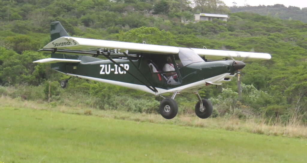

And yet:  https://www.icpaviazione.it/?page_id=1710&lang=en
Seems the factory doesn't have an issue with a tailwheel.
Robert
The photo on their website illustrates my point exactly.
Using the underside of the wing as reference, I measure an angle of attack with the tailwheel on the ground of only 13°, and that's nowhere near the maximum lift coefficient of that wing.
With nosewheel Savannah allows about 19° before the tail contacts the ground.
I'd match a nosewheel version against that taildragger version any time in a takeoff/landing comp.....

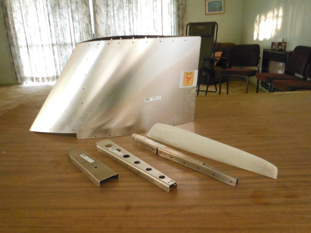

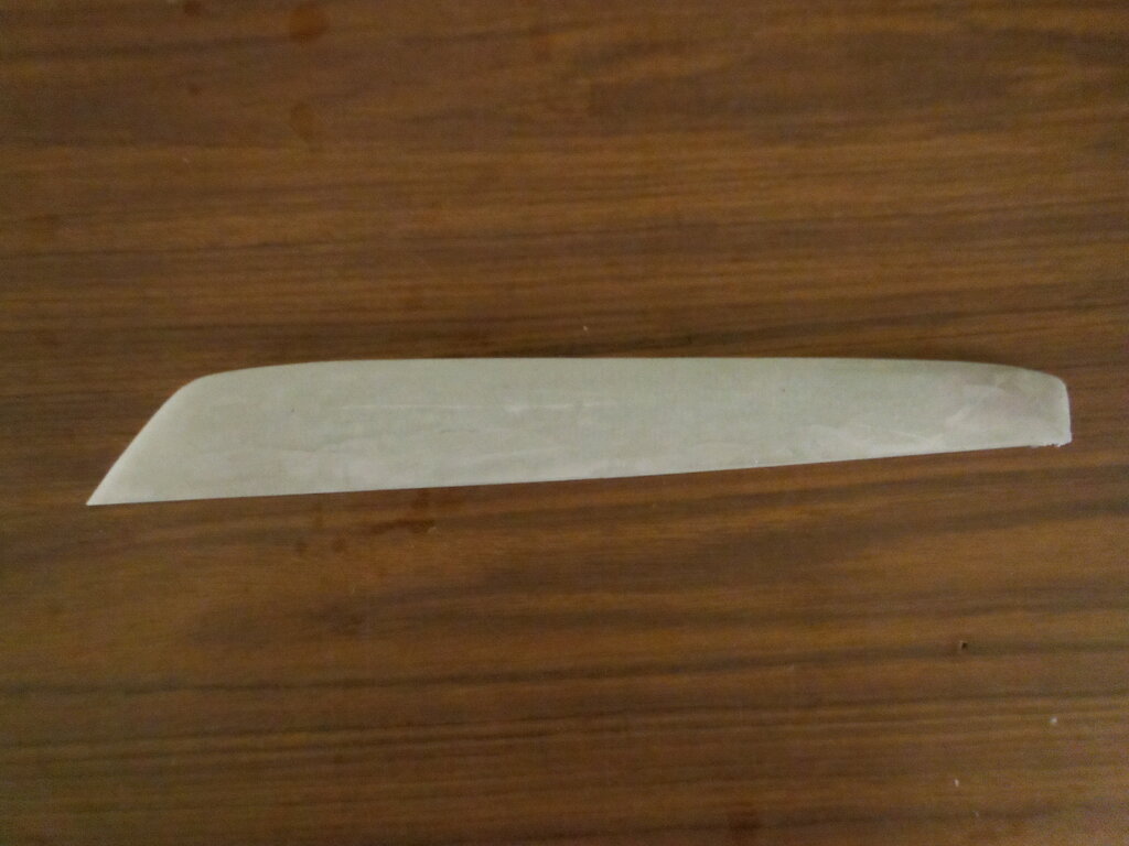

This is the factory supplied parts that I ordered with my kit. Very similar to Reg's Aerokits ones he scratch built for the two he did before ICP took it up for their taildragger. Their heavy fibreglass tip is a bit neater that the fin and rudder cap that Reg initially welded together for the job.
