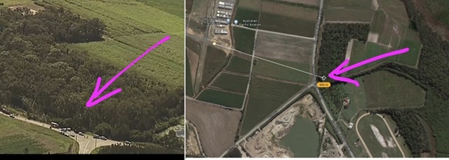

Actual intersection is really close to take off. 5-600m If it was as I’ve indicated with yellow line the plane was unlikely to have been making a right hand turn at virtually ground level. Looks like a take off and power loss and not sure how anybody could have improved on the outcome without a bit of luck.089D941E-AECC-4F04-A887-884CFF8C81D0.jpeg.c6902aa0196e139180650c3db232b150.jpeg

Well, from accident scene on the correct corner (not the news report corner) it looks like the aircraft departed that runway then within 5-600m ditched in. At say 60 knots that’s about 10 or 11 flying seconds.
Unless the departure was a different runway that aircraft flew off the runway and directly ahead only seconds later hit the wiring and trees. It can’t have turned at all.

There is certainty in this case. Even if powerlines weren’t seen they are at tree height next to trees. Also, the multi line is away from trees and likely visible. Additionally this is right near the airport and the pilot would know them well. Unfortunately!

Have a look on google maps. The power line is well away from the strip about 700m. I dont believe the power line is a factor in the crash as the trees appear to be taller.
How many pilots can say from memory what the static rpms are for their aircraft.
The trees are at least 5-6 m higher above the top of the power lines.
The aircraft hit the power lines 1st, and then crashed into the trees. They only hit the pwer lines first because the power lines were 10 m in front of the trees in the direction of travel.
If the power lines had not been there then the aircraft would have smashed into the trees anyway.
If anything the power lines probably slowed the arrival into the trees which was calculated on time and distance using sound as 62 knots.
