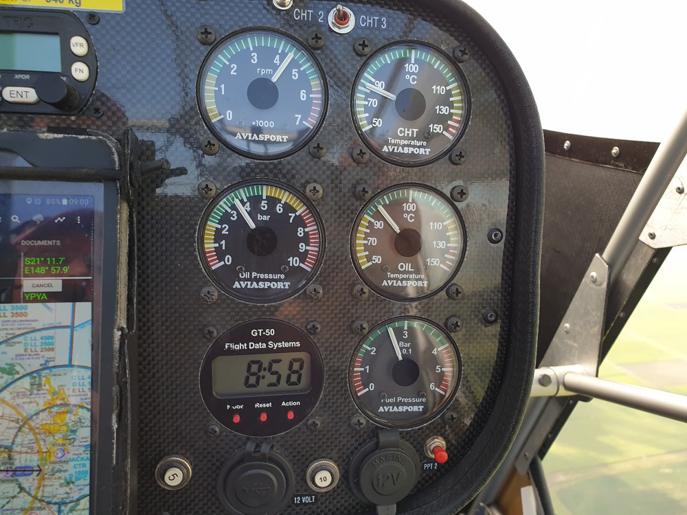

Aviasport are helpful as they blink in the yellow, grabs attention when scanning instruments at any time in flight, being the yellow zone not urgent just needs consideration. One of my beliefs in life is look after engines, treat them well and they should pay you back in kind by giving good reliable operation and less breakdowns. IMHO

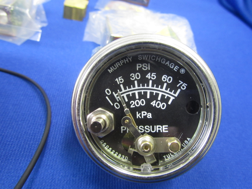

I've never seen a Murphy Swichgage (correct name spelling) fitted to an aircraft - and I can find nothing in Murphy literature, to say they can be fitted to an aircraft.
They're a very durable and well built gauge, with the added complexity of including a switching mechanism which is specifically designed to shut down, unattended ground-equipment engines, when set parameters are exceeded.
However, Murphy state that their Swichgages are built specifically for oilfield equipment, and mobile equipment such as engine-driven welder, compressors, pumps, etc.
Looking through the specifications shows the Murphy Swichgage is an extremely heavy unit, with the 2 inch unit weighing 370 grams and the 2.5 inch unit weighing 413 grams.
In my considered opinion, you are taking on unnecessary aircraft weight by planning to utilise a Murphy Swichgage, when there are plenty of other suitable gauges available, that are designed specifically for aviation use.

My Murphy Guage interest comes from our Army gear 50 years ago, they were in nearly everything.

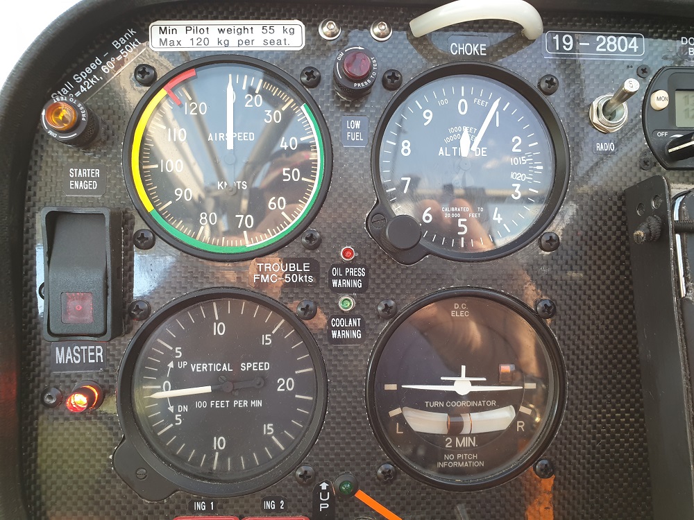

Hi Jack Attached are images of the gauges and the leds and warning lights (Coolant temp, Oil pressure, Low fuel and Started engaged. Could do oil temp and fuel pressure if you like; the but the four I have is ok.) Hope it helps your question.

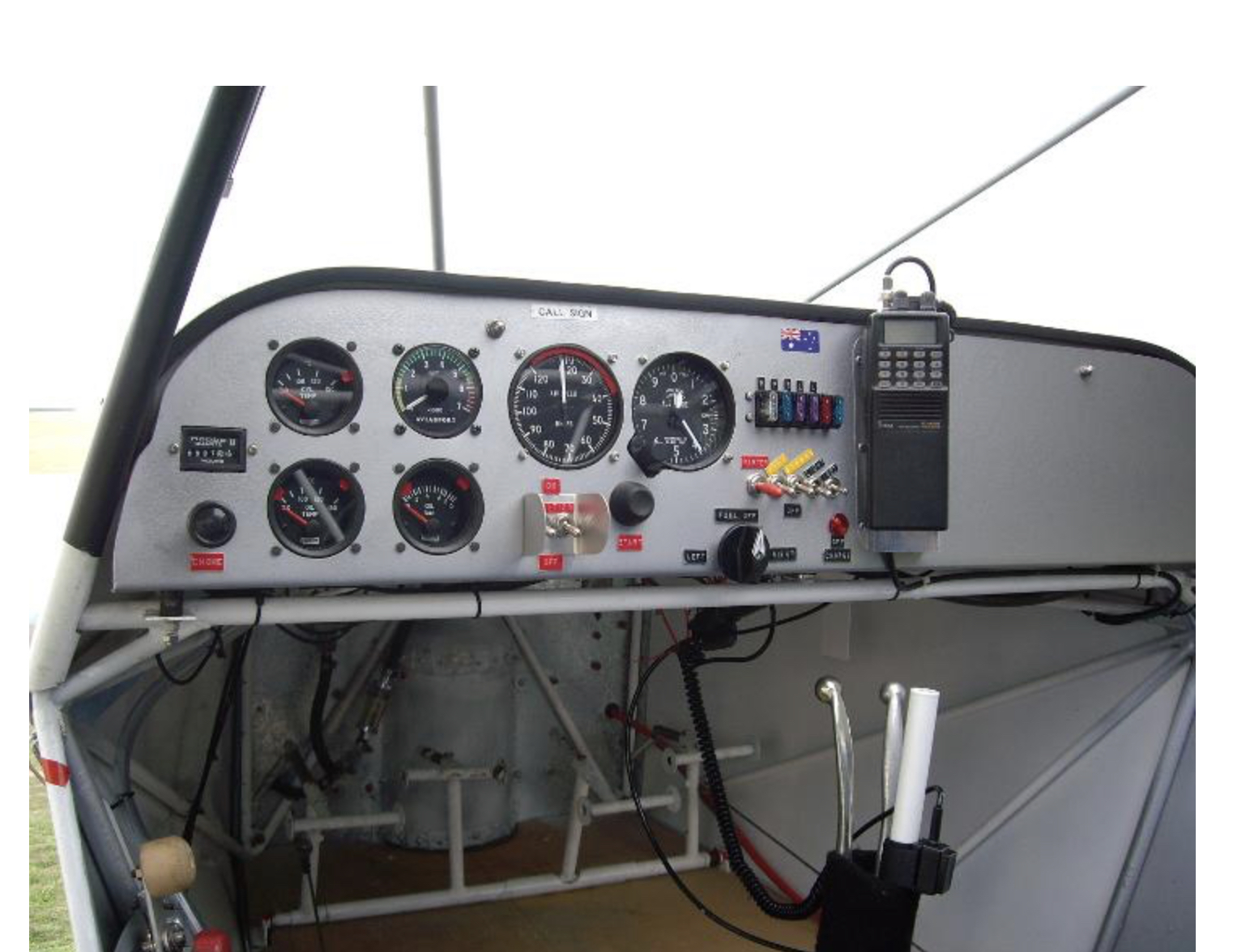

Like it very much, those Aviasport Guages make it and they are marked well. My Aeropup panel is going to need some planning, currently it’s like this.....

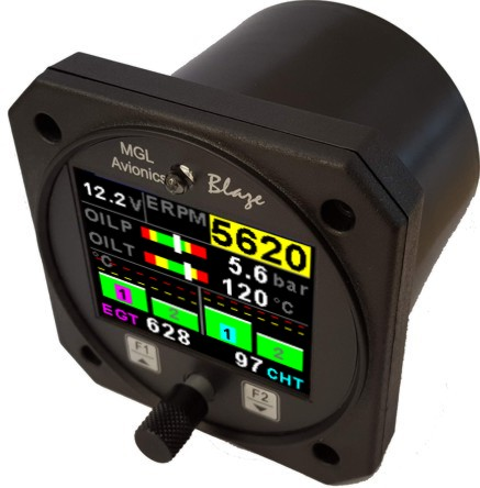

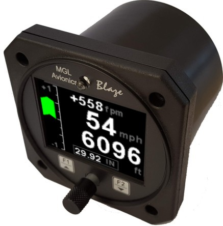

MGL agent in Australia here http://lightflying.com.au/ The Blaze color series here Blaze Color Singles
I use ASV - 2 and EMS - 2. From my experience they are brilliant tools. Asia Pacific Light Flying are really helpful and a great local company to deal with. Great value for money as well. Easily set up with parameter alarms, easy to read in an open cockpit, I love mine. There are heaps of instruments to choose from and accessories as well.

All very nice and with the added cachet of having some reference to aviation in the name (which you will pay handsomely for).
Jackc - I commend your KISS panel - only what you need and no more.

Thanks for comment on panel, just need to update some Guages marked for 912, and that horrible radio, will be GONE:-)

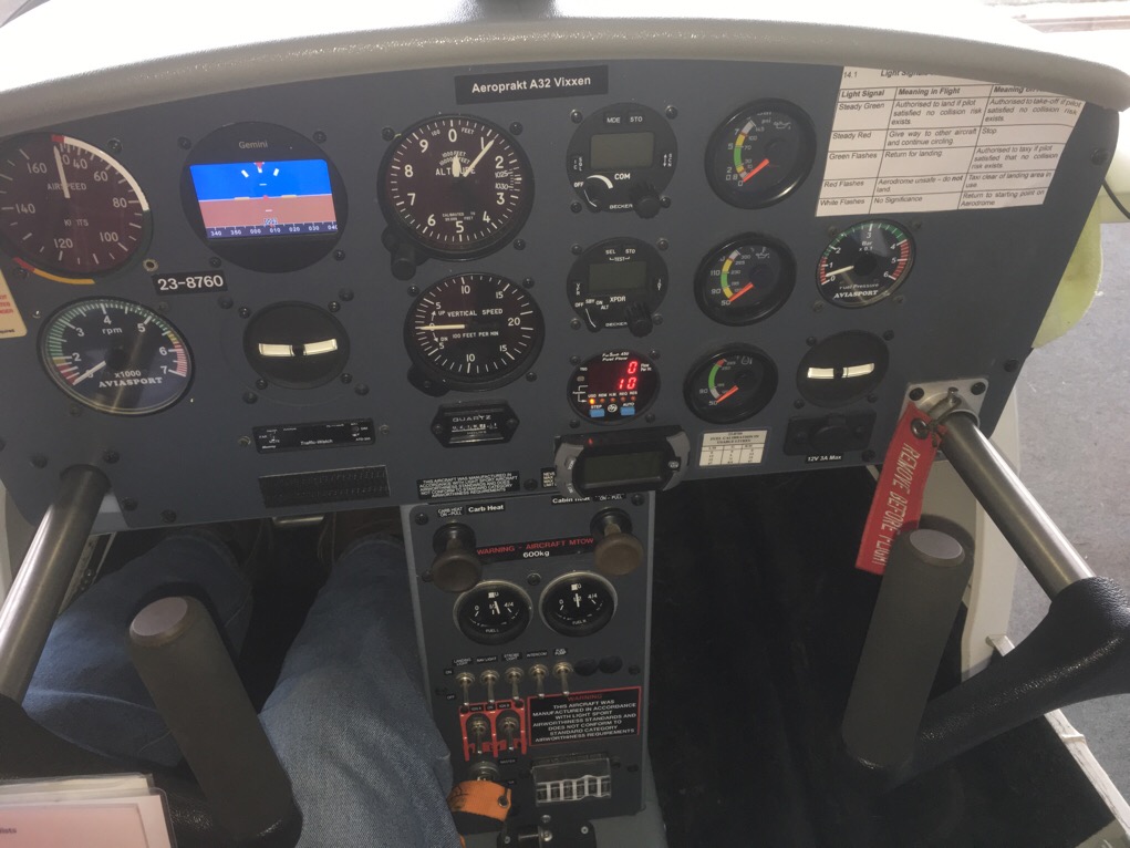

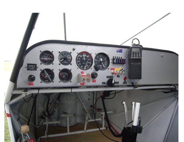

Jackc, Your panel is simple but messy IMHO. ASI, VSI, ALT & Tacho should be right in front of your view so you only need to look down slightly and not sideways to see everything. Comms & nav gear is best in the centre and engine instruments on the right. Switches, fuses & warning lights should be grouped logically. The panels of most Cessnas, Pipers & jabirus are an ergonomic mess.

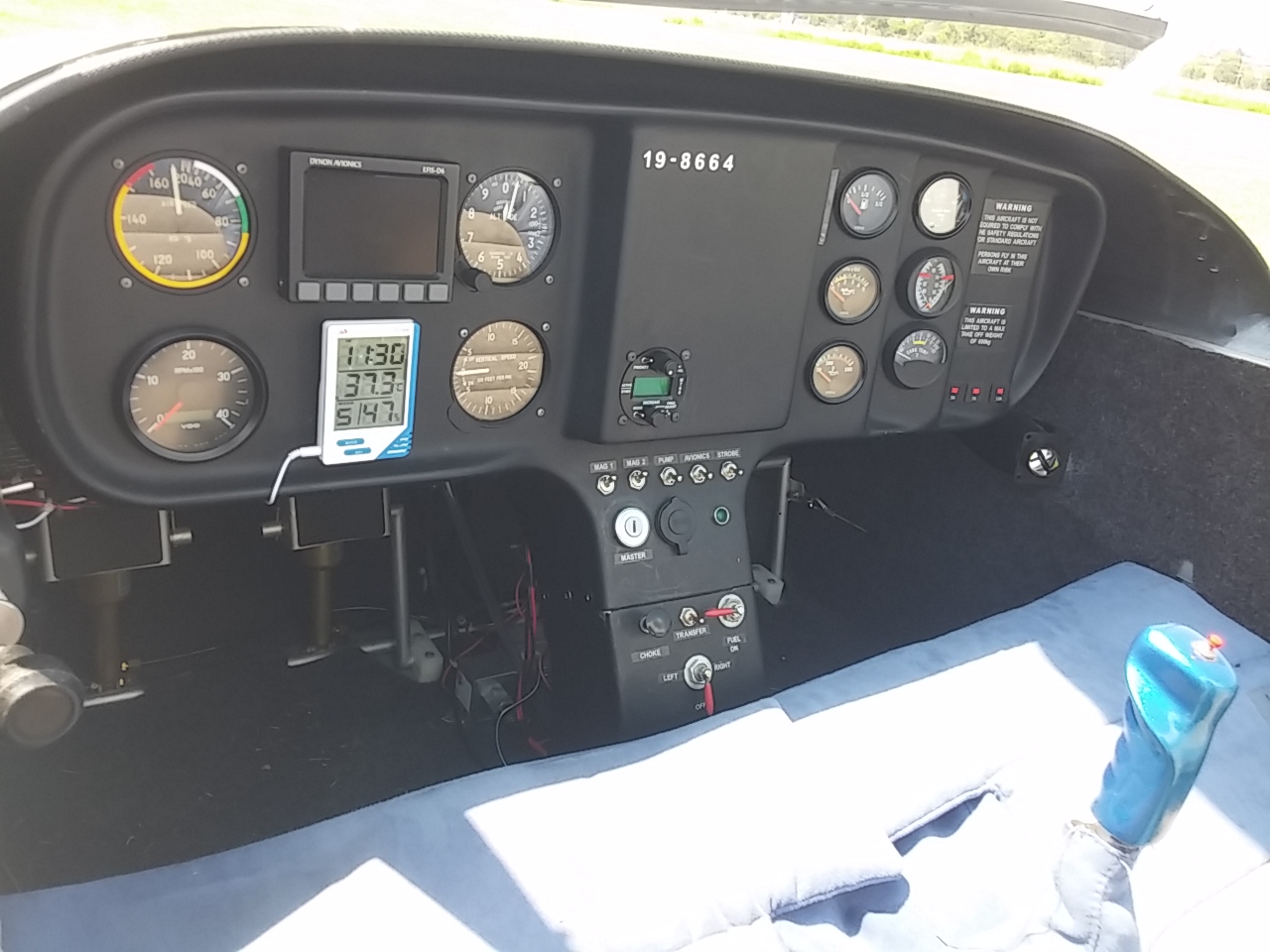

I designed my own panel with everything where I thought it should be and controls requiring the least movement of my hands so Throttle, carb heat, & flap switch are in the same left hand binnacle with centre stick /PTT switch, radio & trim wheel at right, flight instruments directly in front on the left, comms in the centre with all switches below & engine instruments on the right angled towards me. The Dynon duplicates ASI,VSI, ALT & compass, & has AH, Turn & Bank & slip & a voltmeter. The blank space in the middle is for Nav tablet & space next to the radio is for a Xponder. I only have 1 warning light for ign/low voltage next to the power outlet. The digital instrument (velcoed on to the panel) is a clock/alarm/calendar in/out temperature & humidity ($7.50 on Ebay). I have 3 fuel tanks(centre main & 2 wing tanks) & the selectors are on the lower centre console with the transfer switch.
[ATTACH=full]52303[/ATTACH]
Interesting to see people’s panel layouts:-). The only addition I would like to add in my Aeropup panel upgrade is the artificial horizon that is in my training aircraft at Coffs Harbour.
