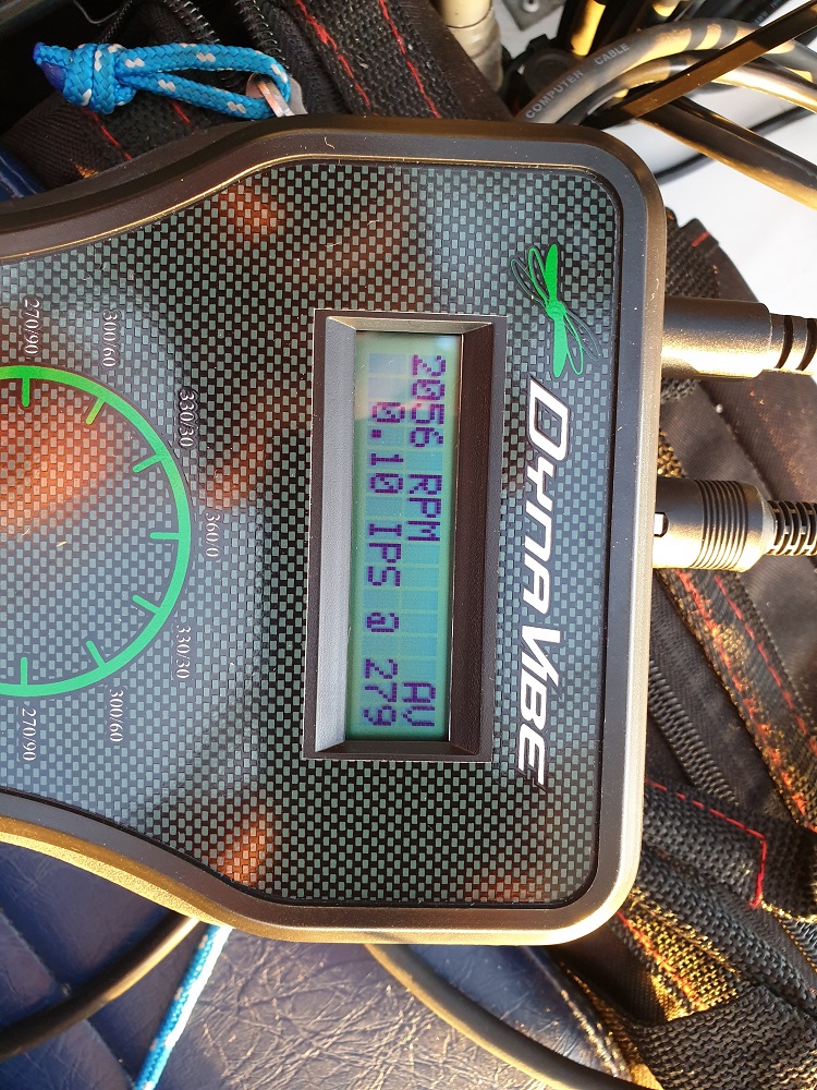

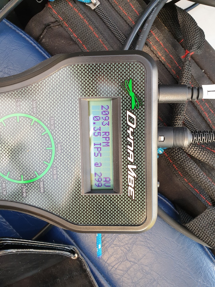

First run showed 0.35 at 299 degrees at my cruise rpm about 5,000 rpm (note the 2058 rpm is after gearbox ratio)

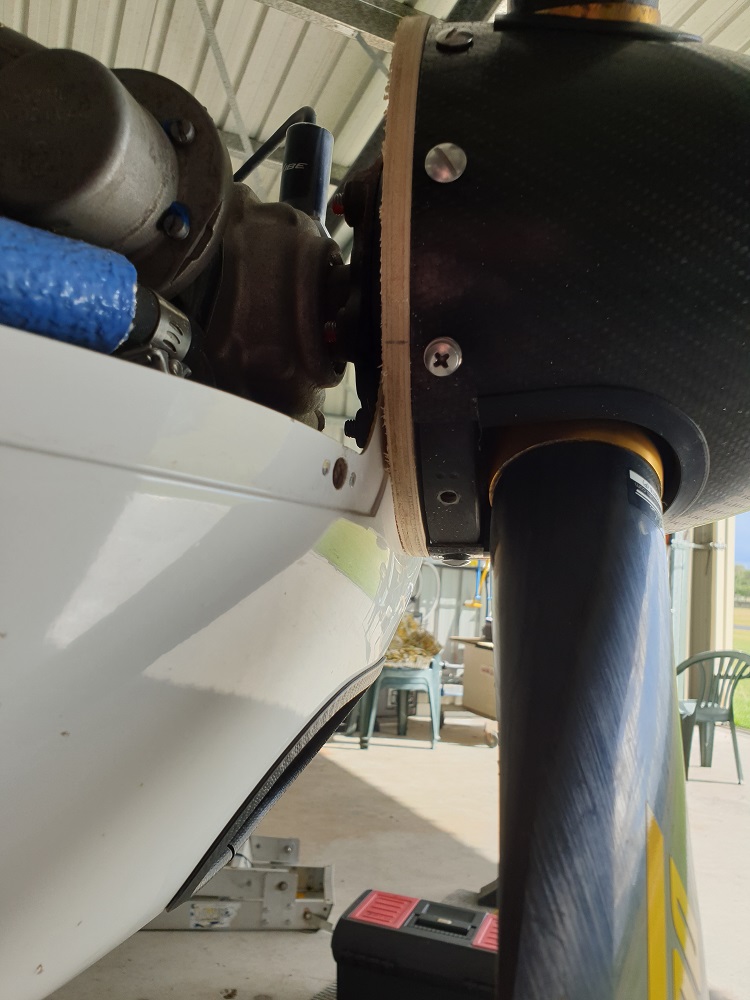

I made a timber protector to ascertain where the added weight is required. I marked the side were the 299 degree mark is.

I use the stick on weights the same as Paul on the inside rear lip of the spinner so centrifugal force keeps the weights against the spinner

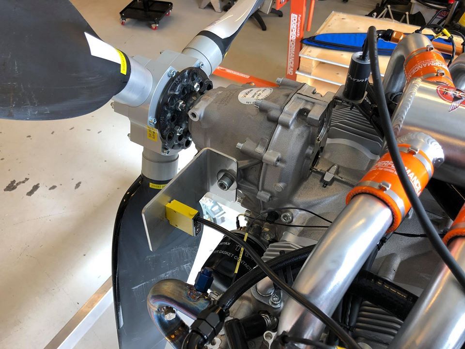

Just noticed where your strip is too..you need to have the transmitter and receiver right behind the prop and I put the reflective strip on the top back side of the spinner base
I also made a bent bracket that goes where your TX/RX is but positioned directly in the centre of the engine..I dont think I have any pics but will check

Hi Paul and Mark thanks for tonight's replies. I have redone the optic sensor bracket (at home tonight) to mount behind the accelerator sensor and tape the root of the prop blade.
With the set up in my post I have got balance to 0.05 which is getting near very good. Another 915 up here had the weights placed in behind the blade hub and I could not see that. He said I should place weight under the head of the prop bolt that mounts to the gear box flange. I see Edge performance mount the sensors similar to mine.
It's ok I believe to mount the optic sensor were I had it (I am mounting on top tomorrow) as you turn the prop until the optic light is on then stop and measure the degrees from the accelerator position as zero (at 12 o'clock in my original setup)

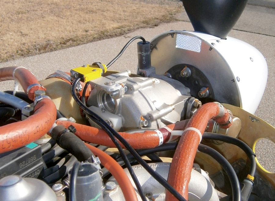

Attached are some images from the net re positioning; the Edge Performance guys should know what they are doing :)
Thanks also for the video. I have between 0.10 and 0.05 without the balance master (Happy with this; just need to permanently place the added weight about 6.5g) on so expect the balance master will bring it down even further. The DUC blades are nice kit.

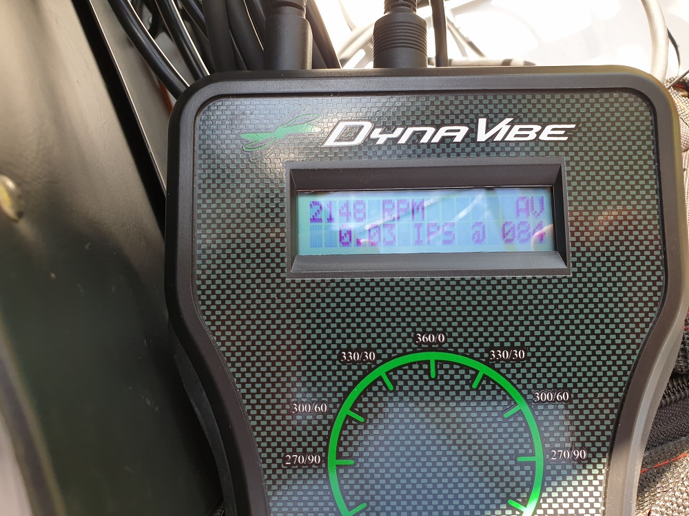

Hi Mark the manual said 1.9 inch wide. At 5,000 got average of 0.03. So happy with that. The new optical position was above the gear housing. I'll make a new mount for 912 so both sensors are over the centre line.
The 0.03 reading is without the balance master fitted. The owner of the dyna is happy with my learning and the new brackets and has let me have the unit longer. I'll do some comparisons with the excelerator sensor mounts and positioning, so I can confirm my beliefs about the angle determination method. Cheers
Finished the balance today. Relocated the optic sensor and first run (no weight) was 0.33 so added weights and the finish mass fitted was 9.25g and at 4,900 ish rpm the magnitude was 0.03 so happy with that. Will do a flight this week; some time all things considered. Images show the sensor position today and the average readings at first run (no weight) and the final run with 9.25g fitted. I am making a new sensor bracket and will do a run (in about 10 days time, need a break to do other choirs) with today's setup and then the new setup and compare the angle required etc. I'll fit a narrow reflective strip as well to see if anything changes. I expect not as edge and other use the 1.9" size reflective strip. Cheers

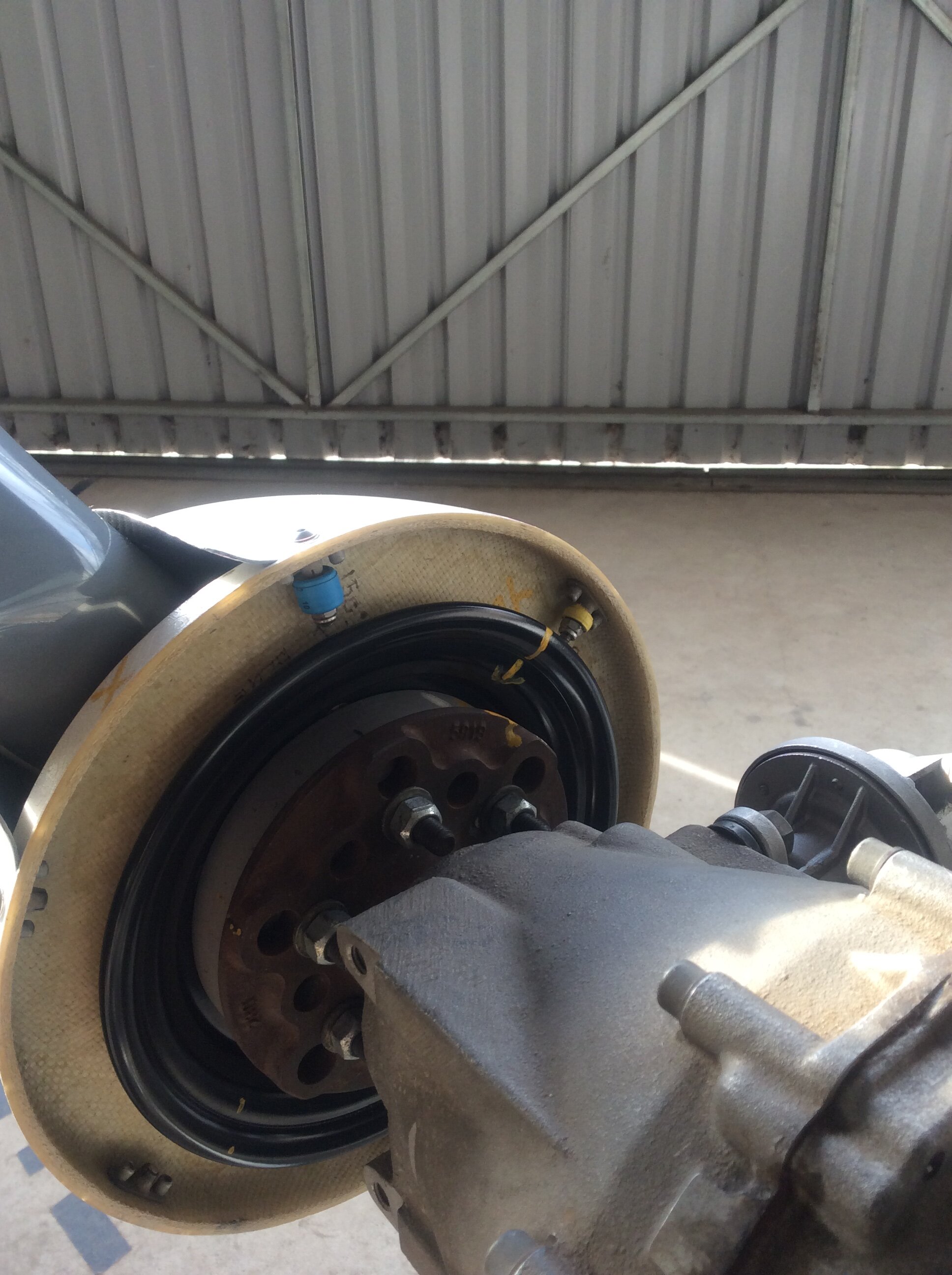

Hi Paul The weight did fit in the spinner back plate (lower left in image). I'll chase up some wheel weights as the permanent fit during the week. I did four sessions to get this far. Feel I need a break and do some other jobs at home. Still learning about the sensor positioning and the angle method to arrive at where the weight is to be fixed and the formula for the weight required. Made some differing size weight mass, 12.6 was the first, then 4.8, 3.2 and then 9.25g was what I've settled on. I returned the instrument today and my mate wanted me to keep it a little longer and keep going on things. So I'll make up a new design bracket and do another run sequence in about a week and a half. Want to do a fly next couple of days and then early ANZAC day for the past troops and airman. Cheers.

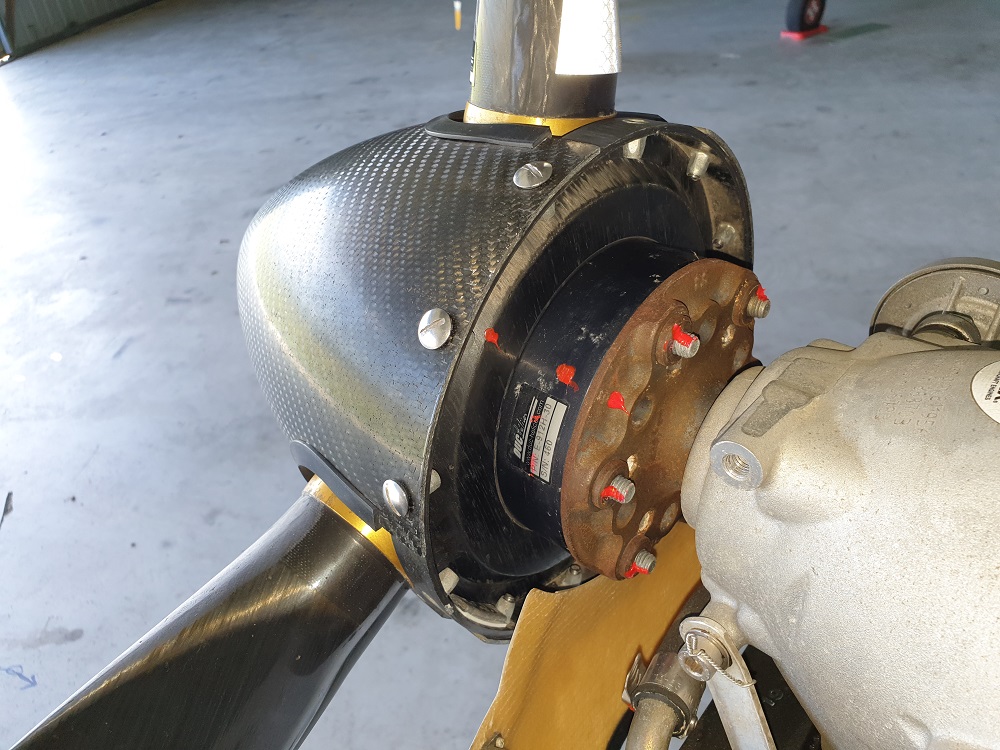

Weights were a combination of extended spinner/back plate screws, stacked ss washers and a nylock nut/stack
Weight added:
  • 90 degree 4.554 gms
  • 150 degree 8.08 gms
IMG_0751.thumb.JPG.ea89ea17cc1ab708e2f632d31f68971d.JPGIMG_0751.thumb.JPG.ea89ea17cc1ab708e2f632d31f68971d.JPG

[ATTACH type=full]52486[/ATTACH][ATTACH]52486[/ATTACH]
