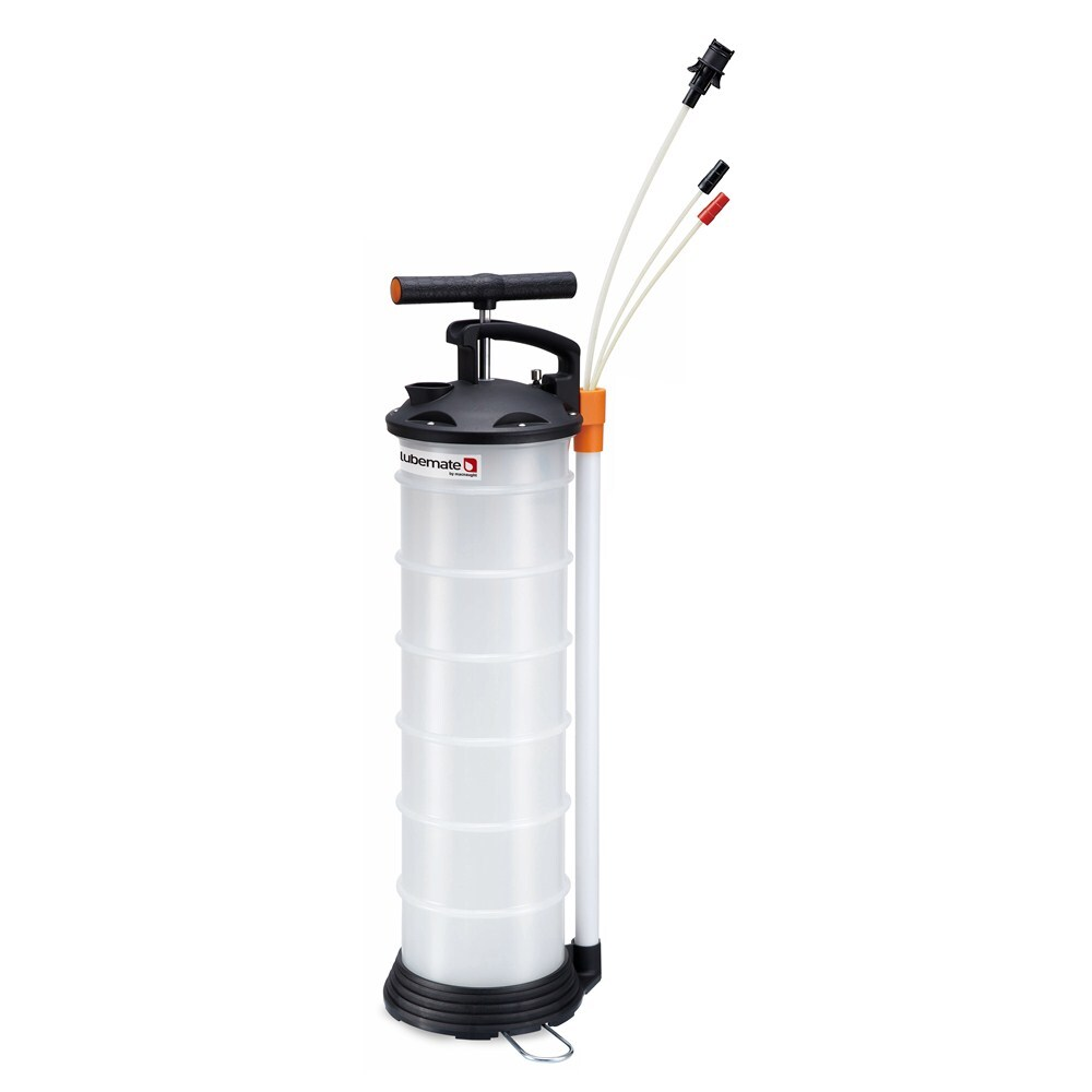

What device us used for the suction?
Link to post
