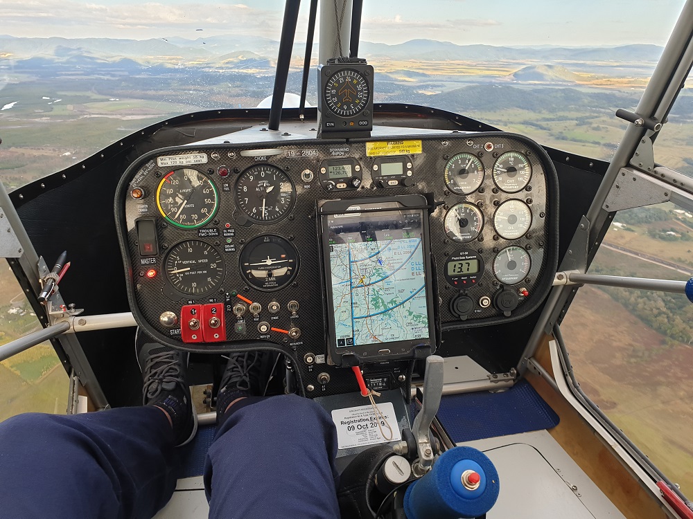

My panel is pretty busy, so my iPad is portrait mounted underneath, out of the sun and between my knees.
Link to post
Rego expired better fix that?iPad mini is all you really need mounted where it's simply convenient. I also use a knee strap to hold mine in some A/C, gives me a writing platform at the same time?

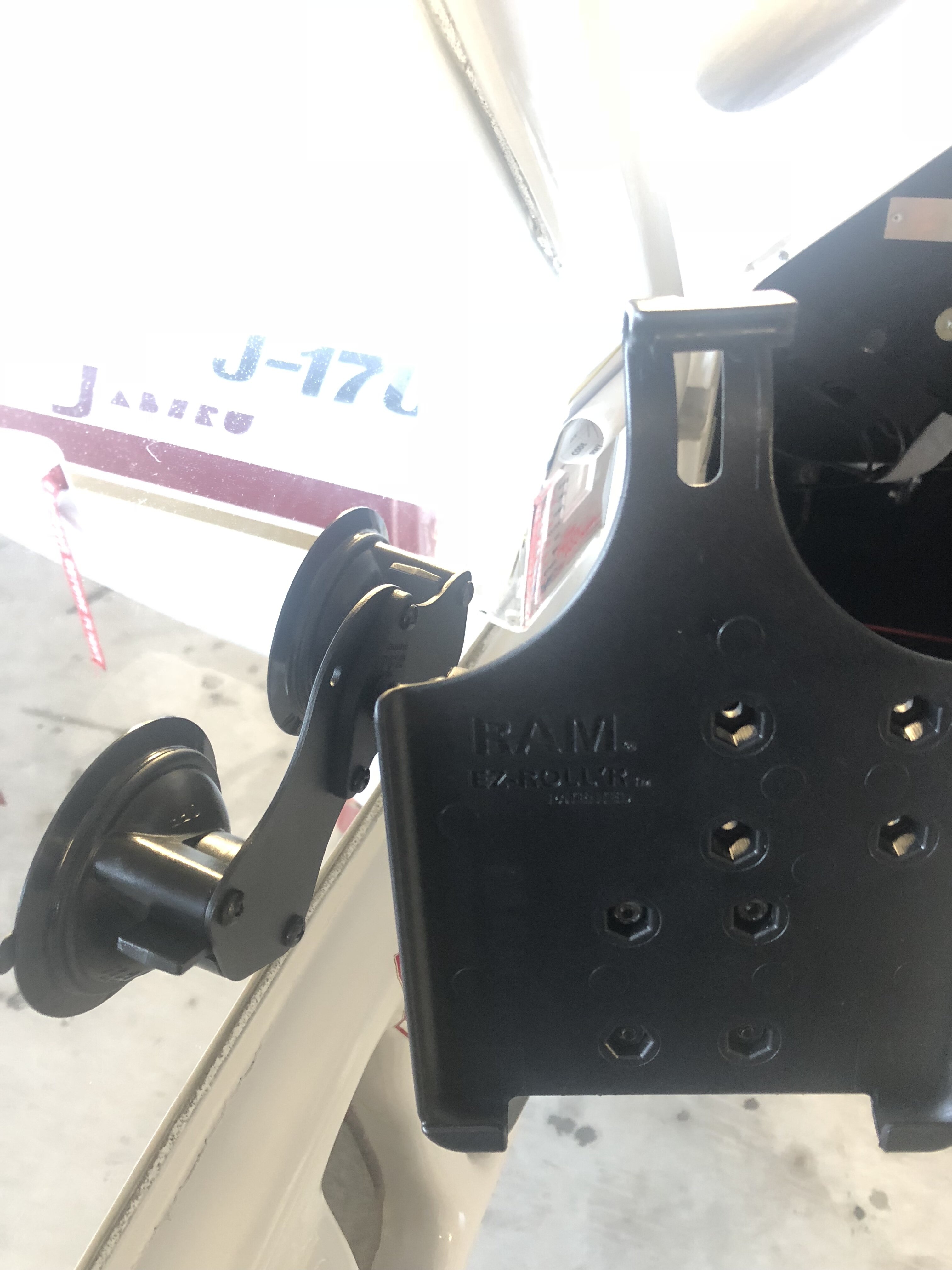

Placed mine using a RAM mount, as you see the cradle (as photo taken using iPad mini) .
Considerations for me were:
  • Ease of access in flight
  • Best viewing angle
  • Minimum obstruction of instruments
My iPad closed down, on temperature, on two occasions . So cut cooling holes in cradle back and later added a dedicated cooling vent directly behind cradle.

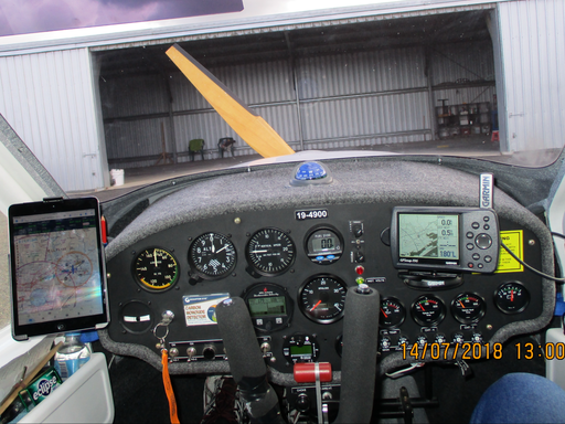

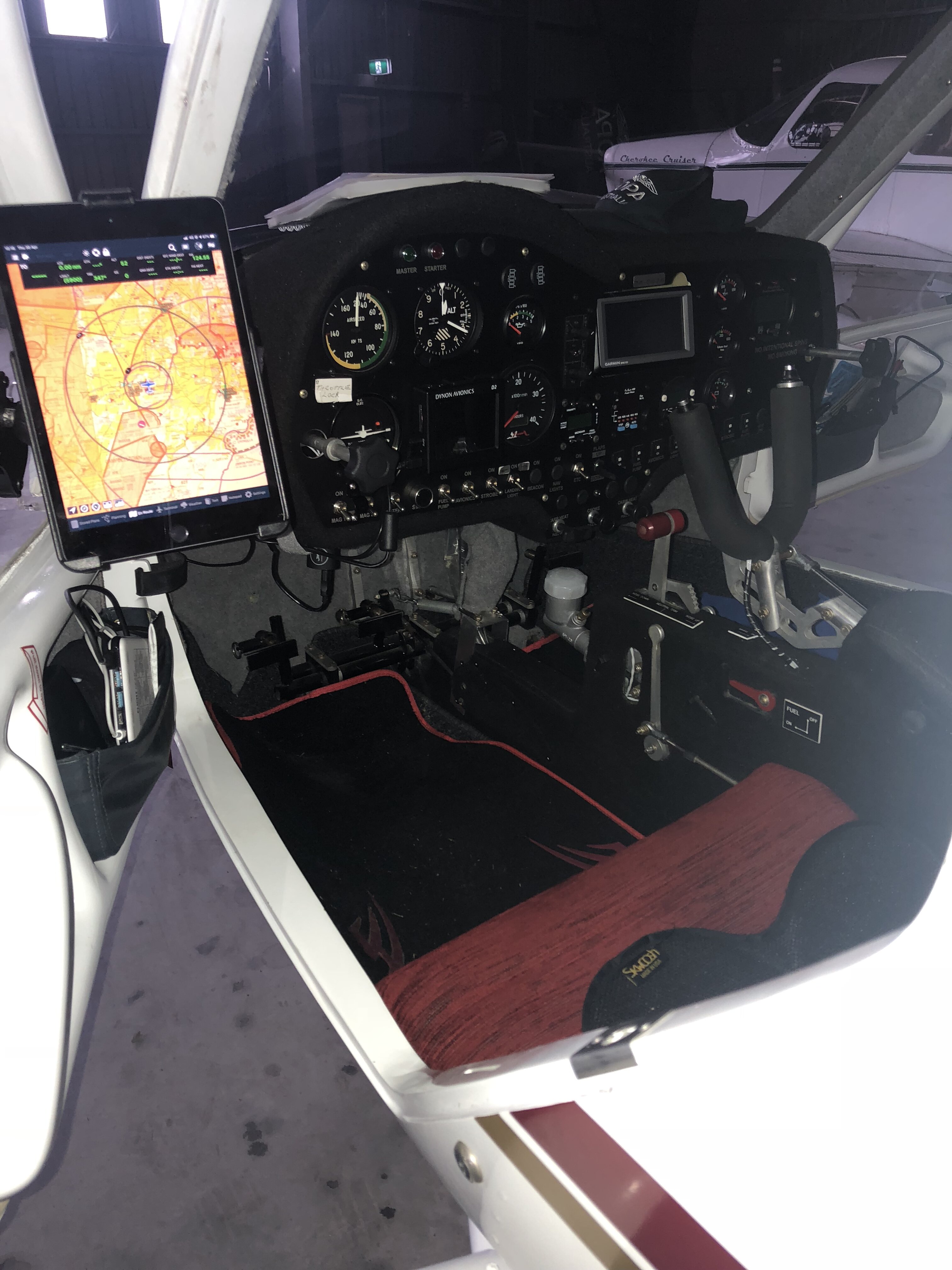

Above is setup in my Jab. Ipad Mini secured to side window with double suction cup.
Running Avplan in Portrait mode
Hi Roscoe - ever had problems with the suction cups letting go in turbulence/heavy landing ?
Yes, I changed from a single cup to a double setup a few weeks ago and havent had a problem since.
The previous single cup did bounce off a few times, always at the wrong moment!

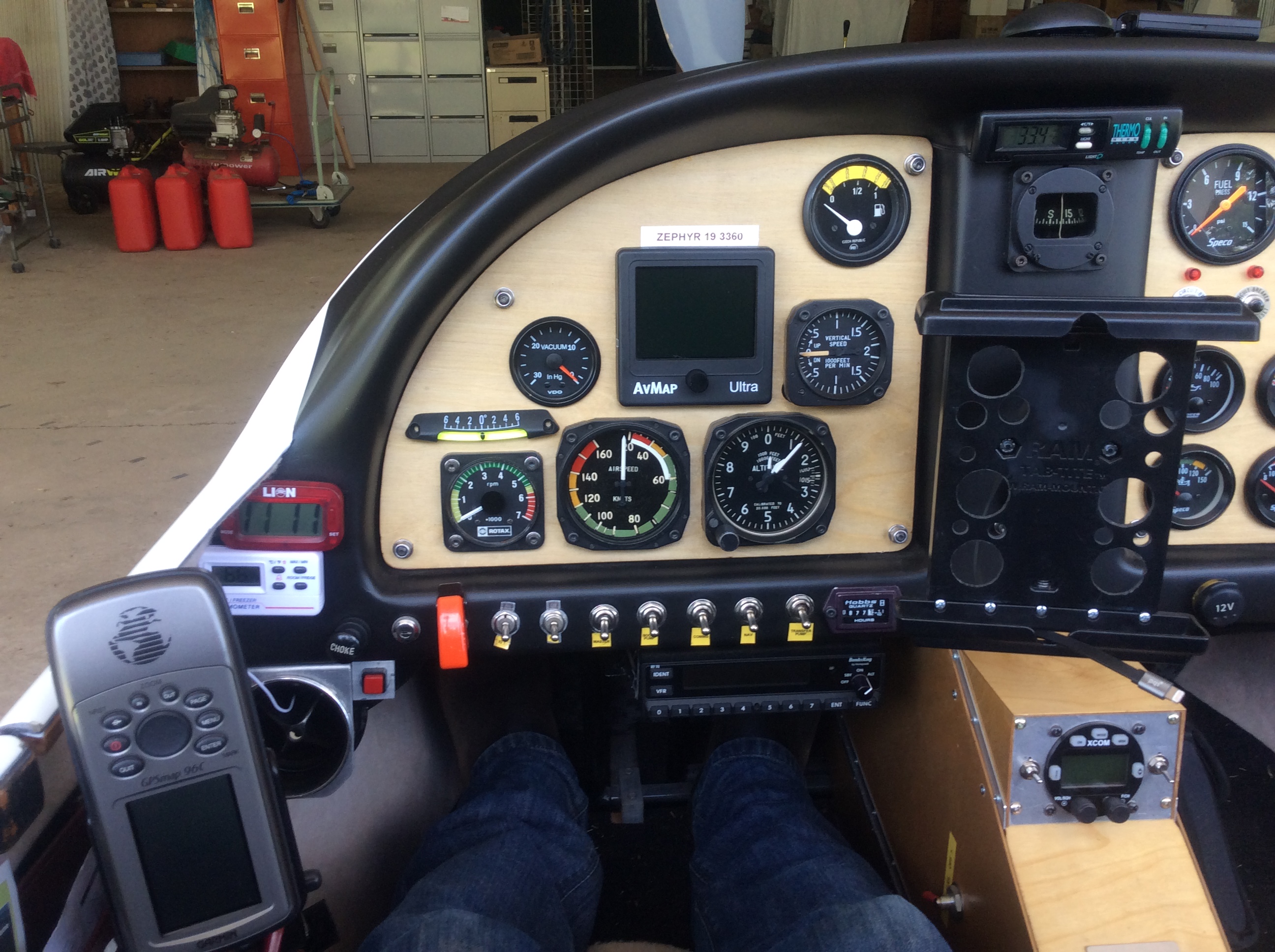

The iPad looks big but is only a mini. It is screwed to the fibreglass inst. panel and adjusts to almost any position, then locked ..... Bob
Just like mine, in a different location.
On Q of location - Bob is your iPad blocking some of your forward visibility ??
Link to post
Hi Skip, there must be some slight vision impairment In the lower LH corner, but can’t recall it being of concern. Of course, my actual eyeline is about 300 mm above this camera shot, I normally see much more of the engine cowl. But I do like the cooling holes in the mount, and will do similar when weather picks up. Unbelievable here at the moment ( App temp 2.6o C )..... Bob
Link to post
H...............................................................But I do like the cooling holes in the mount, and will do similar when weather picks up. Unbelievable here at the moment ( App temp 2.6o C )..... Bob
I used a selection of hole saws, & drill bits - be careful twist drills tend to grab & pull in, potentially splinting the plastic (blunt bits are probably better than sharp). An added (very minor ) side benefit, is a lighter mount.
