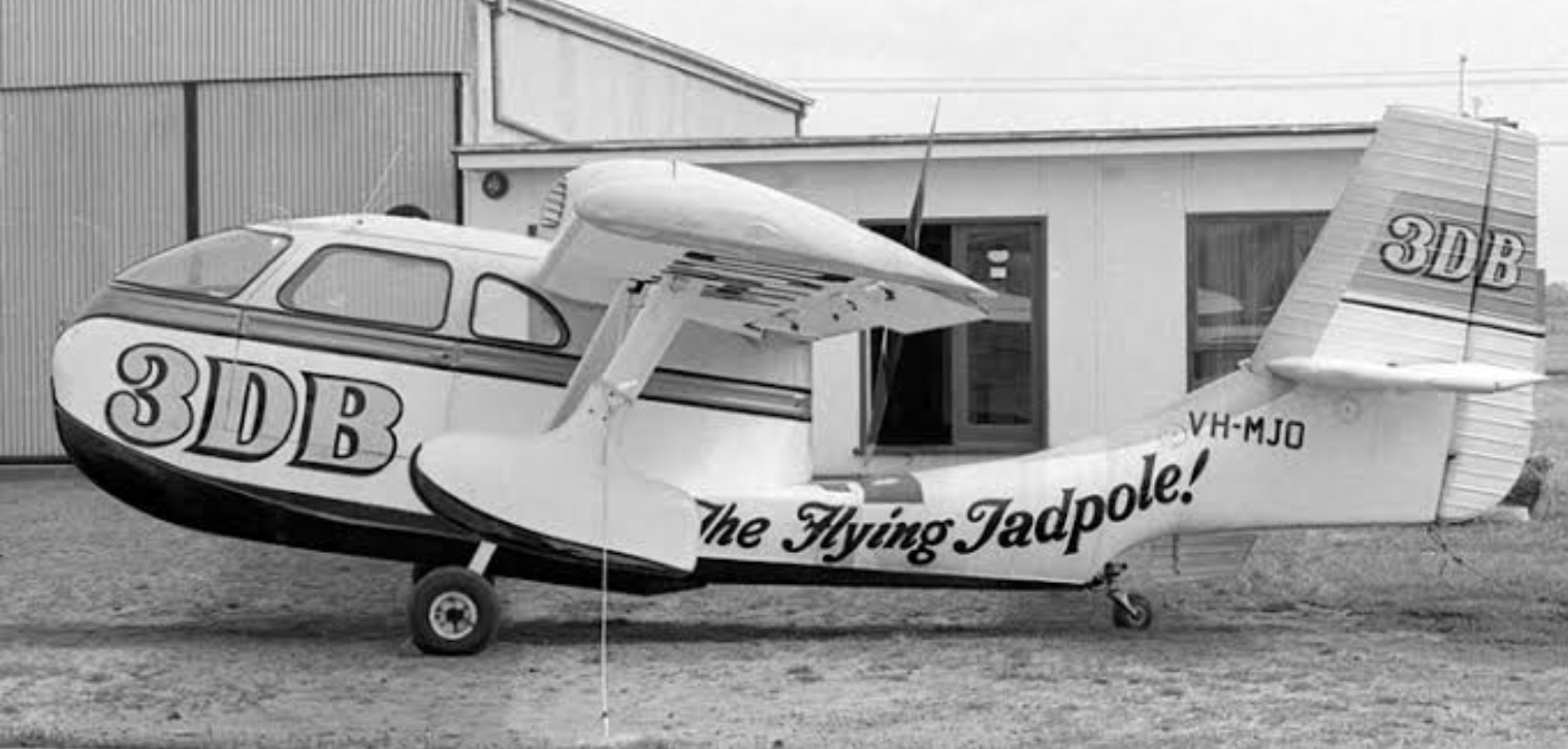

Old Koreelah Posted May 20, 2020 Share Posted May 20, 2020 I guess aligning the thrust line with the centreline of the aircraft is an ideal; I believe that was one advantage of Willy Messerschmidt having the 109 prop lower than the Spitfire, etc. Pretty hard to design a single engine flying boat without putting the prop up high. 1 1 Link to comment Share on other sites More sharing options...
Flightrite Posted May 20, 2020 Share Posted May 20, 2020 Much better design, would barely notice pitch change??? 1 Link to comment Share on other sites More sharing options...
Head in the clouds Posted May 20, 2020 Share Posted May 20, 2020 About 30yrs ago I flew an Osprey 2 quite a bit, around 25-30hrs IIRC. Contrary to expectations it displayed virtually no pitch change between full power and zero power. At the time we concluded it was due to two main factors - 1. The elevators were quite heavy and either not mass-balanced or only partially so, consequently as power was reduced the slipstream effect was also reduced and that allowed the elevators to move down under their own weight and so prevent the expected pitch-up. 2. Although the hs/elevators were of cruciform design, they were still below the majority of the accelerated flow of the slipstream and so as power was applied and the slipstream increased, the accelerated air caused a lower pressure region above the elevators, drawing them up into that region and that compensated for the pitch-down tendency caused by the high thrust line. Having said that, of the many types I have flown, I think the Osprey 2 was the most potentially dangerous of them - it seemed to spend all its time trying to catch you out. Very small performance envelope, high stall speed, vicious wing-drop in the stall at anything except idle power and, as Pylon alluded to earlier, required careful loading checks to ensure CG was within required range. 1 3 Link to comment Share on other sites More sharing options...
facthunter Posted May 20, 2020 Share Posted May 20, 2020 Planes landing on water do present design difficulties they normally must fly with an aerodynamic down load on the horizontal stab and elevators to offset the drag acting well below the thrust line. This dynamic load has to be supported by the mainplanes causing extra drag. You can (if you are game ) make the plane tail heavy but that causes stability issues. Nev Link to comment Share on other sites More sharing options...
