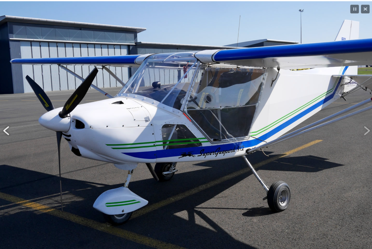

In the video the chap says that their first models are for the Super Guépard (another French design - see pic - very similar to the Skyranger) but that legs for others will follow.
