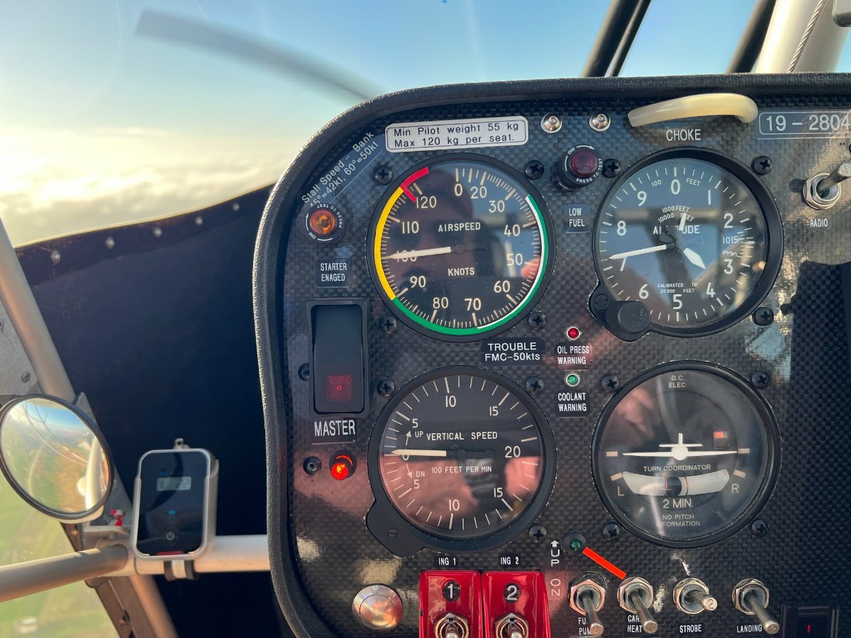

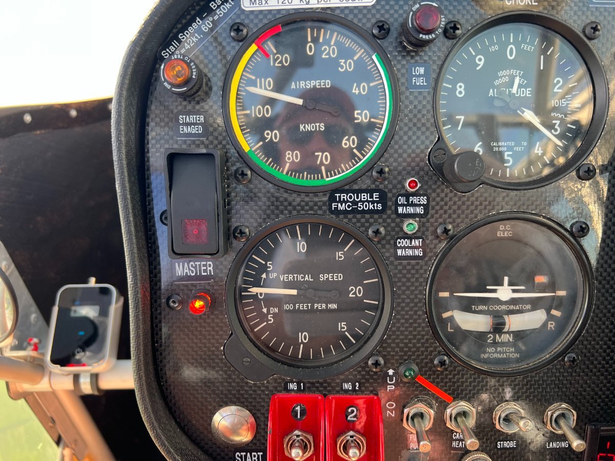

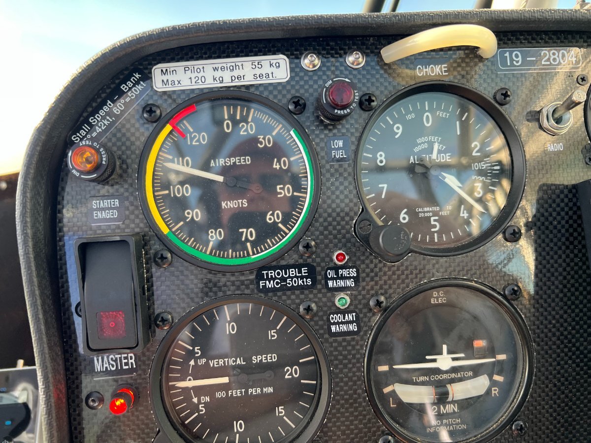

Blueadventures Posted April 20, 2022 Share Posted April 20, 2022 Fitted in an hour flight in the Nynja this morning. My findings were that I'm very happy with the E-Prop propeller. It was set with the three blades at 24.9, 25 and 25.1 degrees; being within the 0.3* I decided to leave as is and fly to evaluate. Ground static rpm was 5,400. First flight climb 1,400 f/m (better than DUC never much over 1,000 one up) Noticed had to put in right rudder (was perfect with DUC and the rudder input was more than acceptable) also during taxi to take off point noticed low rpm was a faster travel speed, also runway is bitumen sealed. 4,500 rpm 85 kts; 5,250 gave 108kts (quickest with DUC was 105 kts at 5,500 rpm). Landed and moved rudder bungee 6mm to port. Take off climb 5,250rpm and 1,250 ft/m OAT 24*C. Only slight need of right rudder (certainly acceptable) so will move rudder bungee another 2mm to port. Will before next flight re-pitch for 5,500rpm static. There is wild weather coming so will be a week or so before flight. 3 1 Link to comment Share on other sites More sharing options...

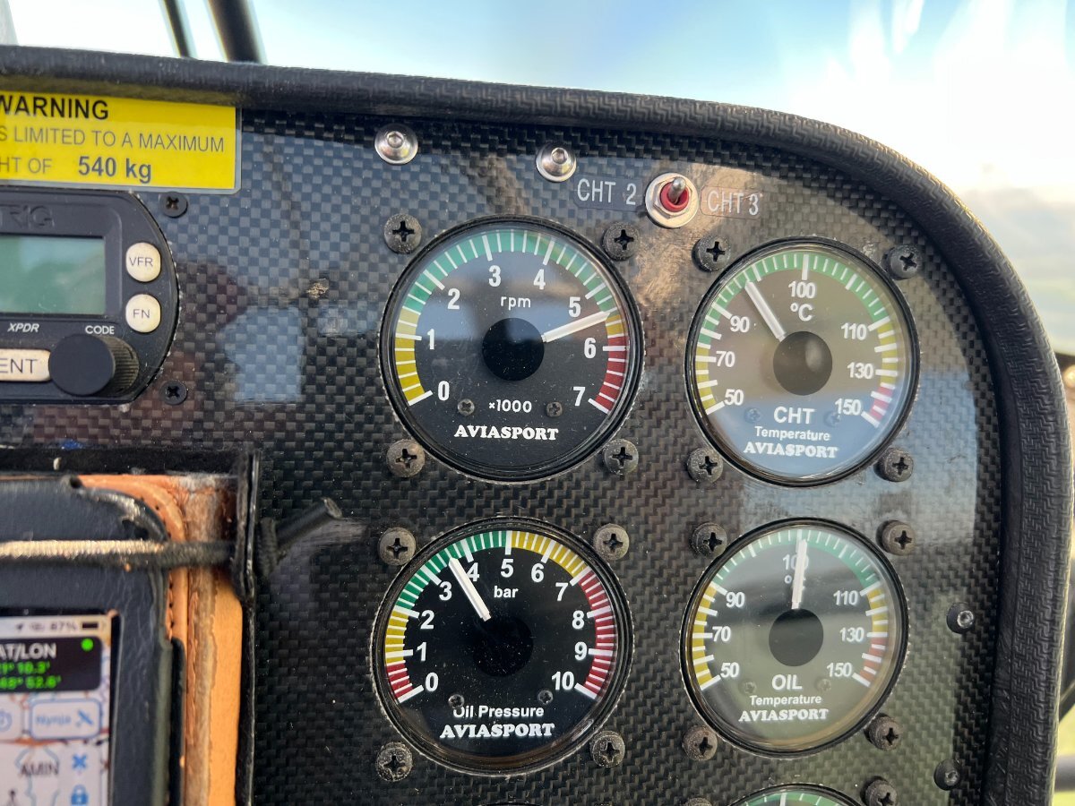

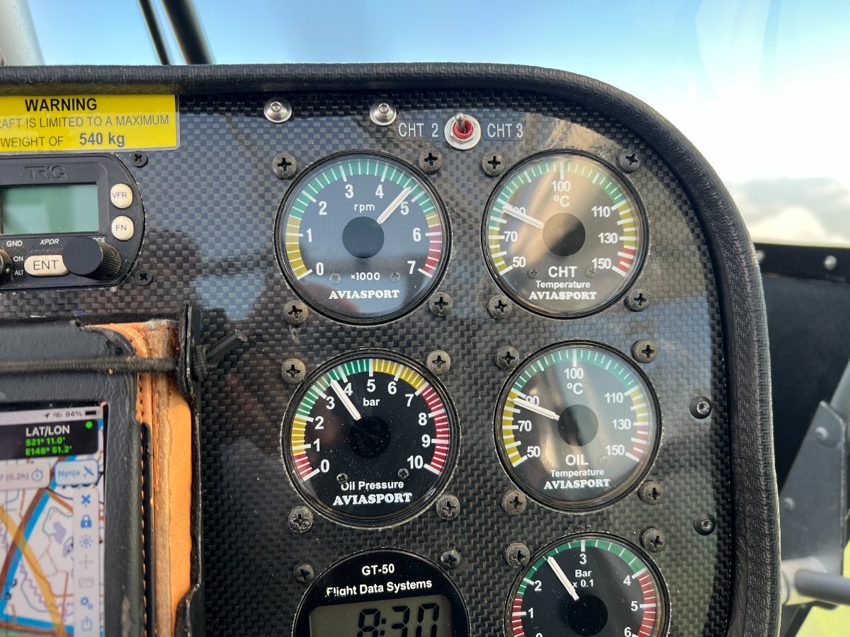

Blueadventures Posted May 2, 2022 Share Posted May 2, 2022 Did another hour today; 2nd session and third flight with the E-Prop. Pitched decreased to 24.5* from 25*. Turbulent air so had to get above 3,500ft for smooth air. Happy with results. WOT s&l 5,450rpm 108Kts. 4,000rpm - 75kts, 4,200rpm - 80kts, 4,400rpm 85kts, 4,800rpm - 90kts, 5,100 - 100kts, I'll look at 4,800 to 5,000rpm for cruise of 90 to 95kts. Have a two hour trip end of month to Old Station so will start seeing the actual performance including fuel usage etc and do a few local trips before hand. 4 2 Link to comment Share on other sites More sharing options...

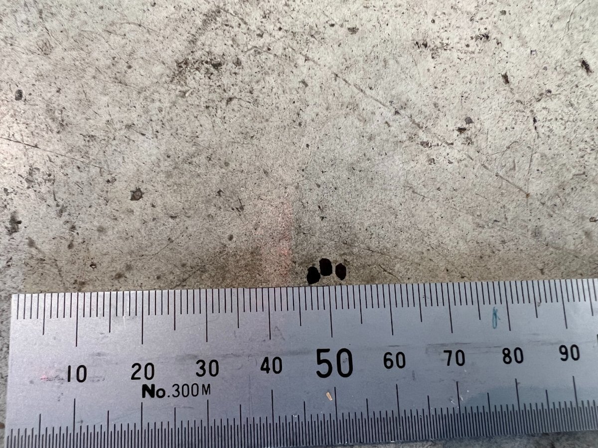

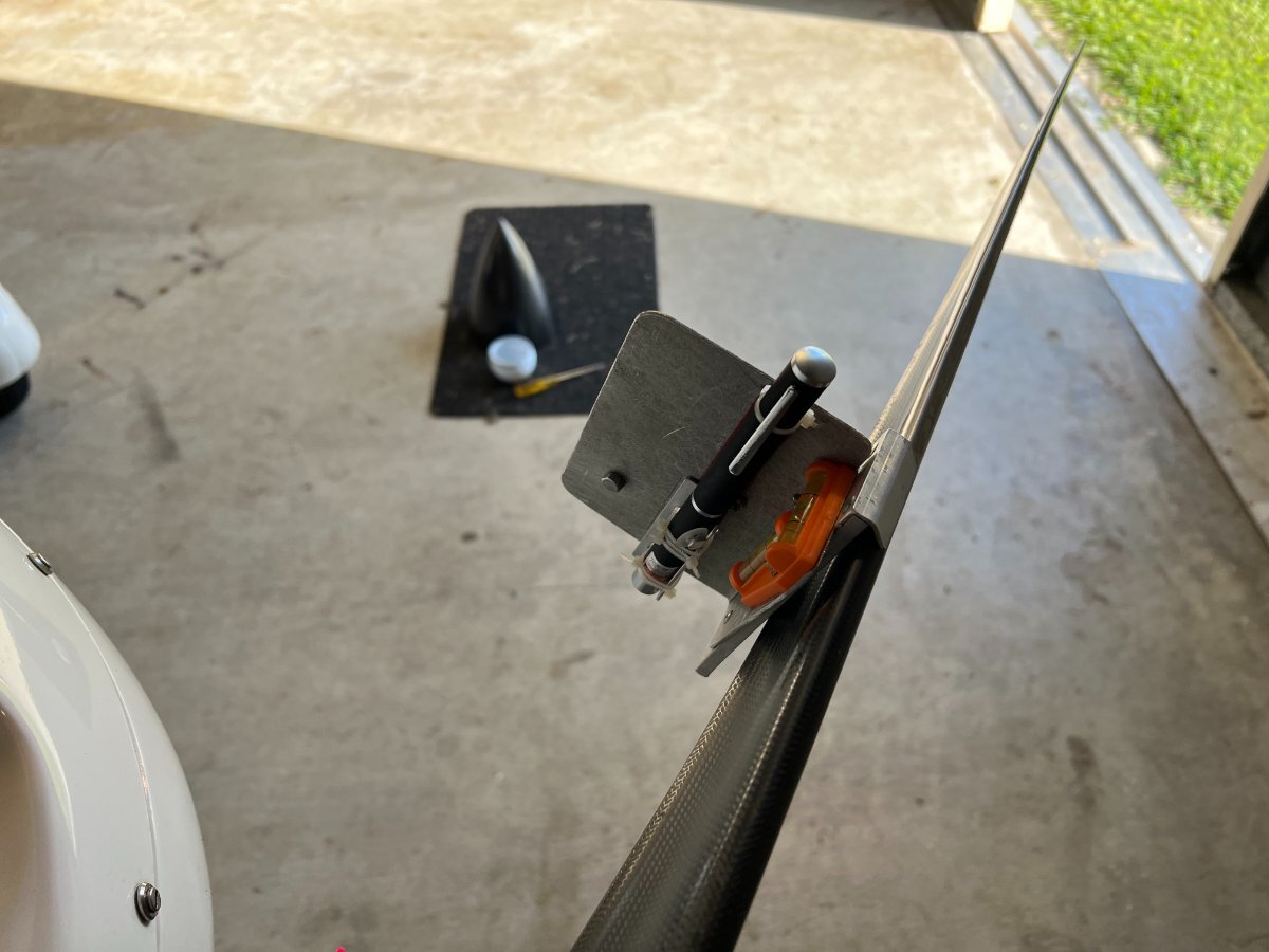

Blueadventures Posted May 6, 2022 Share Posted May 6, 2022 (edited) For info; after adjusting the pitch I check and make final adjustment with my laser pointer pen fitted on my pitch adjuster. The distance between the dots is means that pitch is within 0.09 (less than 0.1 and the manual asks for within maximum 0.3 degree so close enough for the second pitch adjustment trail. All good now at 24.5 degrees so will fly this for a while. Edited May 6, 2022 by Blueadventures 3 Link to comment Share on other sites More sharing options...

IBob Posted May 6, 2022 Share Posted May 6, 2022 10 hours ago, Blueadventures said: Not checked the tracking as prop very flexible and tip end portion has little rake as the aggressive cupping and pitch is the inboard 1/3rd. Very happy with the prop did a 1.4 hour flight yesterday (Thursday) and did some long runs s&l at various rpm settings. Will be doing a 2.3 hour flight each way at end of month will have an indication of performance after that. How far in from the tip are you gauging the pitch? In my view, if setting pitch with a laser, you also need to be checking the (static) blade tracking, since any difference in blade tracking will (also) shift the laser dot on the floor. Link to comment Share on other sites More sharing options...
Blueadventures Posted May 7, 2022 Share Posted May 7, 2022 5 hours ago, IBob said: How far in from the tip are you gauging the pitch? In my view, if setting pitch with a laser, you also need to be checking the (static) blade tracking, since any difference in blade tracking will (also) shift the laser dot on the floor. Position is as per manufactures spec (page19 if you have a copy) the edge where the titanium leading edge meets the carbon leading edge. Initial pitch set with the supplied guage and then I follow up with the laser pointer. I'm in early days with this prop and have been involved in pitch setting of some E-props in Tractor and pusher configuration with 3 and 4 blade modes. Later on I will adjust for 5500 - 5600 and higher; but for the next month or so will settle at this and record performance over long legs at set rpms. Link to comment Share on other sites More sharing options...

IBob Posted May 7, 2022 Share Posted May 7, 2022 1 hour ago, Blueadventures said: Position is as per manufactures spec (page19 if you have a copy) the edge where the titanium leading edge meets the carbon leading edge. Initial pitch set with the supplied guage and then I follow up with the laser pointer. I'm in early days with this prop and have been involved in pitch setting of some E-props in Tractor and pusher configuration with 3 and 4 blade modes. Later on I will adjust for 5500 - 5600 and higher; but for the next month or so will settle at this and record performance over long legs at set rpms. I don't have the prop...or the manufacturer's spec. Presumably this is further in from the tip than the traditional 1/3 radius in? Link to comment Share on other sites More sharing options...
Blueadventures Posted May 7, 2022 Share Posted May 7, 2022 11 minutes ago, IBob said: I don't have the prop...or the manufacturer's spec. Presumably this is further in from the tip than the traditional 1/3 radius in? I'll measurenext time at the hangar and let you know. also on the prop image on the floor you get an idea of distance ratio, Going out now so I'll look later. Link to comment Share on other sites More sharing options...
