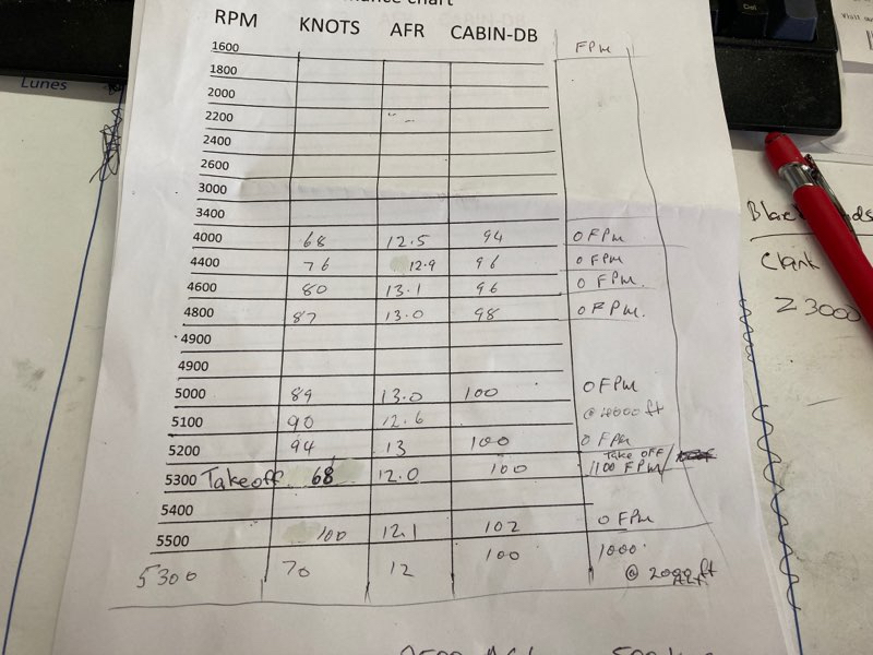

Dan went flying today as the weather was quite nice. This was to do some more flying behind the Eprop and also to test the new jets he put in the carbs to get better mixture results than standard jets were producing.
The chart is pretty self explanitory.
The aircraft was 2 POB and 3/4 fuel so was around 500 + kg The weather was very cool this morning with fog in a lot of places so the air was pretty thick
Normal cruise is around 85kts for his VG savannah
With the prop reset to produce 5500 rpm on the ground the pitch was further reduced from the 24.9 we set on sunday to now 24.6 deg
Cruise now at 89kts..thats a lot more than I expected considering Dan is usually only himself on board. The climb rate at 68kts at 1100 fpm is also pretty darn good with 2 pob and that was at 5300 rpm. He thinks because the engine was running pretty rich at full power with the jet change he would get to the 5500 on climb as he did get to max ground rpm but only himself on board that day. The one thing he did comment about was now it would be quite easy to get to VNE with this prop especially when you lower the nose to decend as you dont have the blade drag like the others.
In my savannah 1 up and at 5600 rpm with the bolly at WOT level flight I could only get 97 kts..his with 2 up gets 100kts at 5500.
There is basically no vibration from the engine at all and also the buffeting around the airframe is far reduced during flight to the point where it is very noticable also the noise level in the cockpit is greatly reduced . He took the headset off and said you can now easily fly without the headset without too much drama
So all things considered these are very big improvements with this new prop.
Currently there are 2 more going to WA and one going to Victoria. in about 3 or 4 weeks time we will have some more data and done on different aircraft..Foxbat A22. CTSW and Tecnam P2008..This will be interesting to see some different numbers and also vibration reports
