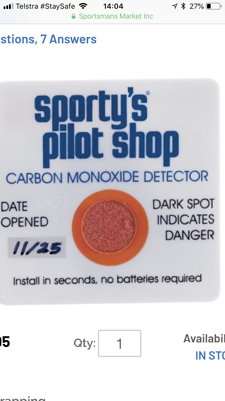

Roscoe Posted July 6, 2020 Share Posted July 6, 2020 1 Link to comment Share on other sites More sharing options...
Roscoe Posted July 6, 2020 Share Posted July 6, 2020 I wonder how accurate these things really are! Link to comment Share on other sites More sharing options...
Blueadventures Posted July 6, 2020 Share Posted July 6, 2020 I wonder how accurate these things really are! Found those types only usually work once if they get a hit of CO. The long life ones are best but not available at present. How many flights you done with it? Link to comment Share on other sites More sharing options...
Flightrite Posted July 6, 2020 Share Posted July 6, 2020 I've seen a few of these old 'dot' detector cards stuck on the dash that have been there a100 years! I'd never use/trust one! They ain't cheap either. Link to comment Share on other sites More sharing options...
Roscoe Posted July 6, 2020 Share Posted July 6, 2020 Found those types only usually work once if they get a hit of CO. The long life ones are best but not available at present. How many flights you done with it? I actually have the 18 month one. Cost about $20. Done lots of flights since installed Aug last year. I check it regularly in flight. The one in the photo only lasts a couple of months and costs USD$5. Link to comment Share on other sites More sharing options...

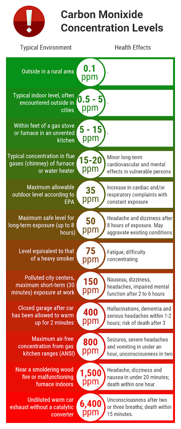

Thruster88 Posted July 15, 2020 Share Posted July 15, 2020 So after reading the two pages of this thread: What's the go when you are flying along - with a CO detector installed - and it goes off? Other than opening windows (No, not a microsoft reference) then what? With a digital detector you would get plenty of warning, exhaust cracks start small and the detectors are very sensitive. In the event of a sudden high number this chart will help you decide what to do. 3 1 1 Link to comment Share on other sites More sharing options...
Methusala Posted July 17, 2020 Share Posted July 17, 2020 Exhaust failure can happen suddenly and severely. I was once flying from Tumut to home base when the dot went black. Opened the fresh air vents and did mental arithmetic and touching finger tips, nose and other extremities (NO! Not that one!) and landed to find a large chunk of exhaust pipe had detached on a sharp bend. This was the $5 detector and about 18 months old so they do work. 1 Link to comment Share on other sites More sharing options...

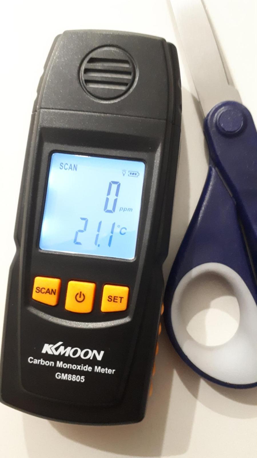

Thruster88 Posted July 17, 2020 Share Posted July 17, 2020 https://blog.aopa.org/aopa/2014/10/20/carbon-monoxide-silent-killer/ It seems possible that Co may have been a factor in lots of crashes. The $40 digital detector is just another thing to monitor like oil and fuel pressure. 1 Link to comment Share on other sites More sharing options...
