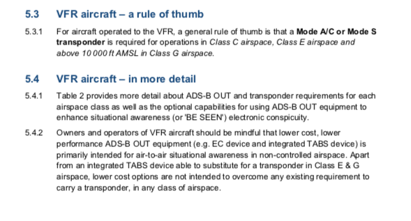

Garfly Posted July 11, 2020 Share Posted July 11, 2020 Hi Mark, thanks for posting, very interesting. (Love your new Avatar BTW ;-) So it looks like devices such as the SkyEcho2 do not (never will?) suffice for class C transit - if recreational pilots/aircraft are ever allowed it. Still, as well as the comfort of conspicuity, it seems that they do make Class E, available to us, if and when needed. It'll be interesting to see how it turns out in practice but I do like the idea of being visible to the TCAS of commercial craft - as well as to other amateurs if EC (electronic conspicuity) gadgets are widely adopted. From the CASA document linked to by Mark in the original post: (As I understand it, the SkyEcho2 would be regarded (in the table below) as an Integrated TABS; SIL=1 Is that right, Mark?) https://www.casa.gov.au/sites/default/files/advisory-circular-91-23-ads-b-enhancing-situational-awareness.pdf Link to post Share on other sites

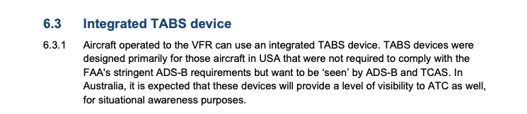

horsefeathers Posted July 12, 2020 Share Posted July 12, 2020 Hi Mark, thanks for posting, very interesting. (Love your new Avatar BTW ;-) ... ... ... ... (As I understand it, the SkyEcho2 would be regarded (in the table below) as an Integrated TABS; SIL=1 Is that right, Mark?) [ATTACH=full]54569[/ATTACH][ATTACH=full]54570[/ATTACH] https://www.casa.gov.au/sites/default/files/advisory-circular-91-23-ads-b-enhancing-situational-awareness.pdf Won't the SkyEcho2 be regarded as an EC device (ie no TCAS) device, not Integrated TABS?? It has no transponder functionality. From their own website: The SkyEcho2 portable ADS-B transceiver has been accepted by CASA as an approved Electronic Conspicuity (EC) Device as an enhancement to "See and Be Seen" from 16th July, 2020. See also Page 31 ff from the above CASA circular. Link to post Share on other sites
Kyle Communications Posted July 12, 2020 Author Share Posted July 12, 2020 (edited) TCAS is a separate system Its a TABS device so will be picked up by other ADSB and also the ADSB ground station if within range of that depending on your height. it puts out the ID code you get for a transponder so its on the AirServices system as registered so if they see you on the ADSB network they know who you are and the height and position and speed as supplied by the onboard GPS info but also to locally flying aircraft with ADSB in capability..that will include things like Stratux and other devices which only ever receive ADSB data..the Sky Echo actually transmits that data to identify you but at 1/10 of the usual power so its only a much shorter range device Just did some further looking into TCAS...seems TCAS will pick it up because its a SIL-1 device Edited July 12, 2020 by Kyle Communications Link to post Share on other sites
Garfly Posted July 12, 2020 Share Posted July 12, 2020 Here is something on the Uavionix site which clears that up: https://uavionix.com/products/skyecho/ Definition in the CASA document. Link to post Share on other sites

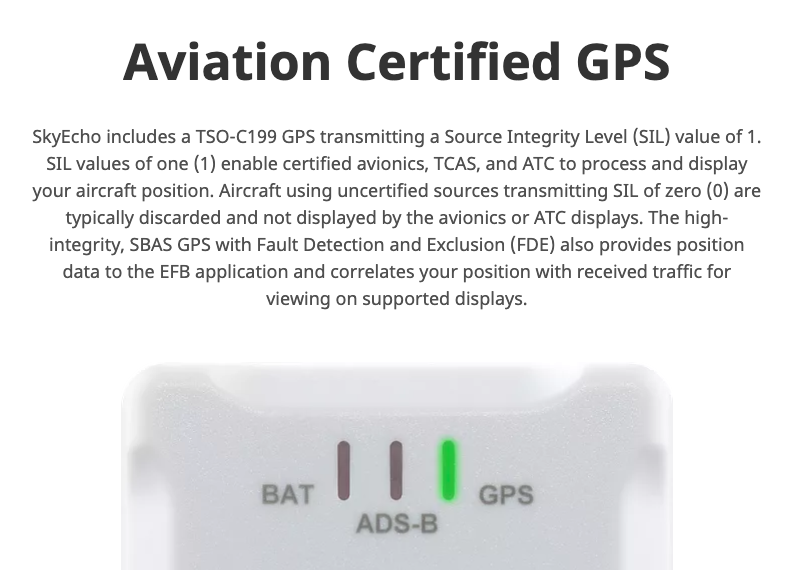

mothra Posted July 15, 2020 Share Posted July 15, 2020 ATC will only see the transponder return when in range of both receivers. Instruments putting out SIL 1 will be received by the ADS B ground station but filtered out of the feed to ATC as not having sufficient integrity to serve as the basis of a surveillance service. They will be seen by other airborne or ground based ADS B receivers and TCAS. Link to post Share on other sites
Garfly Posted July 15, 2020 Share Posted July 15, 2020 (edited) Instruments putting out SIL 1 will be received by the ADS B ground station but filtered out of the feed to ATC as not having sufficient integrity to serve as the basis of a surveillance service. Really? So the SkyEcho2 will be invisible to ATC? (Even in range of an ADS-B ground-station?) That seems to contradict what is claimed on the uAvionics Australia web site, no? https://www.uavionix.com.au/skyecho2/ "SkyEcho2 is the world’s first commercially available portable ADS-B IN and OUT system. Complete with an integrated TSO certified SBAS GPS and barometric altimeter, SkyEcho2 transmits your aircraft location, altitude, and identification via 1090MHz ADS-B, enabling you to be seen by nearby aircraft and Air Traffic Control (ATC) equipped with an ADS-B receiver." This is what the CASA AC has to say: AC 91-23 v1.0 - ADS-B for enhancing situational awareness "SIL means Source Integrity Limit. SIL is a numeric value between 0 and 3 that indicates the GNSS position source’s probability of exceeding the reported integrity value. It is one of the components of a standard ADS-B position message. A SIL number of 2 or 3 indicates that the GNSS position source information is suitable for ATC separation, while a SIL number of 1 indicates that the GNSS position source information is suitable for situational awareness only and is not suitable for ATC separation. SIL is a static (unchanging) value, normally specified by the equipment manufacturer and normally set by the installer at the time of equipment installation." When they "for situational awareness only" do they not refer to the situational awareness of the controller? (even if he or she does not have the confidence to issue separation directives) Edited July 15, 2020 by Garfly Link to post Share on other sites
Kyle Communications Posted July 15, 2020 Author Share Posted July 15, 2020 They must be visible to ATC because you will be issued a hex number to program into the unit This identifies you to ATC and other aircraft. Each number MUST be unique Link to post Share on other sites

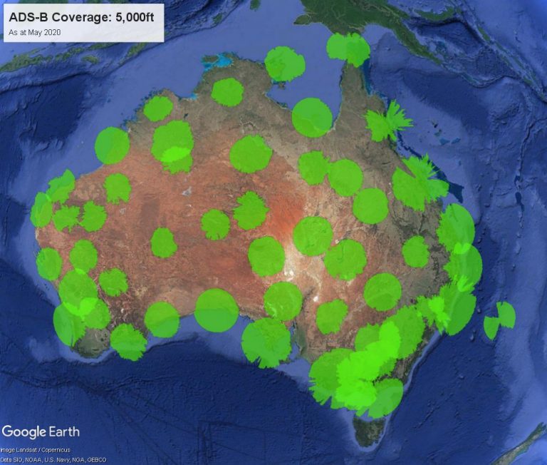

Garfly Posted July 15, 2020 Share Posted July 15, 2020 (edited) Yes, Mark, as far as I can work out, the filtering happens at levels less than SIL1, that is SIL 0 and below. I think being visible to ATC could be very useful, though. They might even be prepared to help with Flight Following and the occasional traffic safety alert. And, of course, they'd be better able to help out in a crisis. However, I'm pretty doubtful as to just how much coverage will be possible at the levels we fly at, especially given the low power of the EC units. I wonder if anyone has done any testing of this. Anyway, it only becomes legal tomorrow. And, as of now, the SkyEcho2 is the one, and only, bit of gear that's approved for the role. Below is a recent map for 5,000'. You can see that there are quite a few blank areas. Particularly along the NSW coastal strip. And presumably this is based on more powerful transmitters than are allowed in EC (Electronic Conspicuity) devices. But, for all I know, that might not matter that much. It may be the ground stations will be able to see those 20watt units just as well. But what they are really designed for, of course, is to be visible to other (especially commercial air traffic). I understand that older TCAS units are not ADS-B (in) capable but most modern ones are. But I gather that many (most?) professionally operated aircraft have some way of displaying all ADS-B targets (SIL 1 and above.) But I would love to find out just how much we could rely on commercial transport being able to see a SkyEcho2 equipped aircraft. And, maybe even more to the point, especially in the Williamtown area, do military aircraft have that capability. Any ideas? By the way, yes, the tailBeaconX is the way to go if you want to get serious about your conspicuity - and have hopes of entering Class C. But, apart from being 4 times more expensive, I understand that it requires you to have a standard Mode C or Mode S transponder already; it's job is just to add ADS-B out to it, right? And, oh yeah, I think it helps to have a tail light. Only your fanciest rag and tube jobs come with a tail light. LOL Edited July 15, 2020 by Garfly Link to post Share on other sites

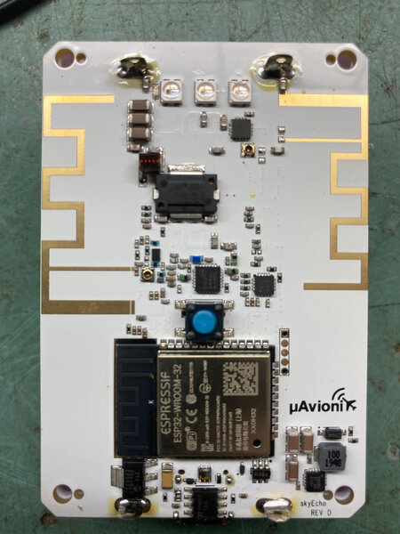

Kyle Communications Posted July 15, 2020 Author Share Posted July 15, 2020 The TailbeaconX is a transponder you dont need another one. It is 250W output the same as a regular one but it also has the satellite ADSB capability and the tail light beacon as well US$2500 but currently only USA approved but I would imagine no drama here as it will meet FCC spec which means it will get a ACMA tick here no problem I would imagine all military aircraft would be TCAS fitted. From 5000ft 20w will work to the ground stations I am pretty sure as line of sight makes a huge difference at 1090 mhz its only path loss that is the issue and from experience I dont believe it would be that big a deal.....ATC will see you. I dont know if ATC have the Aireon system in use...I would imagine they do especially for overseas flights. Its just FR25 and others that dont get that data possibly 1 1 Link to post Share on other sites
