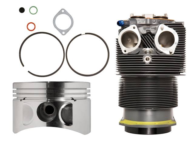

Sorry for the incorrect terminology, got that from the jab engine manual. I know nothing about piston design but lycoming use a piston that has no slot with great success in a steel barrel, why can't this type work in a jab steel barrel?
[ATTACH type=full" alt="images (4).jpeg]55256[/ATTACH]
because of the jab engine design!, pin does not exit the cylinder on a Lycoming . Piston has to be slab sided on a jab. to fit down into crank case , the jab is very compact compared to Lycoming and jab has a much shorter conrod , conrod stroke ratio of approx. 1.5:1, the engine [vn v6 that the pistons were designed for] has a cr stroke ratio of 1.98:1 nearly 2:1. Generally the shorter the cr/stroke ratio the more offset on the pin. The holden v6 piston has an offset of .020", another vehicle I looked at [ Toyota] with similar c/r/stroke ratio to the jab has an offset of.080".how ever in the jab case it has nothing to do with the cause of piston breakage. I don't know what the ratio is on the Lycoming but it looks quiet long , I have one in the workshop at the moment , I will measure it tomorrow. The jab engine is what it is ,and we have had to work with its design to overcome the piston issues , at the moment we have two engines that have just achieved 1000 hrs without breaking pistons ,and these engines have seen some hard work and run only on 95 mogas. these engines have been stripped down for top end o/haul as mandated by jab. otherwise were running fine. The pistons are almost as good as the day we installed them 1000 hrs ago. These are being crack tested and I'm sure they can go another term. Over the last 2 yrs we have tried another ring package ,[ that we had made], in 2 other engines one a 6 cyl, which has now done 200 hrs over 2 and abitt yrs and in all that time has only put about 25cc of oil in the catch can. I need to mention before I go, the slot in the piston has nothing to do with the pistons breaking up. We have not tried jabs hd piston, which looks like a reincarnation of the old acl piston in shape at least, doubt metallurgy is the same. ACL made good pistons, pity they had to close up.
