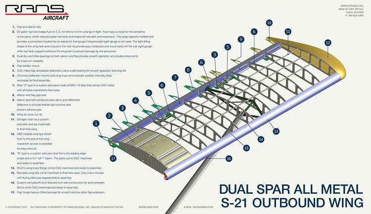

RFguy Posted August 25, 2020 Author Share Posted August 25, 2020 @Mark, another kit eh ? That extruded leading edge on the kit (Rans S-21) looks nice ! Link to comment Share on other sites More sharing options...

Kyle Communications Posted August 25, 2020 Share Posted August 25, 2020 (edited) Actually the whole wing design is fantastic. It uses a chrome molly centre truss that the wing struts come from and that truss attaches to that LE extrusion and the trailing edge extrusion. The wing essentially has 2 spars the LE and the TE Edited August 25, 2020 by Kyle Communications Link to comment Share on other sites More sharing options...
