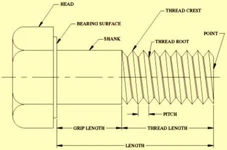

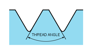

Let's see why Turboplanner has problems with metric nuts coming loose where UNF ones don't. We'll use this diagram as a reference.
1598959051840.png.88db529a8241146a7400a14f9c503dd1.png 1598959539508.png.2be7632f5cc481a45ad734e93cc43a70.png
Both an M6 and 1/4" UNF have a 60 degree thread angle, so they are the same in that respect. However, we saw earlier that the distance between two successive thread crests are different. For the M6 bolt, the pitch is 0.75 mm, while the pitch of a 1/4" UNF is 0.9 mm.
That means that for a thread length of 10 mm, the M6 has 13 V-shaped grooves, while the 1/4" UNF has 11. This means that the depth of the groove of the M6 is shallower than that of the 1/4" UNF. Or to put it the other way around, there is more contact surface between the bolt and the nut for the 1/4" UNF than for the M6.
Because there is more contact area, the friction between the surface of the thread of the bolt and the surface of the thread in the nut is higher with the UNF than it is with the M6. With greater friction, the UNF nut cannot release itself as easily as the M6 can.
This opinion assumes that both the M6 and UNF nuts and bolts are made from identical metal, and are both tightened to the same torque.
