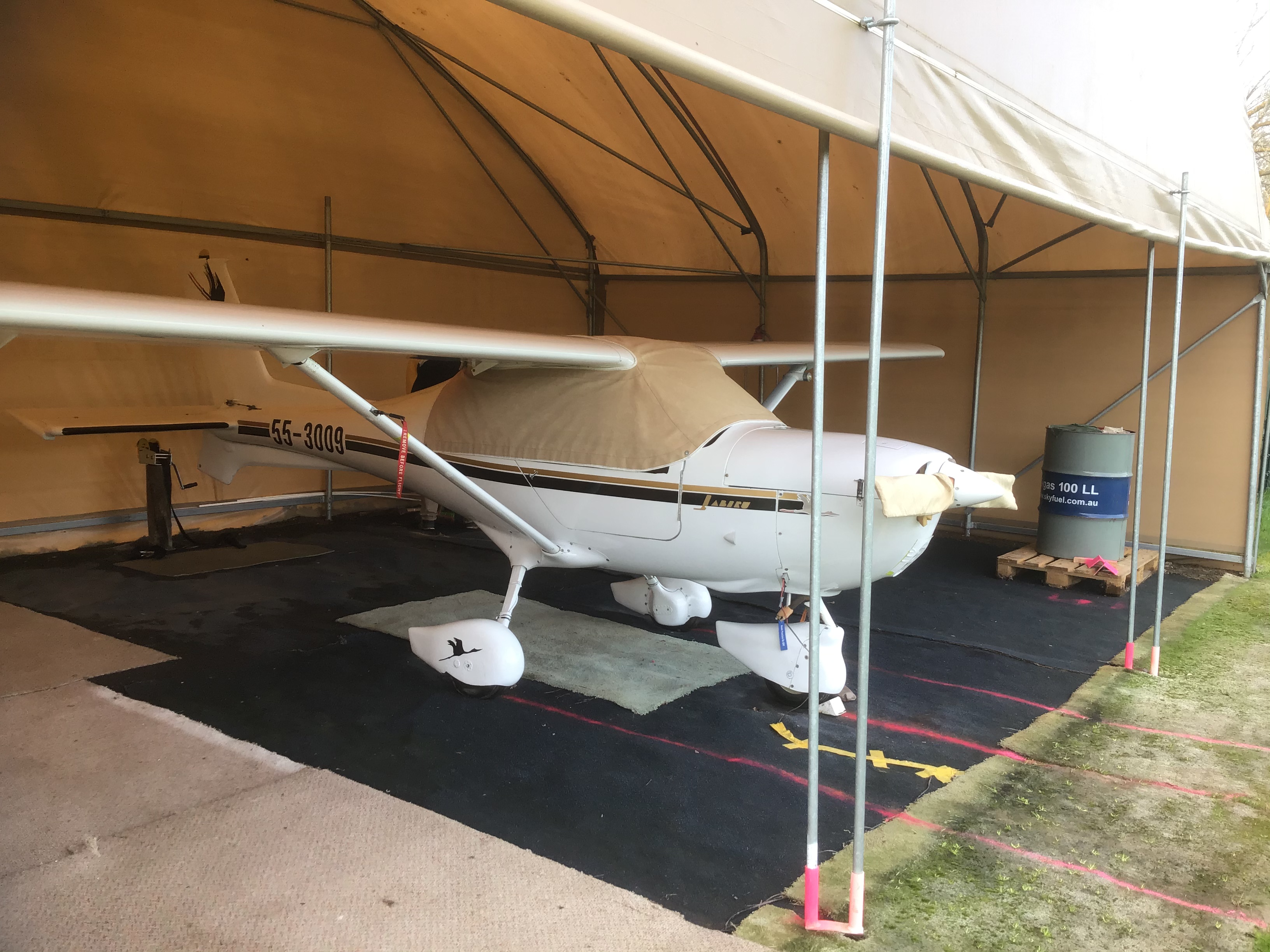

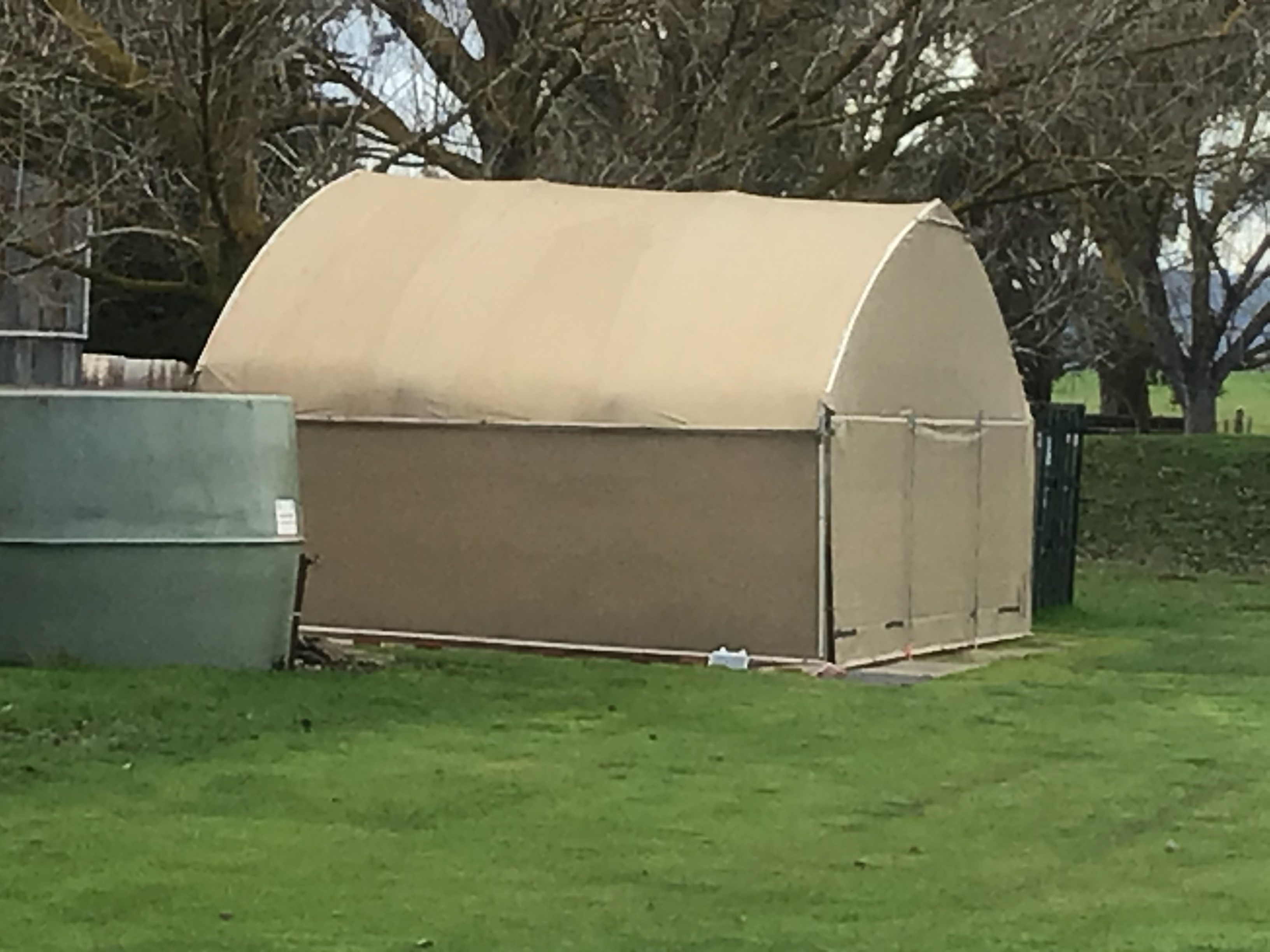

shajen Posted September 6, 2020 Share Posted September 6, 2020 I’ve had my hanger for 5 years now. It’s actually a greenhouse, but has handled all weather thrown at it. australian made, although we erected it ourselves. 9 Link to comment Share on other sites More sharing options...

old man emu Posted September 6, 2020 Share Posted September 6, 2020 Do you go forward to get out, or backwards? It's just not clear from the photos. 1 1 Link to comment Share on other sites More sharing options...
shajen Posted September 6, 2020 Share Posted September 6, 2020 We push it out, turn 90degrees away from hangar before starting it. After flying stop again 90degrees to hangar opening, turn it around and push back in. Guess you could nose or tail in, we’ve always done it this way. The hangar is augered into the ground So, in theory, isn’t a permanent structure. This is in case the councils ever start getting involved. The front is the door which rolls with a winder. There are guide poles that can be seen in photo that are removable. they are from David Gill hothouses in Bagshot, Vic. Not expensive, and can be different sizes. Mines 6m deep and 10m wide. good luck, Jenny 1 Link to comment Share on other sites More sharing options...
onetrack Posted September 6, 2020 Share Posted September 6, 2020 Interesting design, thanks for the info, Jenny. I understand that greenhouses are in huge demand today, it's a roaring business, crop protection is vital against bad weather, and they really pay off. Some of the larger vegetable growers cover all their crops completely, and some of the greenhouses run into many hundreds of thousands of dollars in cost. They look quite flimsy, but apparently they're more robust than it first appears. http://www.davidgillgreenhouses.com.au/?p=home Link to comment Share on other sites More sharing options...
old man emu Posted September 7, 2020 Share Posted September 7, 2020 Shajen, The Environmental Protection police are issuing with a caution. A wooden pallet is not a suitable bund for a 204 litre drum of avgas. Please place the drum in a bund of sufficient capacity (110% of the volume of the container) to prevent pollutants entering the soil and groundwater. 1 Link to comment Share on other sites More sharing options...
shajen Posted September 7, 2020 Share Posted September 7, 2020 Are you for real?? Link to comment Share on other sites More sharing options...

old man emu Posted September 8, 2020 Share Posted September 8, 2020 Are you for real?? I know that it seems so pedantic, but you are in the catchment area for part of the Melbourne water supply. The chances of 204 litres of avgas reaching the dam through the ground water system is probably pretty remote, and there's likely to be more pollutants coming off the roads in the area. However, I posted that half in jest, just to remind people to consider the effects of their actions, no matter what they do. Link to comment Share on other sites More sharing options...
onetrack Posted September 8, 2020 Share Posted September 8, 2020 OME does have a point. Proper fuel storage and your obligations under EPA and Worksafe regulations deem that you should have spill containment measures in place. Polyethylene spill trays and drum bunds are readily available and their cost is not prohibitive. One has to envision the worst event that could possibly happen, as regards a fuel disaster. Even though you may be extremely careful in fuel handling, one has to be aware of malicious damage by trespassers/thieves, severe storm events, and even (unexpected) drum fracture or puncturing. Vehicles can be accidentally backed into drums and hole them. I've seen a bloke back up to a 50,000L fibreglass water tank in a Landrover with his door partly open, and the edge of the door caught on the tank wall and went straight through it, promptly releasing about 30,000L of water, and nearly drowning him! There are also insurance angles you probably need to address. A fire extinguisher capable of stopping any fuel fire, should be placed within a reasonable distance of any substantial amount of fuel storage (and 200L is regarded as "substantial"). These kinds of things raise their ugly head after an "insurance event", and it pays to do a regular audit to ensure compliance with both State laws and regulations, and Local Govt bylaws, as regards fuel storage, when you have more than "minor storage" levels. Jerrycans are "minor storage"levels, 200L drums aren't. https://www.epa.vic.gov.au/-/media/epa/files/publications/1698.pdf https://www.worksafe.vic.gov.au/resources/code-practice-storage-and-handling-dangerous-goods Link to comment Share on other sites More sharing options...

onetrack Posted September 8, 2020 Share Posted September 8, 2020 OME - Spilling 200L of avgas could never be classed as a "major spill", but it does have ramifications as regards explosive vapours setting a very dangerous situation - and soaking into sandy soil means it will end up contaminating groundwater. If Jenny has a bore anywhere near the hangar, it is likely the bore water would become contaminated. Aliphhatic and aromatic hydrocarbons (including benzene, xylene and toluene) are the major ingredients of petrol, and all these are regarded as quite carcinogenic, if breathed in, or ingested via groundwater. Service station underground tank installations today involve serious efforts at preventing fuel leaks from getting into the subsoil, via double layers of geotextile, with sand between them. The sand is constantly monitored for hydrocarbons, and if any appear, the servo owner is obliged to have the tanks immediately dug up and replaced. The monitors can pick up as little as a few litres of fuel leakage. Fibreglass tanks have taken over from steel tanks as the preferred choice for underground fuel storage tanks today, due to their elimination of steel corrosion. My workshop is in a heavy industrial area of a Perth suburb. We have a main stormwater drain nearby. The drain is monitored constantly by the EPA, as the drain empties into the Swan River. Naturally, the Water Corporation has regular sumps catching pollutants that end up in the drain. What is surprising is how low the levels of contaminants are, that they can pick up. We occasionally have local Council inspectors rolling up and asking if anyone has thrown some coolant, fuel or oil on the ground in the area, as they have picked up petroleum contaminants in the drain, and are looking for the source. Link to comment Share on other sites More sharing options...

shajen Posted September 10, 2020 Share Posted September 10, 2020 Ok, OME I actually do appreciate the info and have learned quite a few things which I really didn’t know, nor had really thought about. And I did think you were half having a poke at me, but wow, my initial reaction when you said “busted ... the epa will be paying me a visit” I thought heck, are you for real. So , yeah, just a tad worried, I do know councils and govt departments can go a little power crazy? thanks everyone else for backing me up, but I do think we all should realise there’s always rules for a reason, and litigation often follows... I know I’m lucky where I am, and had a beautiful fly over mt Buller this morning. Hardly any snow left though☃️ 2 Link to comment Share on other sites More sharing options...
shajen Posted September 10, 2020 Share Posted September 10, 2020 And, yes, I will look further into my fuel storage situation. Thanks all! 1 Link to comment Share on other sites More sharing options...
old man emu Posted September 10, 2020 Share Posted September 10, 2020 I will look further into my fuel storage situation. If the drum leaks, you wouldn't want all the fuel to go to waste, would you. At least with a bund you can recover some and use it in your car or lawn mower. 1 Link to comment Share on other sites More sharing options...
