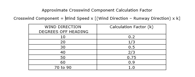

210-240 = 30, sine 30 = 0.5, so 30 kts at 210 or 270 will produce 15 kts Xwind on 240
Excellent simplification :victory:
Here's a table of conversion factors that you can use to roughly calculate the crosswind component of a wind blowing from the side of a runway heading. The correction factor has, hopefully be reported in a way that overestimates the actual crosswind. It doesn't matter if the sum (Wind Direction - Runway Direction) gives a negative number, just use the absolute value of the number.
Now we can go into another factor of the effects of a crosswind on aircraft performance - how it reduces the headwind component.
In relation to runway heading, a wind blowing directly down the centreline is at an angle of Zero degrees to the aircraft. The headwind component is given by cosine(degrees) x wind speed. The crosswind component is given by sine(degrees) x wind speed.  The value of cosine(0) is 1, and sine(0) is 0. That means that when the wind blows down the centreline of the runway, all of the wind is headwind, with no crosswind. As the angle of the wind goes from 0 to 90 degrees, the value of cosine goes from 1 to 0, meaning there is less and less headwind component.
That means that as the crosswind comes more and more from the side, the aircraft loses the headwind benefit of the wind. That's why you need to keep the Thrust up during a crosswind landing.
