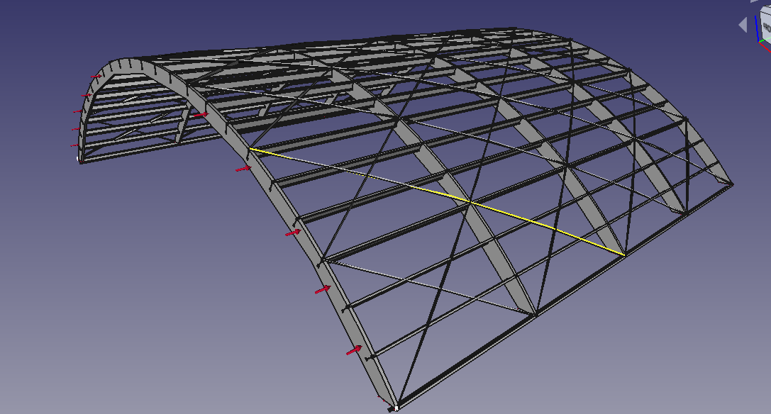

facthunter Posted December 10, 2022 Share Posted December 10, 2022 You can roll corrugated iron to much smaller radii for Bull nosed verandahs etc. Nev Link to comment Share on other sites More sharing options...
Ian Posted December 10, 2022 Share Posted December 10, 2022 Yes but that requires a custom roll and $$. Standard roofing iron is suitable for a 12m bend. Some types will do 8m without artefacts. 1 Link to comment Share on other sites More sharing options...

facthunter Posted December 10, 2022 Share Posted December 10, 2022 Expansion is a problem with single sheen and curved. Nev Link to comment Share on other sites More sharing options...
Ian Posted December 10, 2022 Share Posted December 10, 2022 3 minutes ago, facthunter said: Expansion is a problem with single sheen and curved. Nev Not sure what you meant. Arches extend easily in along their axis, changing the span is difficult, however gabled rooves suffer from the same limitation. Is it likely that you're going to buy the neighbouring block and extend, and have a neighbour willing to sell? Is it simpler to just buy a bigger site? Link to comment Share on other sites More sharing options...

facthunter Posted December 10, 2022 Share Posted December 10, 2022 The continuous sheet wants to lift of the structure when it gets hot in the sun. Nev 1 Link to comment Share on other sites More sharing options...
