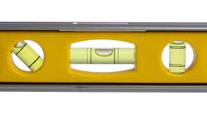

So, how does a pilot maintain that angle? In the majority of aircraft that the average private pilot would fly, there is nothing to use as a visual reference to compare the chord line with the relative wind direction. The obvious tool would be something like a bubble level set on the instrument panel when the aircraft was trestled in its cruise position, and calibrated to show position pitch angle from 0 to 20 degrees with reference to the chord angle.
Main Image
If the DIY method doesn't suit your style, you could always fit an Angle of Attack Indicator.

You put the pic, and idea, of the bubble level as a joke, right?

The spirit level won't show you the angle of attack.
The spirit level won't show you the angle of attack. For example, if you are flying steadily nose up 20 degrees with a two degree angle of attack, the spirit level would show an angle of attack of about  20 degrees. If you were pulling out of a dive, with the aircraft level, the spirit level would probably show about a zero angle of attack, but you might be about to stall.
The idea of a spirit level showing angle of attack was so silly, I really thought you might be joking. I didn't comment about you saying you might "write a paper" because I thought that you would just say that you were joking. Looks like you weren't.
It seems to me that everyone else is too polite to explicitly correct you. It's not trolling if it stops someone from reading what you write and thinking it might be true, and it's not trolling if you learn that you cannot use a spirit level to determine angle of attack.
Experience is not the issue. Things like force and velocity vectors, and mass, force and acceleration are dealt with in high school maths and physics.

In what way is discussing using a spirit level or a slip (not bank) indicator worthy of discussion about angle of attack? Particularly if said discussion says that they have anything to do with each other. As far as I can tell, OME *still* thinks that you can tell angle of attack with a slip indicator. Also, a slip indicator will not tell you your angle of bank, unless you are not turning. This is just bizarre.
Not bizarre. The problem is with the inability of a certain person to think outside the box, or to have any experiences outside their restricted world.
This is what is commonly called a builder's spirit level image.jpeg.aa69bfd49f23913756f0eec0f1cd2c11.jpegThis spirit level can be used to lay out lines in the vertical and horizontal planes as well as a line which is at 45 degrees to both the other two planes. Silly me assumed when I was talking about using a spirit (bubble)level that the reader would have had experience of using one. Obviously, in one case, I was wrong. Unfortunately, I initially chose the wrong item to illustrate what I meant by a bubble level. Consequently, I removed that image and replaced it with the image of something pilots would recognise. Unfortunately, I failed to remember that some people can only read the words and see the pictures, but cannot comprehend their deeper meaning.
So let's go into an explanation of how one would buy a slip indicator and apply it to be used as an AoA guide.
An aircraft has three planes of symmetry - vertical (yawing plane), longitudinal (roll) and lateral (pitch). A spirit level can be used to align the aircraft with reference to any one of these planes. For example, when taking measurements for the weight and balance of an aircraft, the longitudinal axis of the aircraft is aligned to the horizontal  and lateral planes. When an aircraft is aligned to those two planes, it should be in its straight and level configuration. At that time, a "slip indicator" can be fitted to the instrument panel aligned to the lateral plane. This is the usual way one of these devices is fitted and used.
However, a slip indicator can also be aligned to the longitudinal axis of the aircraft. In this configuration it becomes a "pitch" indicator. To turn it into an AoA indicator, the aircraft would be lifted by the tail until the chord line of the wing was aligned to the longitudinal plane (usually about 4 degrees nose down-tail up). Once that alignment was made, the slip indicator can be fitted to the aircraft so that the bubble is centralised. The aircraft is then returned so that the longitudinal axis is aligned with the horizontal plane. At this point the bubble should be off-centre by the same angle as the chord line is to the longitudinal axis of the aircraft. The position of the bubble can be marked on window of the indicator. This would indicate the position of the bubble when the aircraft was flying at the best AoA for Lift generation. The aircraft can then have the nose raised until the chord line of the wing is at 15-16 degrees above longitudinal plane. The location of the bubble is marked. That mark shows the position of the longitudinal axis of the aircraft when the wing will begin to stall.
So, does that clarify the use of a spirit level as a tool to monitor an aircraft's AoA ?

I would say that your basic question does sort of come back to your spirit level.
While I agree that high maths and physics ain't needed to fly a plane, the (practical) facts about pitch angle (deck angle?) are not all that simple.
For instance, the show-off pilot who does a max speed pass over a mate's house and then does a rapid pull-up may find himself stalled even though his pitch angle is well under the 'stall' sight picture he's used to. (And his airspeed well over Vs).  I imagine it as a kind of tail down longitudinal skid through the sky so that the air is not hitting the leading edge head-on but rather, in large part, from underneath which means that the angle of attack of the wing is much higher than the deck angle would suggest.  So the (simple) way I see it is that the bubble is about gravity and AoA indicators are about airflow, relative to the chord.

No. The best angle of attack will be whatever it is when the aircraft is at max weight and is flying at Vx or Vy. Most people would choose Vy as best, when total drag is at its least. This has nothing to do with the alignment of the airplane, although if the aircraft was designed well, they would coincide.
A spirit level cannot do the same thing as an angle of attack indicator because the the spirit level cannot take into account acceleration of the aircraft. If a spirit level was useful for determining angle of attack, the people would use them instead of a commercial angle of attack meter because they are far cheaper.
Just to reiterate, the best angle of attack is at Vy, where drag is at its lowest. That’s how come Vy is published and airplanes don’t come fitted with slip indicators aligned with the aircraft.
The best angle of attack for lift generation is however much lift you need, up to a maximum, at about 14° angle of attack.
The position on the spirit level will not show when the aircraft is about to stall as when an aircraft is about to stall, it will likely be accelerating and the spirit level will no longer be accurately reflecting the angle of attack. For example, if someone is recovering from a spiral dive, the aircraft could be 10° pitch up and have an angle of attack of 18° and be stalled.
Likewise, if someone is climbing or descending, the slip indicator would not reflect angle of attack. Likewise, if the aircraft was speeding up or slowing down the slip indicator would not indicate the angle of attack. It would only reflect the angle of attack in straight and level flight where the aircraft was not speeding up or slowing down - not the time when aircraft stall.
If you want to know when the aircraft is about to stall, you can mark a particular amount of control movement of the rudder (for a particular flap position).
OMEs bubble and his A of A meter would not agree with each other.

I wrote this yesterday and it never got posted, so I will just add to it.
The spirit level or OMEs builders version of it relies on the contents of the bubble being lighter than the surrounding fluid. The lightest portion rises to the top usually. The same can be achieved by hanging a plumb bob from the cockpit roof. It will give exactly the same information.
Go ahead and fit a plumb bob to the cockpit roof and fly. Do you really have to fly to see what happens or can you visualise it.
I would suggest that if you need to fly it to see the results, that you think long and clearly about where you hang that weight and how heavy it is.
Angle of attack is well defined and the definition cannot even remotely be likened to a lift reserve indicator. That can only be likened to an A of A meter. There is adifference between what you are measuring and the instrument used to do it.
