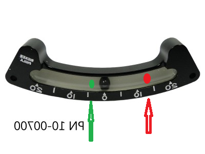

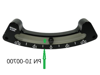

old man emu Posted January 4, 2021 Author Share Posted January 4, 2021 16 hours ago, Yenn said: OMEs bubble and his A of A meter would not agree with each other. It is very clear that nobody has bothered to read and comprehend my description of how a spirit level could be calibrated to be used as an AoA gauge. To turn it into an AoA indicator, the aircraft would be lifted by the tail until the chord line of the wing was aligned to the longitudinal plane (usually about 4 degrees nose down-tail up). Once that alignment was made, the slip indicator can be fitted to the aircraft so that the bubble is centralised. The aircraft is then returned so that the longitudinal axis is aligned with the horizontal plane. At this point the bubble should be off-centre by the same angle as the chord line is to the longitudinal axis of the aircraft. The position of the bubble can be marked on window of the indicator. This shows the position of the chord line at its best angle to the airflow to produce Lift, as concluded by the aircraft designer. (Clarification: If the longitudinal axis of the fuselage is "level", the chord of the wing will be at the AoA set by the designer - usually about 4 degrees.) The aircraft can then have the nose raised until the chord line of the wing is at 15-16 degrees above longitudinal plane. The location of the bubble is marked. That mark shows the position of the longitudinal axis of the aircraft when the wing will begin to stall. The distance between the two marks is 12 degrees, in theory. Link to comment Share on other sites More sharing options...

old man emu Posted January 5, 2021 Author Share Posted January 5, 2021 52 minutes ago, Garfly said: Also because the wind (relative or otherwise) can't get at the bubble. Why would it have to? I would like to see your reasoning for that statement. 1 hour ago, Thruster88 said: You cannot use a spirit level in an aircraft because of acceleration. That's a statement that cries out for an explanation Link to comment Share on other sites More sharing options...

onetrack Posted January 5, 2021 Share Posted January 5, 2021 (edited) Quote You cannot use a spirit level in an aircraft because of acceleration Quote That's a statement that cries out for an explanation OME - When a spirit level is used on the ground, gravity is pulling the liquid in the bubble in one direction - directly downwards. This ensures the bubble stays centred between the lines when the spirit level is level. But in an aircraft, acceleration may be getting applied to the liquid in the level (G-forces), in directions other than directly downwards. This will make the bubble travel to a different position, relative to the markings, than where it would be normally, when on the ground. Edited January 5, 2021 by onetrack 1 Link to comment Share on other sites More sharing options...
old man emu Posted January 5, 2021 Author Share Posted January 5, 2021 I see that I should have set the parameters for this discussion. 1. Flight in the airspeed range of zero to 250 kts - what the majority of private pilots use. 2. Flight below 10,000 ft on QNH - where the majority of private pilots fly. 3. Flight in the "NORMAL" category - no aerobatics beyond stalls and incipient spins, no descents at angles greater than, say, 45 degrees. Link to comment Share on other sites More sharing options...
Garfly Posted January 5, 2021 Share Posted January 5, 2021 Hi OME, I think I've tried to set out my reasoning in some earlier posts in this thread.. It may be too simple an explanation but I reckon that AoA is ONLY about airflow whilst a spirit level is ONLY about gravity (where the earth is at any given moment.) Your bubble, oriented fore and aft would indicate a true pitch angle but that wouldn't help us even fly straight and level because, after all, we can descend/climb at a zero pitch deck angle just as we can fly straight and level at a range of pitch angles. Could you explain your resistance to the idea that pitch angle and angle of attack are 2 different things? Anyone who's done skidpan training knows that the way your wheels are pointing does not equate to your direction of travel. We're not on rails when we fly. You might say we're always in a 3D skidpan, no? Why do you imagine that all AoA indicator vanes (from RC to Airliners) are stuck out in the airflow (or are clever software emulations of the same thing)? Anyway, it's always a good thread that provokes us into nutting out the basics. 😉 Link to comment Share on other sites More sharing options...
old man emu Posted January 5, 2021 Author Share Posted January 5, 2021 7 minutes ago, onetrack said: This will make the bubble travel to a different position, relative to the markings, than where it would be normally, when on the ground. Then how come we rely on slip indicators to advise us of rotation around the vertical plane (yawing) 9 minutes ago, onetrack said: But in an aircraft, acceleration may be getting applied to the liquid in the level (G-forces), in directions other than directly downwards. I think that this statement indicates a lack of understanding of Vector Analysis of Forces. Also the device is attached to the aircraft. Therefore, it is subject to the same vectors of Force as the aircraft. Link to comment Share on other sites More sharing options...
old man emu Posted January 5, 2021 Author Share Posted January 5, 2021 17 minutes ago, Garfly said: Could you explain your resistance to the idea that pitch angle and angle of attack are 2 different things? Where, Oh where, did I ever say that? We both know that the AoA is the angle between the wing (wing chord to be precise) and the direction of travel (undisturbed airflow). The angle of pitch is the angle between the main body axis and the horizon. The angle of the chord in relation to the longitudinal axis of the aircraft is set by the designer and set by the rigger. The designer normally fixes that angle so that, in straight and level flight, the angle between the longitudinal axis of the aircraft and the chord line of the wing is the same as the angle between the undisturbed airflow and the chord line of the wing. This angle is expected to result in the creation of the most Lift the aerofoil can create. The angle of pitch is controlled by the pilot, mainly by the use of the elevator/s, or control of thrust. The angle of pitch can vary from zero to 360 degrees (or 180 up and over and 180 down and around). Using the device in the way I have described provides the pilot with a source of reference for the upwards pitch angle of the aircraft. The device has been calibrated to give an indication of the angle of attack. It is never supposed to give a true, accurate reading of the AoA at any instant, but simply to give an indication of the range of AoA's in which it is possible for the aerofoil to produce sufficient Lift from the combination of aerofoil design and Thrust to counter the force of gravity and remain at a predetermined height above a reference point (the ground) Have you even read my description of calibrating a level indicating device in order to show pitch angle. If you have, but don't understand what is being done, please ask me to expand on the method. Link to comment Share on other sites More sharing options...
Thruster88 Posted January 5, 2021 Share Posted January 5, 2021 (edited) 1 hour ago, old man emu said: Then how come we rely on slip indicators to advise us of rotation around the vertical plane (yawing) I think that this statement indicates a lack of understanding of Vector Analysis of Forces. Also the device is attached to the aircraft. Therefore, it is subject to the same vectors of Force as the aircraft. Slip indicators work because they are only showing if the ACCELERATION force is parallel with the vertical axis (no slip or skid) or not. Slip indicators do not show YAW. The words used in this sentence may not be technically correct but you should get my drift. Edited January 5, 2021 by Thruster88 Link to comment Share on other sites More sharing options...
Garfly Posted January 5, 2021 Share Posted January 5, 2021 (edited) Okay, OME such a device might do service as a pitch angle indicator and be useful in your standard straight ahead stall training exercise but no more than an artificial horizon would ... or, at last resort, THE horizon. But by calling it a (quasi) Angle of Attack device you risk giving the impression that you don't accept the usual distinction between AoA and deck angle. But getting back to the thread title, in my opinion, learning about lift generation is NOT a waste of time if that learning means an intuitive grasp of the fact that stalling can happen at any pitch attitude. After all, hardly anyone gets into trouble in a light aircraft from a standard straight ahead stall. In VMC, at least, the crazy pitch angle will surely get your attention well before you fall out of the sky. This Aviation Safety article puts it well: " ... though many of the pilots I fly with understand intellectually that an airplane can stall/spin at any airspeed and in any attitude, their only practical stall experience consists of performing a contrived, wings-level stall to a Practical Test Standard. Such limited stall experience imparts little practical experience vis–vis real-world stall/spin accident scenarios. As a result, many pilots never realize just how close they may be to stalling the airplane when performing a so-called dumb stunt, or how close they may be to a stall/spin departure when skidding a turn in the traffic pattern." https://www.aviationsafetymagazine.com/features/recovery-room/ Edited January 5, 2021 by Garfly 1 Link to comment Share on other sites More sharing options...
