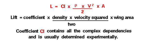

aro Posted January 5, 2021 Share Posted January 5, 2021 1 hour ago, old man emu said: Why is it critical to the practical application of piloting skills that the pilot knows that It is important to understand the effect of air density on lift. It is a critical part of performance calculations. It is also important to understand the effect of velocity - that lift available is proportional to the square of the velocity. Other than that you have wing area (a bigger wing can lift more - not complicated) and the coefficient of lift. The coefficient of lift is just a constant that allows you to tie all the other numbers together allowing for different characteristics of different wings. As for the spirit level: Imagine you are in an aircraft climbing at a 5 degree angle at 60 knots. Now you close the throttle and glide, and the aircraft descends at a 5 degree angle at 60 knots. The angle of attack remains the same if the airspeed and weight are the same. There is virtually no change in the angle of attack from the climb to the descent, but the angle of the fuselage has changed by 10 degrees. The reading on the spirit level will change by 10 degrees - more than half the typical stall AOA - but the real angle of attack has not changed. If it was possible to read angle of attack with a spirit level you can be sure it would have been done long ago - but it is not. 1 2 Link to comment Share on other sites More sharing options...

aro Posted January 5, 2021 Share Posted January 5, 2021 7 minutes ago, old man emu said: Sitting in the left hand seat commiting aviation is not the time to be doing calculations involving multiple variables. Performance calculations are often done before takeoff, but it may also be necessary to do them in flight. You don't use the lift equation in the air, but you learn it on the ground so that hopefully in the air you understand the effect of air density, the limitations when you are doing 120 knots in an aircraft with 50 kt stall speed etc. 1 Link to comment Share on other sites More sharing options...
facthunter Posted January 5, 2021 Share Posted January 5, 2021 Most of the formulea are used at the preliminary design stage. At the stall point the lift/drag ratio has gone to a bad place. Your wing has become very inefficient at providing lift. and you have more drag than a short time before. If the plane is not flying with the rudder keeping it in balance onw wing will drop before the other, When that happens the upper wing becomes unloaded and the falling one becomes more deeply stalled. IF you try to pick it up with aileron it gets worse and if you try to keep the nose up by more back stick, you are set up to spin . Nev Link to comment Share on other sites More sharing options...

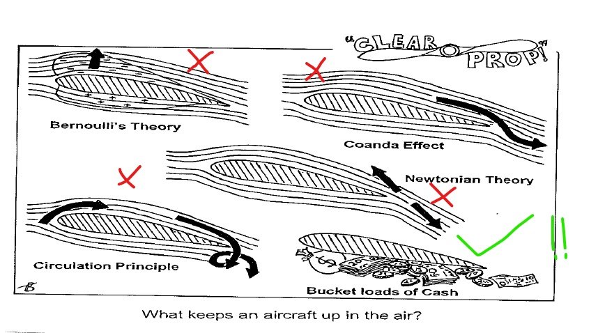

F10 Posted May 5, 2021 Share Posted May 5, 2021 No way....all these scientists lied to us...I have found the mother load....the real reason for lift beneath your wings!! 2 1 Link to comment Share on other sites More sharing options...
spacesailor Posted May 6, 2021 Share Posted May 6, 2021 Thats dead on the nail !? SO TRUE spacesailor Link to comment Share on other sites More sharing options...
facthunter Posted May 6, 2021 Share Posted May 6, 2021 You don't need to know what's causing lift to fly properly. Know what affects it (Density altitude, airspeed and angle of attack. YOU control the angle of attack with the elevators and it relates to the RELATIVE airflow. Not the horizon.. Tilt the nose down at the right rate and you will reach a point of no lift from the wing and you will float on the seat and be "weightless" At the other end of the scale put the wing at an AoA above about 14 degrees to the relative airflow and the separation of flow will cause a large loss of lift and big increase in drag. Those are the 2 limits of the wing to support you in flight and in the normal sense. (Aircraft right side up not climbing or descending vertically etc). Not so difficult to understand. YOU control the AoA with the elevators. IF it stalls it will be because of "something" you did...Nev Link to comment Share on other sites More sharing options...
