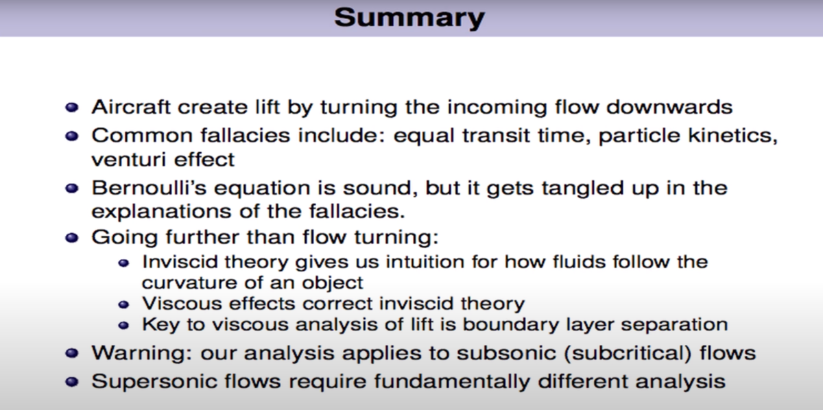

Garfly Posted January 8, 2021 Share Posted January 8, 2021 (edited) OME, in my humble opinion, you sell your research efforts short if, finally, you settle for 'because they do'. Whether a pilot needs to know the whys and wherefores or not, curious folks don't need to give up on it (even if aeronautical engineers seem confused). This video lecture suggests that they are not confused, actually; it's just that the physics of lift is too complex to reduce to simple intuitive explanations. Personally, I'm satisfied with this engineers attempt to clarify the issue. (Spoiler alert: Aircraft create lift by turning the incoming flow downwards. Not so complicated an answer, after all.) Edited January 8, 2021 by Garfly 1 Link to comment Share on other sites More sharing options...
facthunter Posted January 8, 2021 Share Posted January 8, 2021 (edited) That's ALL you need to know. Push the air somewhere and it pushes you the opposite way. Another clue. When the flow is curved, there's always higher pressure on the outside of the curve (otherwise it wouldn't bend). Airfoils or weather systems work the same , but the rotation of the earth affects the eddies in weather systems. The direction of rotation around highs (or Lows) is reversed in opposite hemispheres. Nev Edited January 8, 2021 by facthunter Link to comment Share on other sites More sharing options...
