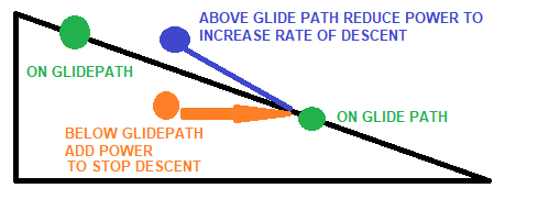

old man emu Posted January 8, 2021 Author Share Posted January 8, 2021 I'm puzzled. Let's say that we are flying a plane with a cruise speed of 80 kts and a stall speed of 30 kts IN NO WIND. Just after the turn from crosswind to downwind, the plane gets to 80 kts at cruise power for the downwind trip. At the end of downwind you make a co-ordinated descending 90 degree turn and reduce power, but maintain pitch with the elevators until you are 500' AGL. Then make another 90 degree descending turn onto Final, while maintaining the elevators in a constant position to achieve a flight line to the aiming point. If the aircraft drops below the desired flight line, then add power to stop the descent until the aircraft flies into the desired flight line. Pull power if above the flight line. At all times the position of the elevators remains constant. At the aiming point, the power comes right back and the Flare is initiated. If my technique is correct, and I'm open to correction, how can this description of the way a student has been taught to land a PA-28 be correct? Holding steady at 70kts down final on an even profile with the plane trimmed sets us up in the correct configuration without having to fiddle with power changes too much. But reaching the point where we need to start slowing down to get back to 66kts over the threshold is where it gets busy as I pull back on the power and simultaneously increase back pressure to maintain a straight approach path. Am I wrong in thinking that one sets the pitch angle to a desired flight line with the elevators and maintains the flight line with thrust? Link to comment Share on other sites More sharing options...

facthunter Posted January 9, 2021 Share Posted January 9, 2021 OME If you are maintaining a glide path at 70knts (stabilised) and you reduce power to slow a bit you have less lift at the slower speed and will drop below the path if you don't keep the lift the same (equal to the weight) by increasing the angle of attack as you do throughout the flare. At the beginning of the flare you need a bit more lift to arrest the sink rate. Some times ground effect will achieve that for you, but don't count on it if it's your first try on that particular plane. Nev 1 Link to comment Share on other sites More sharing options...
old man emu Posted January 9, 2021 Author Share Posted January 9, 2021 1 hour ago, facthunter said: If you are maintaining a glide path at 70knts (stabilised) and you reduce power to slow a bit you have less lift at the slower speed and will drop below the path I fully agree with that statement as it stands. However, if the glide path has been established at a determined speed and with a certain engine RPM, if, due to some mistake in setting up the glide path, or an unexpected upsetting force (gust, shear) and the aircraft goes either above or below the desired glide path, then the glide path can be regained closer by the manipulation of THRUST. Look at this side-on circuit depiction. The final leg,, or glide path to runway, can be described as the hypotenuse of a right triangle. http://1.bp.blogspot.com/-_FDfiTi7M_8/VBcwypahL-I/AAAAAAAAAEY/e4AfvWBh3kk/s1600/basic_circuit_profile.gif Here's a depiction of a plane flying that glidepath to the runway. The green dots represent the aircraft at points along the desired glidepath, with attitude and power set. The orange dot represents the aircraft a little closer to the runway, but it has gone below the desired glidepath for some reason. To stop making matters worse, the pilot increases THRUST which stops the descent until the actual flight path intersects the desired glidepath at the lower green dot. Then the extra THRUST is removed and flight on the desired glide path continues. The Blue dot represents the aircraft that has risen above the desired glidepath for some reason. The aircraft can be returned to the desired glidepath by increasing the rate of descent by reducing THRUST until the actual flight path intersects the glidepath at the lower green got. Then the THRUST is returned to the level it was at the first green dot. In other words, instead of pushing and pulling on the elevator controls, they are left untouched, but the throttle is the control that is pushed and pulled, until it comes time to flare, when it's pull back on both. Yes. I know I am describing the "normal" landing approach where THRUST is available. I fully agree that a deadstick landing would be conducted using the elevators. 2 Link to comment Share on other sites More sharing options...

Tigershark21 Posted January 9, 2021 Share Posted January 9, 2021 5 hours ago, old man emu said: I'm puzzled. Let's say that we are flying a plane with a cruise speed of 80 kts and a stall speed of 30 kts IN NO WIND. Just after the turn from crosswind to downwind, the plane gets to 80 kts at cruise power for the downwind trip. At the end of downwind you make a co-ordinated descending 90 degree turn and reduce power, but maintain pitch with the elevators until you are 500' AGL. Then make another 90 degree descending turn onto Final, while maintaining the elevators in a constant position to achieve a flight line to the aiming point. If the aircraft drops below the desired flight line, then add power to stop the descent until the aircraft flies into the desired flight line. Pull power if above the flight line. At all times the position of the elevators remains constant. At the aiming point, the power comes right back and the Flare is initiated. If my technique is correct, and I'm open to correction, how can this description of the way a student has been taught to land a PA-28 be correct? Holding steady at 70kts down final on an even profile with the plane trimmed sets us up in the correct configuration without having to fiddle with power changes too much. But reaching the point where we need to start slowing down to get back to 66kts over the threshold is where it gets busy as I pull back on the power and simultaneously increase back pressure to maintain a straight approach path. Am I wrong in thinking that one sets the pitch angle to a desired flight line with the elevators and maintains the flight line with thrust? You're correct Emu, Here, thrust is your true elevator, and your elevator (and trim) is your speed control which is maintained by varying the wing's angle of attack at a given thrust in order to hold a given attitude at a given speed in either a climb, level flight or a descent unless the critical angle is reached. Link to comment Share on other sites More sharing options...
facthunter Posted January 9, 2021 Share Posted January 9, 2021 (edited) There were 2 different situations there so why discuss both at the same time? Of course if you fall below the glide path you need extra power to regain it UNLESS you are also too FAST where you can use that energy instead.. I can't see why all this has to be so difficult. Gaining height requires energy be added (all other things being equal) You can't obtain potential energy( Height,) without contributing another form of energy to the situation. In this case power from the engine, but power changes can produce different pitching forces as does a change of airspeed so that has to be managed as well. IF the power applied just increased the airspeed you don't necessarily regain the glide path just by opening the throttle.. You would just be going faster That's the "all other things being equal" bit. Nev Edited January 9, 2021 by facthunter 1 Link to comment Share on other sites More sharing options...
old man emu Posted January 9, 2021 Author Share Posted January 9, 2021 1 hour ago, Student Pilot said: .I don't understand the theory, does that make me a bad pilot? I wonder why no one has shot back at me, "Those who can, do. Those who can't, teach." 33 minutes ago, facthunter said: IF the power applied just increased the airspeed you don't necessarily regain the glide path just by opening the throttle. In this case, the aircraft was happily coming down the glidepath at the desired speed, not too fast, not too slow, just right. You know, Newton's First. Then something happened to knock it off the desired path. Newton's Third. What I'm saying that you don't shove the throttle knob to the wall and get the aircraft speeding up. You give it a nudge to halt the descent until, by flying parallel to the original track over the ground, you intersect the desired glidepath and re-establish the desired airspeed by un-nudging the throttle. A side issue that has struck me in this discussion is that there does not seem to be a method taught by all instructors for carrying out flight down the glidepath that is consistent with all. From responses here, some have been taught to control descent with elevators and some have been taught to use the throttle. Is it any wonder that discussions reach no end? Link to comment Share on other sites More sharing options...

facthunter Posted January 9, 2021 Share Posted January 9, 2021 You are flying along maintaining a certain level. What do you control airspeed with? Power of course. You are descending on a fixed glidepath. The same applies. So in those instances speed is NOT controlled with elevators. IF you are gliding, Power is not in the equation so you control it with rate of descent. If you are in a steep turn with full power on and the speed is too low all you have left is to commence a descent at a high enough rate to get the Airspeed you NEED ie use pitch change causing a higher RoD to increase airspeed. OR reduce the bank angle and reduce drag. and lower your safety speed required too. This is all about flying your plane properly and not thinking "is speed controlled with elevators or Power? Well, it really DEPENDS on the particular situation you are in Doesn't it so you use what you have to WHEN you need it. So it's a silly question, in my view. I've mentioned many times the concept of considering energy in all this. It's not something new, but I must be writing in invisible ink sometimes. .NEVER been one question about it. You are climbing out in your lead slug Mk1 and it's a warm day and you notice the airspeed is a bit low. You check you have full throttle and maybe that both switches are on Carb heat off. flaps UP and its still slow and you've stopped climbing. Then you have only one thing, lower the nose carefully till you have a safe speed THEN see what you can do next if climbing is out of the question.. Nev 1 Link to comment Share on other sites More sharing options...
Jase T Posted January 9, 2021 Share Posted January 9, 2021 Nev dont make me hit you over the head with my Trevor Thom BAK manual from 1985... P+A will ALWAYS = P Power - not throttle position but the power your engine is capable of producing at that instant in time all things considered (including DA, age, set up etc etc etc) plus Attitude - the one you have set or just adjusted to Equals Performance - a combination of IAS and rate of climb / decent. You may need a specific one to avoid a stall or to climb out before an obstacle or to meet a touchdown point. If you are not getting the performance you want you need to change one or both to get it... If you have no more P you need to use A to give you the best you can get. If you want S&L and a different IAS you need a completely different P and a completely different A you cant just increase power.... as an ab initio pilot you learned "Change, Check, Hold, Adjust, Trim" or something similar when changing something but as your experience improved you "sort of do them all at the same time" but the P+A=P rule still applies. It applies in a climb, in a descent, in a turn, in a steep turn and on approach.... 1 Link to comment Share on other sites More sharing options...

bull Posted January 9, 2021 Share Posted January 9, 2021 3 hours ago, old man emu said: I wonder why no one has shot back at me, "Those who can, do. Those who can't, teach." In this case, the aircraft was happily coming down the glidepath at the desired speed, not too fast, not too slow, just right. You know, Newton's First. Then something happened to knock it off the desired path. Newton's Third. What I'm saying that you don't shove the throttle knob to the wall and get the aircraft speeding up. You give it a nudge to halt the descent until, by flying parallel to the original track over the ground, you intersect the desired glidepath and re-establish the desired airspeed by un-nudging the throttle. A side issue that has struck me in this discussion is that there does not seem to be a method taught by all instructors for carrying out flight down the glidepath that is consistent with all. From responses here, some have been taught to control descent with elevators and some have been taught to use the throttle. Is it any wonder that discussions reach no end? I,m an old AUFmember and was taught by an instructer in one of the first produced 2 seat thruster gemini,,,,,,And the procedure we where taught was ALL landings and circuits are set up on late downwind as if the fan had stopped,,,,,,ie:All landings where set up for deadstick /failed engine,,,,,So when it happened you would always have speed and height to land the plane ........................... 2 Link to comment Share on other sites More sharing options...
