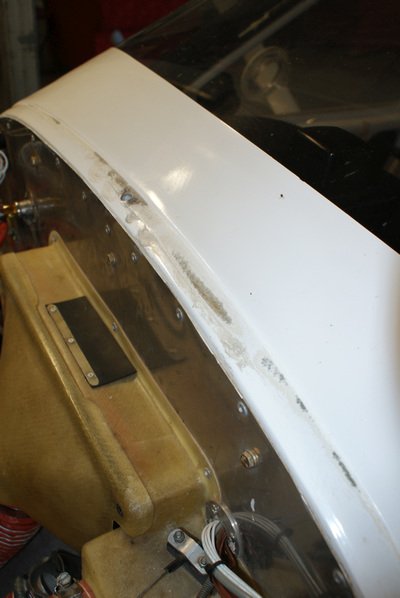

RFguy Posted January 17, 2021 Share Posted January 17, 2021 What's the best cure for this ? Repaint the affected areas and use some soft ablative felt? or teflon adhesive tape interface ? -glen Link to comment Share on other sites More sharing options...
Tasmag Posted January 18, 2021 Share Posted January 18, 2021 I just used self adhesive loop side of velcro, no rubbing and gives a better air seal. Mike Link to comment Share on other sites More sharing options...
RFguy Posted January 18, 2021 Author Share Posted January 18, 2021 Hi Mike thanks for the input. yeah the air seal is of course important. Link to comment Share on other sites More sharing options...
