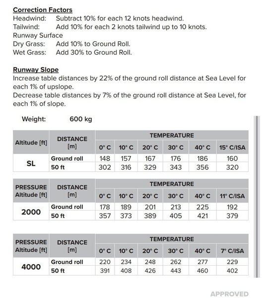

aro Posted January 24, 2021 Share Posted January 24, 2021 1 hour ago, APenNameAndThatA said: Thank you for at least thinking about what I was asking. My question was as follows. If the MTOW is 600 kg on a normal day, should the weight be decreased on a really really hot day because performance will be less. Seems like a perfectly interesting question. One answer is "No, DUH, or it would be in the POH". It is definitely valid to decrease weight for an airport that is hot or high. GA aircraft will normally have performance charts that allow you to figure out whether you can take off or land in the space available at a specific weight. If the answer is no, one solution may be to reduce weight. The same applies to any aircraft, however it is more difficult if there are no performance charts for weight. It is still good to be aware of the problem. You can't use the same logic to increase weight because you don't know the limiting factors for MTOW. 1 1 Link to comment Share on other sites More sharing options...

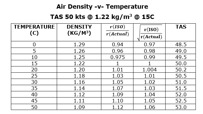

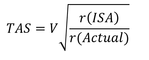

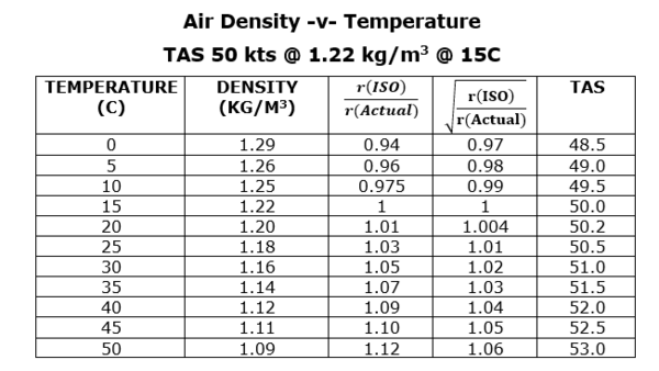

old man emu Posted January 25, 2021 Share Posted January 25, 2021 Back to the Algebra, but this time I've done the arithmetic for you. We'll start with old mate, Lift formula: Lift = {1 x (density x TAS)^2 x 1} /2 The amount of Lift we are going to get is dependant on two variables - the density of the air in which the aircraft is operating and the True Airspeed in air in which the aircraft is operating. Let's look at TAS. Where V = Indicated Airspeed r(ISA) = air density in ISA (103.2 1013.2 mb and 15C) = 1.22 kg/m^3 r (Actual) is air density in which the aircraft is operating. From this equation, the following table can be constructed: The next step is to calculate the difference in Lift between that generated at ISA to that generated at higher temperatures. Where: r = Actual air density TAS = True Airspeed k = (Coefficient of Lift x Wing Area) all the things we must acknowledge but do not vary, so we give them a value of one (1) Can I have a rest now? Link to comment Share on other sites More sharing options...
Jabiru7252 Posted January 25, 2021 Share Posted January 25, 2021 No, you cannot have a rest. Go fix your typos. You typed 103.2mb instead of 1013.2mb. 🙂 Link to comment Share on other sites More sharing options...
old man emu Posted January 25, 2021 Share Posted January 25, 2021 2 minutes ago, Jabiru7252 said: Go fix your typos. I have. Now can I go, please Sir? It's lunch time and my mates want to play marbles, but I lost mine. 1 Link to comment Share on other sites More sharing options...
