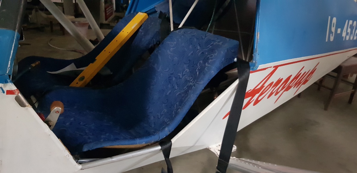

Jim McDowall Posted November 12, 2021 Share Posted November 12, 2021 Can anyone supply a picture of the factory supplied Supa Pup mk4 seat? Link to comment Share on other sites More sharing options...
jackc Posted November 12, 2021 Share Posted November 12, 2021 Have you tried Rollo at Aeropup Gympie? Link to comment Share on other sites More sharing options...
Flightrite Posted November 13, 2021 Share Posted November 13, 2021 I imagine it’s the same as the Aeropup? Sure looks like it to me. Link to comment Share on other sites More sharing options...
jackc Posted November 13, 2021 Share Posted November 13, 2021 This is one of my Aeropup seats…… 1 Link to comment Share on other sites More sharing options...
Jim McDowall Posted November 13, 2021 Share Posted November 13, 2021 Thanks for the info and pics. Will track down a local Aeropup and have a look but at first glance the Aeropup seats do not match the drawings in the Supa Pup builders manual. Link to comment Share on other sites More sharing options...
