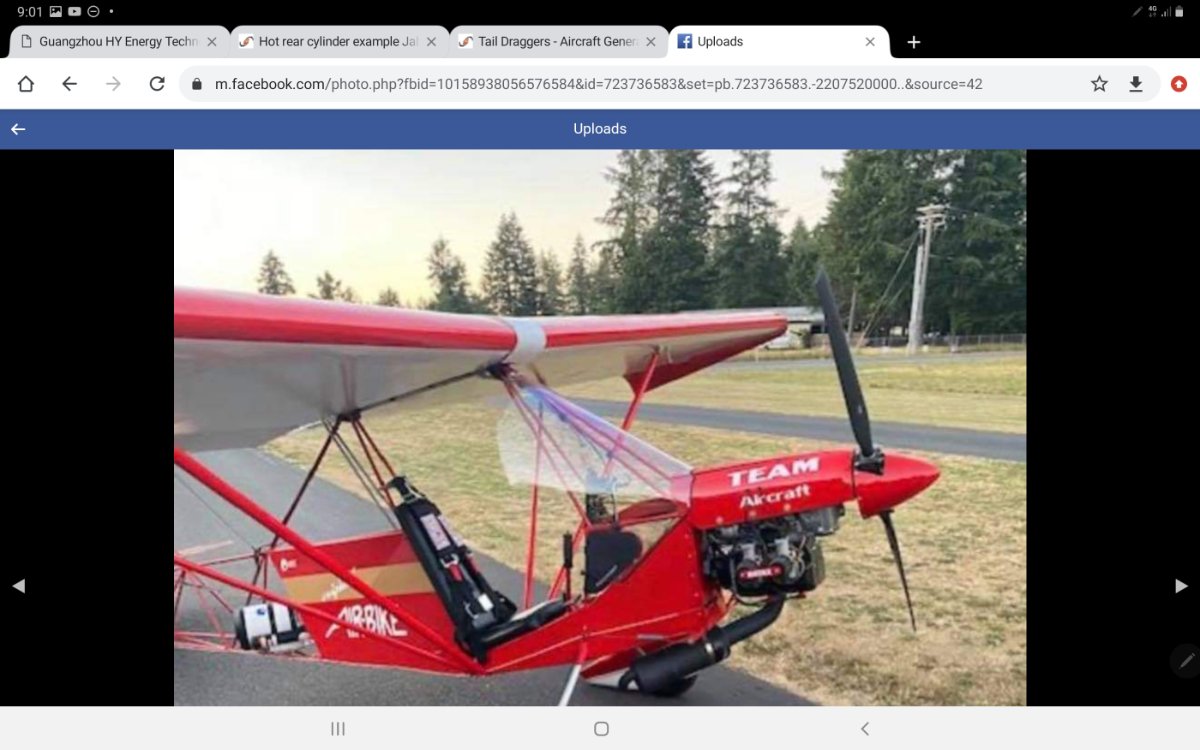

Mike Gearon Posted February 19, 2021 Share Posted February 19, 2021 11 hours ago, bushcaddy105 said: (And yes, I have ground looped as promised!) As a future ground looper I'm bringing this airbike to Australia. Was going to send to Philippines and that was a good plan until Covid.. I'd have daily done tail wheel conversion there in the Angeles flying club drifter. I'm in Melbourne until Covid vaccinated.... Say 3 months.... flying out of Tyabb and Tooradin and don't know of any LSA options at these locations with tail wheel. Any options anywhere in Australia? Not far from being able to travel in the Skyranger as needed. 1 Link to comment Share on other sites More sharing options...
Thruster88 Posted February 20, 2021 Share Posted February 20, 2021 2 hours ago, Mike Gearon said: As a future ground looper I'm bringing this airbike to Australia. Was going to send to Philippines and that was a good plan until Covid.. I'd have daily done tail wheel conversion there in the Angeles flying club drifter. I'm in Melbourne until Covid vaccinated.... Say 3 months.... flying out of Tyabb and Tooradin and don't know of any LSA options at these locations with tail wheel. Any options anywhere in Australia? Not far from being able to travel in the Skyranger as needed. For tail wheel training Dan Compton, Wings out west at Dubbo has a very good reputation and beautiful cub aircraft. 1 2 Link to comment Share on other sites More sharing options...
