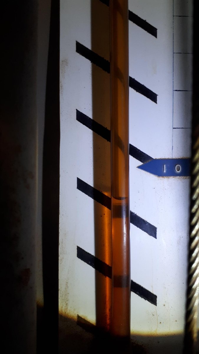

Thruster88 Posted February 27, 2021 Share Posted February 27, 2021 To make it easier to see the fuel level in the Thruster I put angled strips on white plastic behind the pvc tube, refraction? Changes the angle with fuel. Sight tube has to be close to plastic. Need to replace my tube as well. 2 Link to comment Share on other sites More sharing options...
Yenn Posted February 27, 2021 Share Posted February 27, 2021 The angled strips is an old design, use yellow and black diagonals to stand out well. 1 Link to comment Share on other sites More sharing options...
