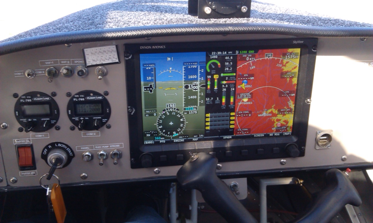

Flightline 760A looks like a choice for me, I will leave the mounted hand held in and then I have 2 radios, but need 2 antennas.
I guess it may be handy IF one radio goes down, I can use the second one.  The 760A is now about $1495 on Sky Shop, not sure IF that includes wiring harness?

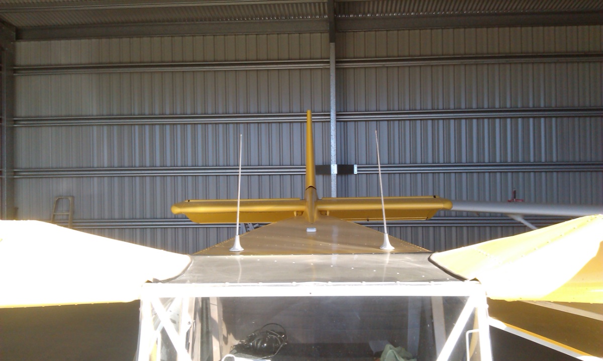

I have 2 antennae but not being a radio man I wonder if it is possible to use a Y splitter like you can put on a television antenna?
42 minutes ago, Kyle Communications said:
NO !!!!!!!  separate antennas spaced as far apart as possible
I have an antenna on the turtle deck, but will fit my second one on the bottom side of the fuselage.

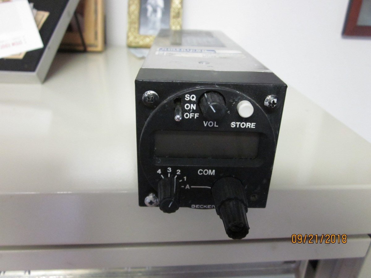

Have a look at the classifieds at www.seglflug.de. As Europe has abandoned 25kHz spacing there are many good radios coming out of gliders. I have installed 2 Becker 4201 at a cost of $3-400 each. They fit in a 21/4 hole.
Well I bIt the bullet. I went for the older AR3201 . doesn't have the two frequency 'toggle' feature like the 4201 but has 4 positions to store frequencies. That'll do me. Cheap as chips 🙂
Thanks again for the heads up!
Sounds good. You can always upgrade later. Make sure you fit a good ground plane don’t rely on frame and best quality coax and antenna.
Yeah, I figured that since it has four spots to save frequencies once I am used to setting and saving them it won't be much different to the more modern type of radio. Position A is current frequency and then that can be saved into one of the four. I figure people have been flying successfully that way for decades, in way heavier airspace than I will be flying in! Right now I haven't even done any Navs so if this plane ever gets finished soon I aint goin anywhere far anyway 🤣
