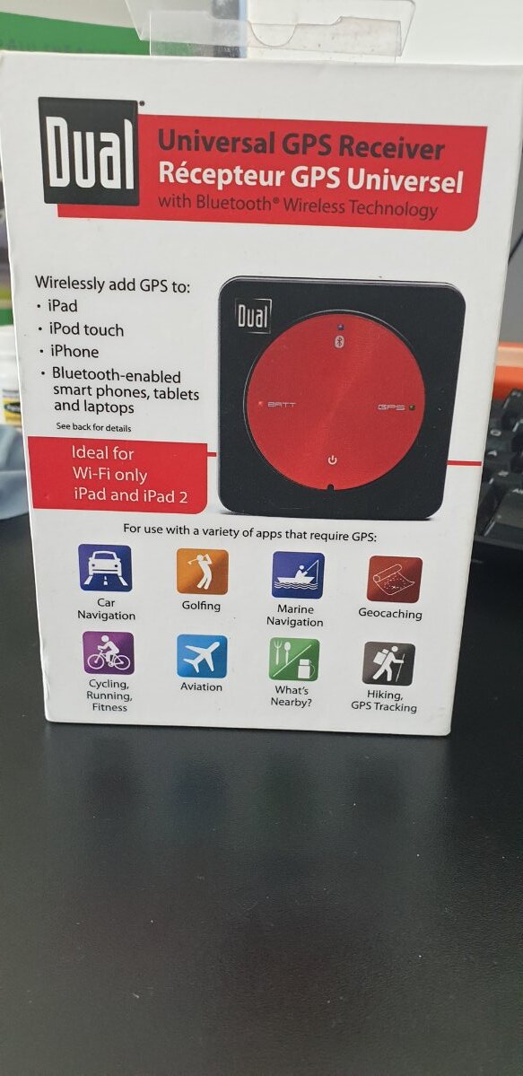

shafs64 Posted March 29, 2021 Author Share Posted March 29, 2021 This is the one i picked up on the cheap from FB sales Link to comment Share on other sites More sharing options...
Yenn Posted March 30, 2021 Share Posted March 30, 2021 Don't all iPads have a built in GPS, mine does and it is not a new one. Avplan worked OK without a sim card, but I don't think it would transmit my location without a card. Link to comment Share on other sites More sharing options...
tillmanr Posted March 30, 2021 Share Posted March 30, 2021 (edited) IPads without cellular data function don’t have GPS built in. Edited March 30, 2021 by tillmanr Spelling Link to comment Share on other sites More sharing options...
cscotthendry Posted March 30, 2021 Share Posted March 30, 2021 Further to what tillmanr posted, if your ipad can take a sim card, it has inbuilt GPS. You don't have to have a sim card in it to use the GPS though. If your ipad doesn't have a sim card facility, it doesn't have the GPS circuitry and you'll need an external GPS unit to use it. Phones have the GPS circuitry and you might think that bluetoothing to the phone will allow you to use the phone's GPS. It works, but not very well. The phone will only send GPS updates about every 30 seconds to a minute apart. BTDT. I bought a “cheap” ipad (without the sim) to replace my old failing one. I saved about $200... Then realised that I'd have to spend about that much for the external GPS. The people in the apple store were VERY keen to sell me that ipad. Too bad they didn't tell me about the GPS.😡 1 Link to comment Share on other sites More sharing options...
MattP Posted March 31, 2021 Share Posted March 31, 2021 Good point Scott, I’d forgotten about the lack of gps on wifi only iPads. For the $200 difference I’d just buy the stratux kit, build it and then you get gps and ADSB in and the traffic on OzRunways from it too. I’ve found using that also helps the battery on the iPad out a lot, although tbh it can be a pain to remember to bring along when renting as at least the iPad gets remembered due to me using it to plan and submit notifications. 1 Link to comment Share on other sites More sharing options...
