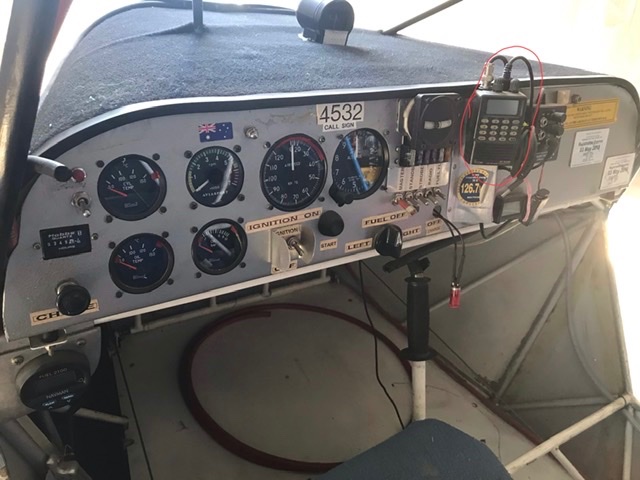

jackc Posted April 3, 2021 Share Posted April 3, 2021 Wondering what setup people have for throttles control panel mounted for left and right seats? Mine has only one lever mounted near left knee at lower height door frame. i need dual throttles....... Link to comment Share on other sites More sharing options...

Blueadventures Posted April 3, 2021 Share Posted April 3, 2021 Ok. You could set up two push pull throttles onto levers on a torque tube inside the panel then another lever will move your existing throttle method. That’s the method I am using. You can see in the Skyranger Nynja build how this works. They have both push pull and a lever set up. Hope this helps. 1 Link to comment Share on other sites More sharing options...
jackc Posted April 3, 2021 Author Share Posted April 3, 2021 24 minutes ago, Blueadventures said: Ok. You could set up two push pull throttles onto levers on a torque tube inside the panel then another lever will move your existing throttle method. That’s the method I am using. You can see in the Skyranger Nynja build how this works. They have both push pull and a lever set up. Hope this helps. https://www.aircraftspruce.com/catalog/appages/rotaxdualthrottle.php These were the units I was looking at, was trying to work out how to connect them......with your method I just need two single pull throttles to the torque tube and run 2 cables from it, to the carbies? Link to comment Share on other sites More sharing options...
