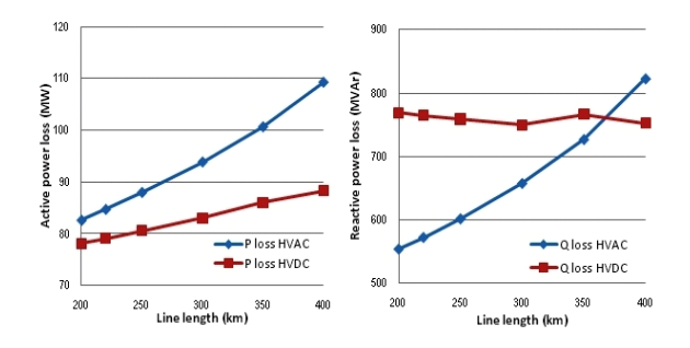

It is academically true that there is a power loss if you generate in one location and supply to another, but the task is to get the job done, and it's a fact that on a stinking hot day in a couple of states when South Australia has used up its 50 minutes of Big Battery, and when 40 years of "renewables" power paid for by us taxpayers is producing only 1% of Peak Power required up the east coast, it's quite possible that the people of Adelaide are being powered by several Sugar Cane Mills around Cairns. They don't send the power to Adelaide, they send it into Carins which sends its power down the grid and so on until there's enough surplus power in Victoria to supply Adelaide, so while the theory is correct and the ideal is to generate power where it's used, in real life someone will come up with work arounds to get the job done.
Haven't you just repeated what was stated on the first line. I think that we're saying the same thing.
Also, from a mathematical perspective, in terms of losses isn't the cascading loss pretty much the same as the loss when sending the power direct as AC power loss is pretty much linear with HVAC? See graph below.
Basically it's far more efficient, and generally cost effective to spool up local power.  The national grid provides stability in a crunch however it does it inefficiently giving you time to spool local power. Otherwise you have a Texas style event which is far more expensive.
The graphs below compare AC and DC
However if power is very cheap (think Solar) you don't care as much about losses it becomes more reasonable, however the capacity of the links themselves are costly, about 1 Billion for the HVDC link between France and the UK. So basically even with very cheap power a long way away you still have an issue.
Anyways this is a way away from airplane fuels and whether Hydrogen is a good or bad fuel. Personally I think that Hydrogen is a pretty silly fuel for plane for the following reasons.
In theory, yes, but practically, no. Without the Queensland Sugar Mill power, on a very hot night up the east coast, Adelaide would be blacked out, even though is has a Big Battery/Wind Farm at Hornsdale, just 239 km away.
On that theory, every town and city should have its own power station to minimise transmission losses, and that used to happen up into the 1950s, but the cost of power to the cosumer was far cheaper using a grid with losses.
