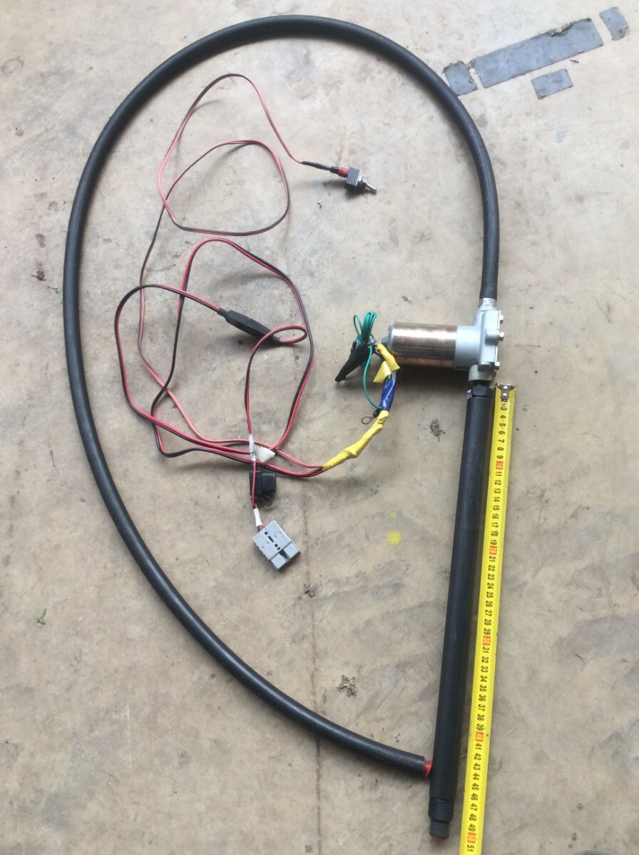

Walrus me old mate! I & many others have already posted suggestions on this: I have been using this home made vain pump for some years now. Completely removes the need to lift "jerry" cans. I plug into "ship" power (Anderson plug). You will still need a light folding step to reach up to the over wing filling point, there are lots of options out there. I plug the open end of hose & spear(polly riser) when not in use. The spear can be easily removed to take up less room in the aircraft. The pump (a Chinese Holly copy) is self priming. Whole thing cost about $90. I would also sugest the use of a filter funnel - I made my own but you can purchase a "Mr Funnel."
That looks cool! What type of pump is that? Superchreap Aeronautics or Range & Endurance Performance Co seem to only sell the solenoid type? Is that a fuel pump or some other fluid pump? Where do you get them? I mounted my Mr Funnel, onto a piece of foam backed plywood, so at least it sits upright on the wing, unaided. No more training my pet octopus to fuel out of a can, hold the funnel, hold the can, hang onto the wing, wipe spilled fuel before it runs over the rear deck Lexan windows, re-attach the bonding clamp........

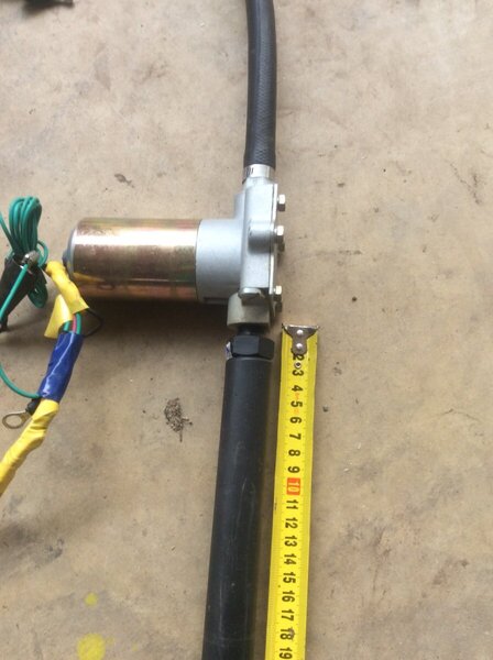

Hi F10,
The pump is a Chinese copy of a Holly (USA) high performance fuel/petrol transfer pump - used in muscle car type applications. So it's a genuine petrol (as apposed to diesel) fuel pump. Cant remember the performance statistics but I find it empties a 20 L container in a very few minutes. For the best price,  find them on line in the $60-80 bracket (a genuine Holly is in the many $100's).
Yeah! Mr Funnel has 3 drawbacks - 1. high price, 2. hard to find a stable position, 3. they retain a few mm of petrol/water i the "sump" that inevitably spills onto something you dont want it to.
One of the good points of my pump is that you can hold the fuel delivery end in one hand, the other hand can hold the on/off switch & steady the funnel.
I did try having an "in line" filter on the pump suction side but it cut down the delivery volume a bit too much and the filter was to big to fit into some of my fuel containers.
