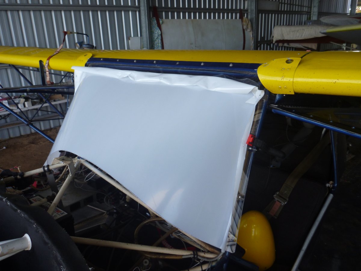

Blueadventures Posted May 11, 2021 Share Posted May 11, 2021 F10 I’ll did up an image or 2 when I changed mine out years ago. Cheers. 1 Link to comment Share on other sites More sharing options...

Blueadventures Posted May 11, 2021 Share Posted May 11, 2021 Link to comment Share on other sites More sharing options...

Blueadventures Posted October 1, 2021 Share Posted October 1, 2021 1 minute ago, F10 said: Looking good! Like your yellow wings and blue fuselage, always enjoyed that US Navy type colour scheme. Yep the problem is that small radius curved area near the wing leading edge pins….I can appreciate you can get stress cracks there over time. Haven’t got around to this yet, not a big priority at this stage. I see it appears you have modded your fuel tank breather pipes, facing into wind. I think the original design is quite good but has tight tolerances so needs checking for blockages. I always blow through them to check. I have heard some Gazelles can suck fuel from one tank more than the other, which can be a bit worrisome in flight! The old one is the stress cracked one, the new was all good. Very easy cut and fit. Link to comment Share on other sites More sharing options...
F10 Posted October 1, 2021 Author Share Posted October 1, 2021 (edited) Ok! So confirm, Lexan, about 3 mm thick? 1 m square? Edited October 1, 2021 by F10 Link to comment Share on other sites More sharing options...
Blueadventures Posted October 1, 2021 Share Posted October 1, 2021 12 minutes ago, F10 said: Ok! So confirm, Lexan, about 3 mm thick? 1 m square? Not sure of size, as in image bought an over size piece and cut out of that. Link to comment Share on other sites More sharing options...

Blueadventures Posted October 1, 2021 Share Posted October 1, 2021 27 minutes ago, F10 said: Yep, I planned to use the old screen as a template. But thickness, I recon about 3mm? I think it was 2mm from memory. I did same for same thickness. You will see when you have the cowl off as you will see the thickness. Link to comment Share on other sites More sharing options...
