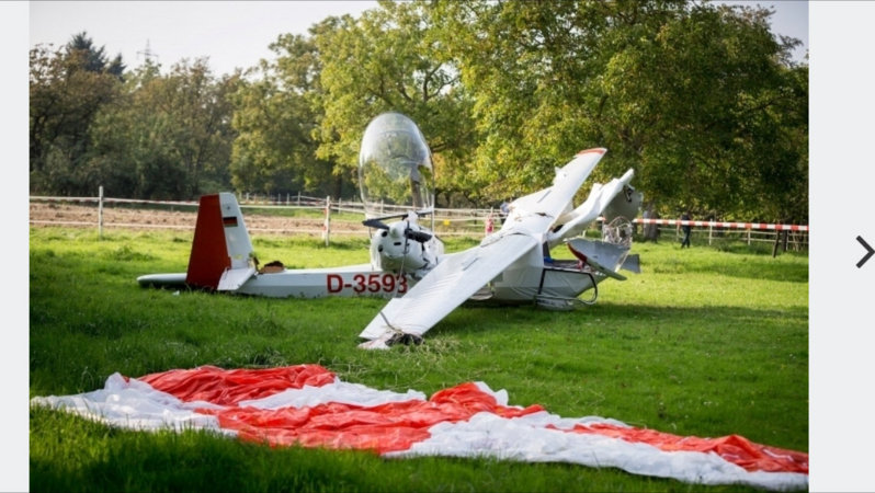

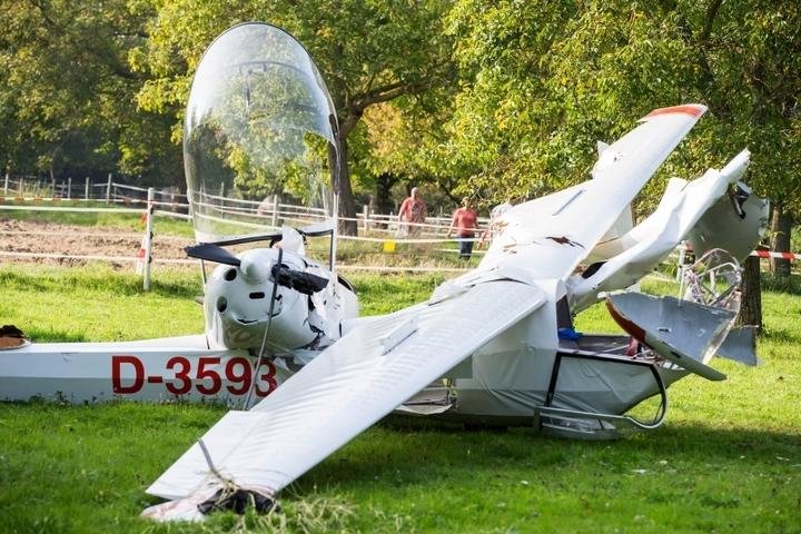

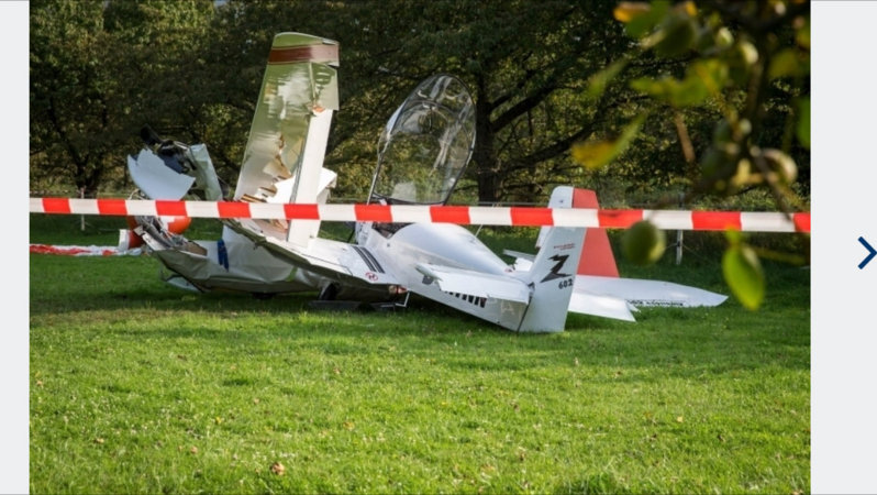

Garfly Posted May 15, 2021 Author Share Posted May 15, 2021 (edited) Sure, you'd expect that mid-air collisions might damage BRS systems, causing them to fail - and that's no doubt happened. On the other hand, there was that memorable incident in Germany, in Sept. 2014, where a Zenair locked loins with a glider - parallel runways again - and both aircraft descended under a single canopy saving all three souls. Go figure. This is how it was reported on another forum at the time: "Hey guys at Sky Ranger Group. We had a midair collision this weekend in Koblenz Winninden between a glider with 17yrs old pilot and a microlight Zensir 601. Both wanted to land at the same airfield on parallel runways. In as far as I heard 200 mtr height (600 ft AGL) they collided and stuck together. Why did I tell you this? Apart from the fact that midairs often happen around airfields and one should be careful and use the radio propperly... The Zenair was equipped with a rescue system. The pilot immediately fired it up and both aircraft, still stuck to each other and all 3 passengers safely landed on that one parachute.... See the pictures. I found it curious, what has been posted here, questions of rescue system coming up several times. BTW: In Germany a rescue system is mandatory to have in micro lights... Best regards and always happy landings, Volker Engelmann." Edited May 15, 2021 by Garfly Link to comment Share on other sites More sharing options...
