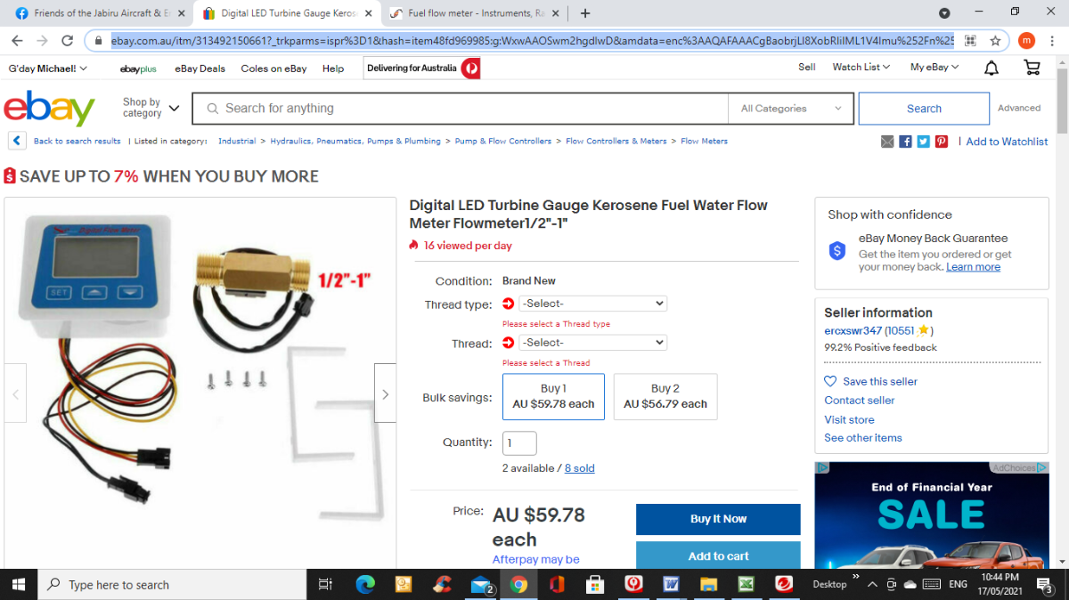

I have seen cheap about $60 ones on ebay that may give an indication of flow; I have no idea of quality.  Cheers
5 minutes ago, cherk said:
Wow! that's a good price.
I am not so keen on the spigot size (may require some additional adapters = potential failure points) and the use of a separate energy supply has both + & - features.
