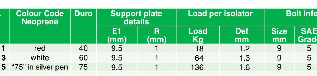

glenT300 Posted May 24, 2021 Author Share Posted May 24, 2021 So contacted Mackay Rubber and they have something similar but in soft, medium or hard. Which would you all recommend? I was leaning toward the medium. They have a weight capability chart but not sure whether I need to allow for engine torque? Link to comment Share on other sites More sharing options...
Thruster88 Posted May 24, 2021 Share Posted May 24, 2021 I would go the medium. Propeller flange torque on a 582 is around 210nm or 2kg on a 1 metre long stick. Link to comment Share on other sites More sharing options...
glenT300 Posted May 24, 2021 Author Share Posted May 24, 2021 Awesome. Thanks for that. I appreciate the conformation. Medium it is! Link to comment Share on other sites More sharing options...
