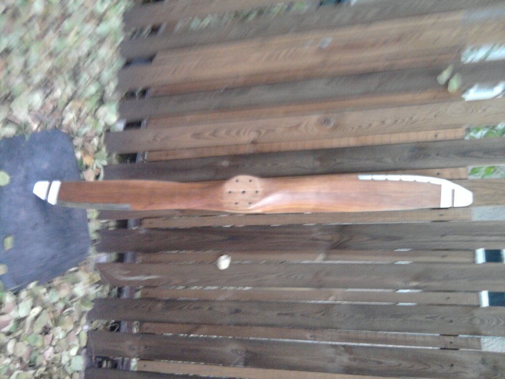

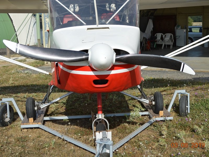

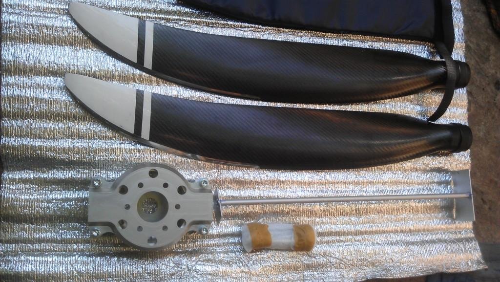

I agree with you. We have successfully used wooden propellers with a diameter of up to 68" on non-high-speed aircraft. We have also developed and use especially strong carbon fiber blades, the propeller diameter is 1620 mm = 63.8". They have been in operation for more than five years. Unfortunately, none of the engines that work with us has worked out the assigned resource.
