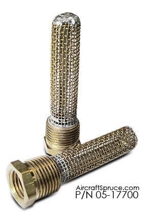

Thruster88 Posted May 31, 2021 Share Posted May 31, 2021 Another difference I see between certified and RAAus type aircraft is fuel tank finger strainers. Certified aircraft always have them and we check some depending on the system of maintenance. I fitted one to the thruster many years ago after a piece of my farm machinery suffered a blockage at the fuel outlet. In the case of the tecnam the blockage was not at the fuel tank but may have originated from a tank. 5 2 Link to comment Share on other sites More sharing options...
KRviator Posted May 31, 2021 Share Posted May 31, 2021 The RVs have an even simpler one, a piece of standard fuel tubing. Bent to sit a bees d!ck off the bottom of the tank, a flared fitting on one end, squashed flat at the other, with a series of thin hacksaw cuts partway through it. I couldn't imagine anyone flying without something to catch the bigger contaminants before they reach (and/or) block the filter. 1 1 Link to comment Share on other sites More sharing options...

facthunter Posted May 31, 2021 Share Posted May 31, 2021 A primary finger filter is in even a tractor. Your fuel caps aren't usually locked when you overnight in the open either. You can buy various grades of brass mesh to make your own filter. If it's fine you look at it more often. Nev Link to comment Share on other sites More sharing options...

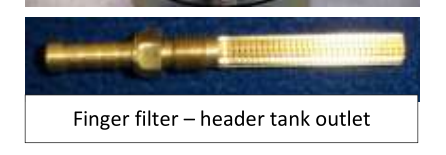

RFguy Posted May 31, 2021 Share Posted May 31, 2021 I fill using the dual filter funnel, and very careful that the funnel itself is super clean. Ya know when working on water pressure sensors in dams and ponds, the tiny breather holes got filled up with tiny snails. Howover, I will retrofit the Jabiru with some sort of broad mesh as to catch whatever could clog down stream. ideally, meshes need to be progressively finer as to prevent a single orifice blockage soemwhere down stream. 1 Link to comment Share on other sites More sharing options...
Old Koreelah Posted June 1, 2021 Share Posted June 1, 2021 56 minutes ago, RFguy said: ... I will retrofit the Jabiru with some sort of broad mesh as to catch whatever could clog down stream. ideally, meshes need to be progressively finer as to prevent a single orifice blockage soemwhere down stream. I thought they were standard in Jabs. I fitted a pair of finger filters (like those in T88’s post) taken from a Jab kit. Link to comment Share on other sites More sharing options...
Jaba-who Posted June 1, 2021 Share Posted June 1, 2021 5 hours ago, RFguy said: I fill using the dual filter funnel, and very careful that the funnel itself is super clean. Ya know when working on water pressure sensors in dams and ponds, the tiny breather holes got filled up with tiny snails. Howover, I will retrofit the Jabiru with some sort of broad mesh as to catch whatever could clog down stream. ideally, meshes need to be progressively finer as to prevent a single orifice blockage soemwhere down stream. Finger strainers are standard in Jabs 1 1 Link to comment Share on other sites More sharing options...
RFguy Posted June 1, 2021 Share Posted June 1, 2021 (edited) And there is it- it's behind the header-tank outlet barb. so that's where it is. Despite my Jabiru company related engine troubles, I will be sticking with the airframe. Edited June 1, 2021 by RFguy Link to comment Share on other sites More sharing options...
Jaba-who Posted June 1, 2021 Share Posted June 1, 2021 2 hours ago, RFguy said: And there is it- it's behind the header-tank outlet barb. so that's where it is. Despite my Jabiru company related engine troubles, I will be sticking with the airframe. There are also similar ones in the main wing tank outlets. At least in mine which is a 2006 model J430. I remember installing them in the tanks when I built it. So all up there’s at least three. 1 Link to comment Share on other sites More sharing options...
