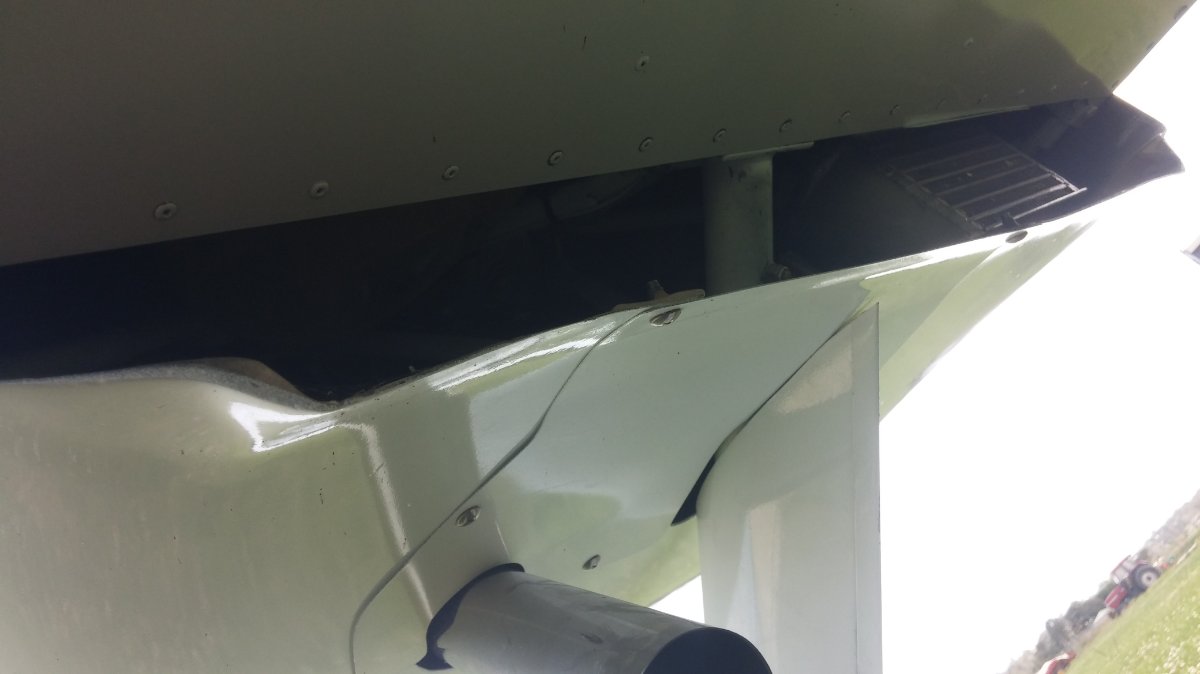

kgwilson Posted June 10, 2021 Share Posted June 10, 2021 Different aircraft of course and I built it and I also wanted to ensure that there were as few areas for the engine bay air to escape except through the bottom via the suction created by the wide lip on the cowl bottom. Jabiru produced a lower cowl lip kit for some models back around 2010/11 which was a glass shaped lip that you epoxied on to the exhaust area of the lower cowl to assist with cooling by generating suction. See the plate I remove in the photo below. 1 Link to comment Share on other sites More sharing options...
