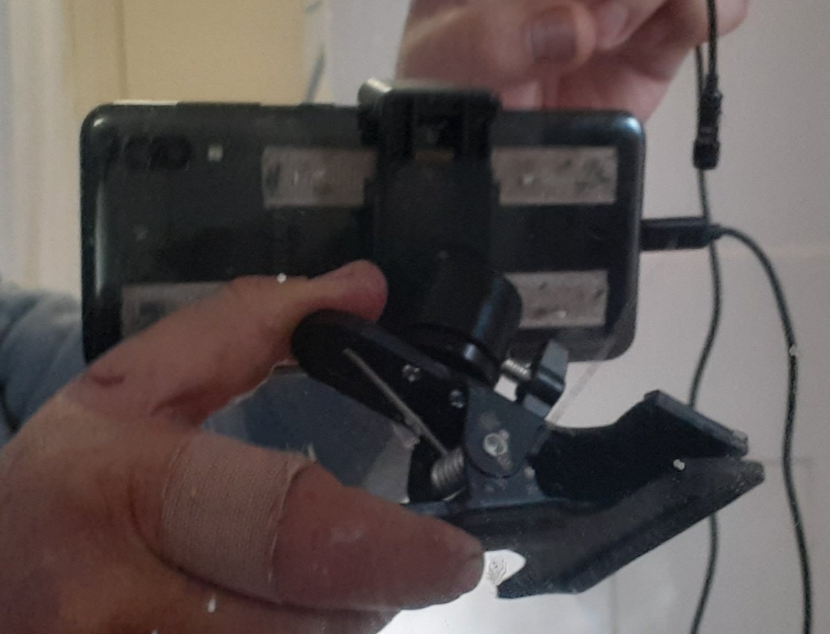

This is my solution a cheap ass clamp and a cheap ass lapel microphone which plugs in my Samsung phone. No extra gear, microphone sits in the headset earcup. High Definition video and with a 32GB memory card which will record long enough to send even the most interested aviator to sleep. The video is such good quality I can just chop high def photos straight from the video (see below). Less than $30.

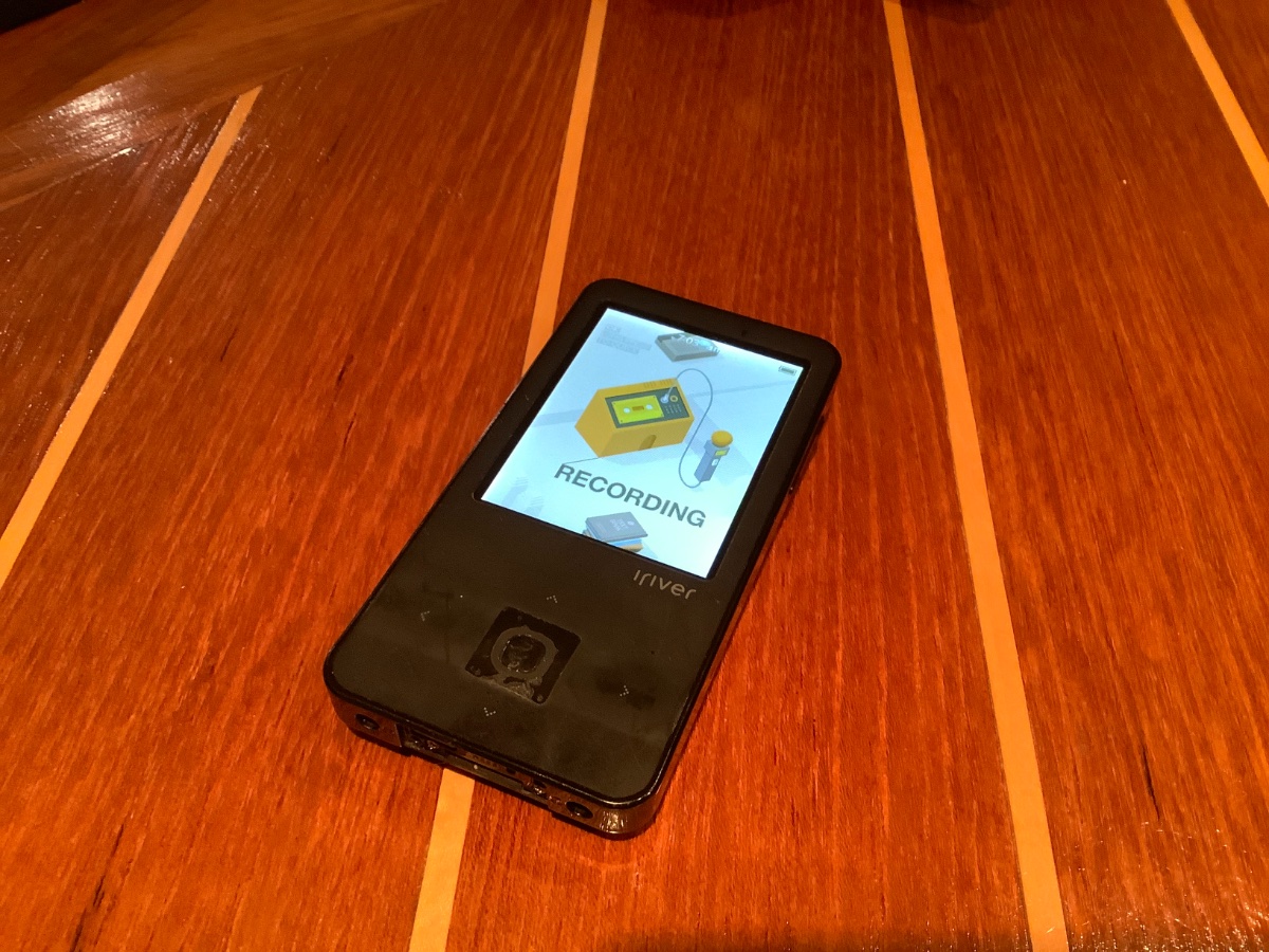

I use
Lightspeed Zulu 2 headsets
Garmin gtr 200 radio
A digital audio recorder (iRiver brand?) bought from JB hifi a long time ago
A 1 to 2 splitter. Where my headset plugs in that taps off to the audio recorder plugged into ...
The line in socket of the audio recorder with the input volume in the recorder turned down as low as it will go.
I was just lucky that the recorder doesn't have AGC (as I mentioned in my earlier post) on the line in input.
BTW, I see you're location is listed as Wolongong, so here's another video for you...
https://youtu.be/RgKlpDKuoC0
Just to clarify, you attach the recorder through line in - to your splitter from the audio jack in the intercom, and not directly into your headset. Is this correct? And if that's the case, the magic lies in your recorder and setting the input volume to the minimum with no AGC. Thank you so much. You have been so helpful!
Edited by anjum_jabiru
Yes, that is correct.
Here's a pic of my recorder.
