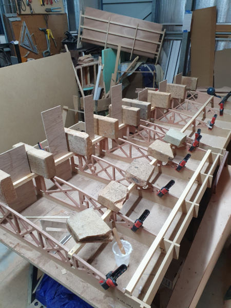

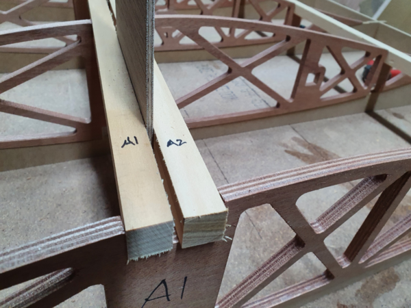

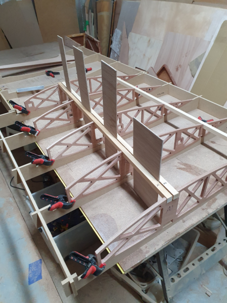

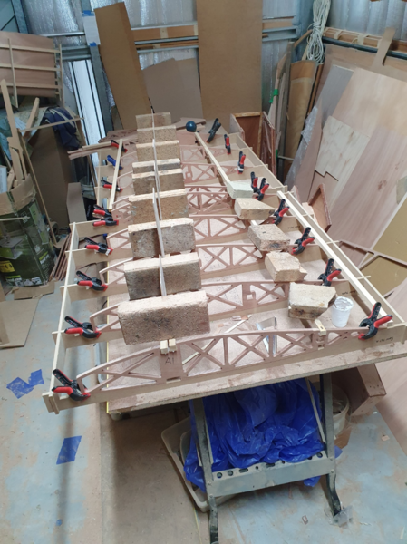

duncan_rtfm Posted July 7, 2021 Author Share Posted July 7, 2021 After a rather disastrous laptop infection by a virus which encrypted every file on my backup drive (thank goodness it wasn't my C drive) I finally found time to get back into the workshop and progress my wing. My wings are constructed in three panels on each side. Each panel hinges. Panel A is fixed, Panel B hinges upwards, and panels C/D hinges downwards, allowing the entire rear wing (5.75m span) to fold into a 2m wide "concertina" This is Panel A. Each rib sits in a cradle, ensuring there is no twist, the ribs are perfectly spaced and sit at 90 deg. The main spar consists of two 19mm x 19mm Hoop Pine spar caps, with a 4mm gap between them. This is to allow space for the (discontinuous) shear webs to be bonded in place between them. I know this is somewhat unusual - to have a discontinuous shear web - but I've had the numbers crunched, and the 9mm gap between each shear web segment is fine. Here's a close-up of the spar caps. Using West System with some adhesive filler, I bonded the spars in place on both panel A and panel B. Once satisfied that everything was true, and that every rib was at 90 deg, I weighed the spar caps down with my trusty bricks. By tomorrow morning, I should be able to flip the two panels, and bond the bottom spar caps in place. If I get an early start (and if it's not too cold) I might be able to start sanding the spar caps to the contours of the ribs. Regards, Duncan 2 Link to comment Share on other sites More sharing options...
