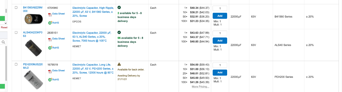

Glenn is correct always try to get the 105deg versions but they are hard to come by...mostly are 85deg
I just looked at Element 14 and they have some in stock...well not here but a week or so away in their stock overseas  Element14 order code  2835151
346516195_ScreenShot2021-08-04at6_00_41pm.thumb.png.fed2af2fd1fe20dc7ae22de3988bf016.png
Thanks guys - I'm in the checkout at Element 14 now - while I have free delivery (the mounting bracket tipped it over $50) - is there anything else I should be getting at this point in time?

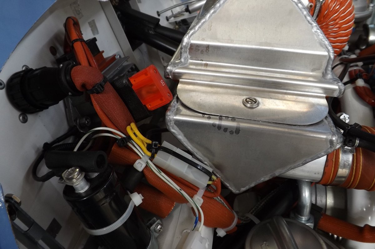

So how is the capacitor wired to the regulator?
Thanks for your patience guys - I am a total newbie when it comes to electrical stuff.  Making wing ribs is child's play compared to this.
The battery + goes to one terminal of the starter solenoid. That's the fat red cable.
The output of the voltage regulator (B on the regulator) that keeps the battery charged goes to the the same terminal on the starter solenoid.
Make up a short cable with lugs on the ends, and connect the + side of the capacitor to that same terminal on the starter solenoid.
Make up another short cable with lugs and connect the - side of the capacitor to your negative bus point.
The usual place for the capacitor in the Sav is at the RH end of the front shelf that carries the throttle bar etc. Best wait until you have the throttle bar etc in place, on the Sav there's not much room there.

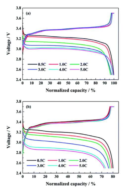

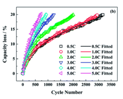

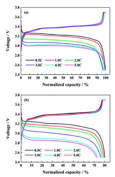

Well, I looked up a few papers on the subject of max discharge rate for of LIFEPO4, selected the best graphs.
Now remember this is CYCLE LIFE - But we dont cycle these batteries (charge- deep discharge etc) . Use of these is more like useful for NiCd or PbSO4.
you can see at 4C, you are down to 750 cycles. You are NEVER going to do that in your aircraft. so dont worry.
here is some data on how the batteries look at discharge time- top one, FRESH, bottom one- at capacity loss of 20% (per first graph).
The 4C and 5C discharge curves show significant drop once the battery is aged by the hard work at 4C and 5C
(it is still much better than a new lead acid battery !)
Edited by RFguy
