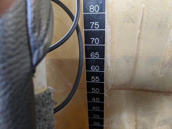

shajen Posted August 11, 2021 Share Posted August 11, 2021 Interested in what ideas are being used to read the fuel level in an 85 litre tank behind the seats. I find its easy enough to read down to about 45 l, then it gets too difficult to see easily. i dont want to be adding electrics or dials on the dash, just a simple manual way of reading it. Also dont want to be removing tank to add sensors etc. Link to comment Share on other sites More sharing options...
coljones Posted August 12, 2021 Share Posted August 12, 2021 Yes, a pain in the bum. I have taken to using my phone to take a picture at startup, every half hour and at shutdown. Makes a good fuel log as well. Not sure about the last 5 litres but the last 10 is my reserve in a J120. 2 Link to comment Share on other sites More sharing options...

coljones Posted August 12, 2021 Share Posted August 12, 2021 Backhanded photoshoot on mobile phone. 1 Link to comment Share on other sites More sharing options...
