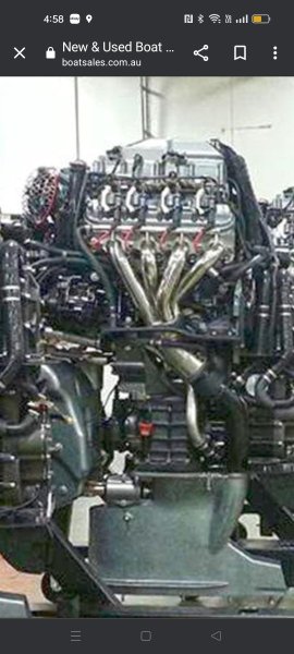

Raw water cooling in outboards makes sense because it's simple and lightweight.  If you google seven marine, which were large HP outboards using ls chev engines making around 5 or 600 hp from memory. They utilise a closed circuit freshwater cooling system so it can be done .

Got no idea why you bring up MerCruiser stern drives. I was talking about SEVEN MARINES closed loop cooling on an outboard engine. I know almost  every diesel on the market and many stern drives are closed loop cooling.
The last model was 627 hp before Volvo Penta took them over and shut down production.
These large outboards were designed for American boat manufacturers to cut down costs. When they use inboard engines the engine is sitting in the hull for weeks before it finished and sold. Outboards don't have to be purchased by the builder until the boat is sold.
